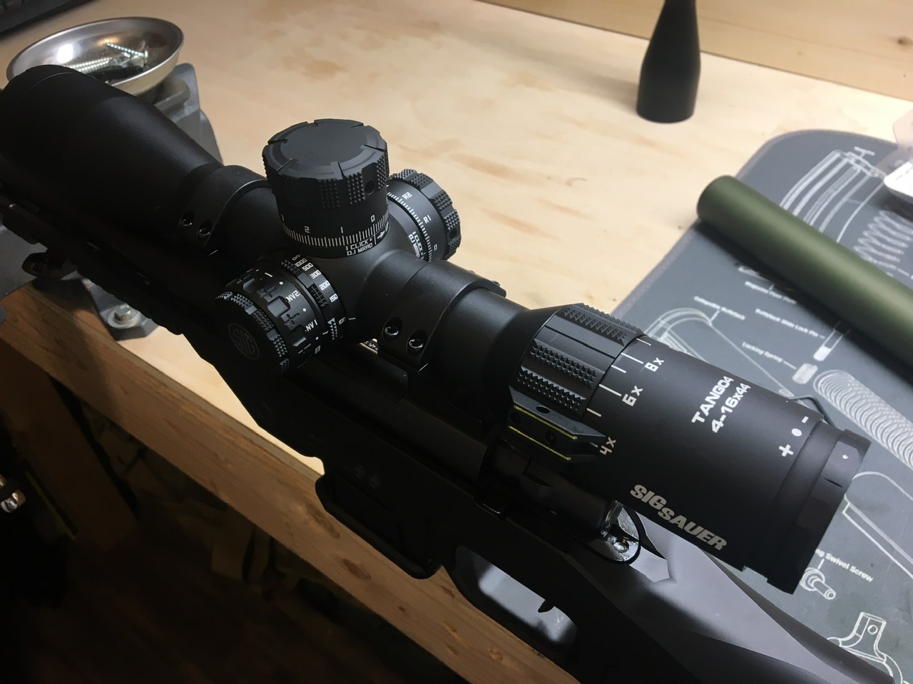

Does anybody else have one of these? I looked around for a few weeks for a decent semi lightweight scope to put on a 6.5 grendel bolt action hunting rifle and found a really good deal on one of these.
Sig’s website says it weighs a hair over 20oz and has a zero stop as well as a “zero lock”.
Well I bought it and after getting it in it weighs right at 26oz on my scales, and does have a zero stop but no zero lock. Both of those are aggravating but I can probably live with it.
The bigger question I have if anybody else has one is how many Mils of windage does yours have? Sig says it has 26 Mils of elevation and mine has 27. They say it has 23 Mils of windage but unless I’m doing something wrong I’m only getting 12 Mils of total travel in the windage turret.
Here’s a link to sig’s website page for this scope. If you look at the models available it shows the 20oz weight and the windage and elevation travel. Mine is the Mil ranging model.

If you max out the windage, loosen the set screws on the cap and recenter it, tighten screws.
The windage only has so much travel on the knob, but the turret does have more.
