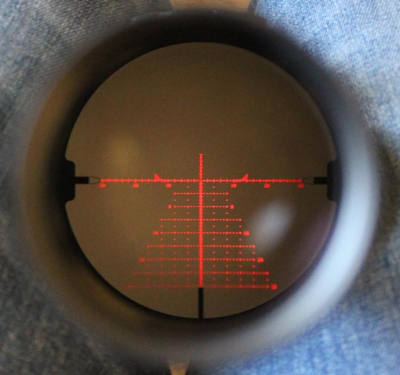

I purchased a Sig Tango 6 last month and as soon as I took it out of the package and turned the reticle on, I noticed that the lower left side of the reticle wasn't quite right. I took it out and sighted in the scope and yea, the illumination wasn't so illuminated on that corner. I called Sig and they gave me an RMA to send it back in. After having the scope for a week they sent it back and this was their response: "Unit was powered on and reticle inspected for illumination issues, no trouble found, sending unit back. Note: Illumination in lower left quadrant is slightly faded, this is unavoidable due to the way that the reticle is illuminated".
This is the first time I've seen anything like this. Does anyone else notice this with their sig scope or any scope for that matter? @gr8fuldoug have you seen this in any of other scopes you've sold? I checked all three of my Tango 4's and they are definitely not like the reticle shown above. This is the first scope that I've spent this kind of money on and to be honest, I'm not happy. I would consider this my first and only "higher" end scope. I'm just curious how common this is? What do you guys think?
So does no one have an opinion on this? I'm just wondering if you guys find this acceptable? Is this par for the course? Should I contact cameraland and see what they think?
So just an update, Doug at Camera Land has been awesome to deal with. He contacted sig and got me another RMA. He said that the scope will either be fixed or replaced. Now it’s in Sigs court, let’s see what happens on the second try. Scope was sent in today.

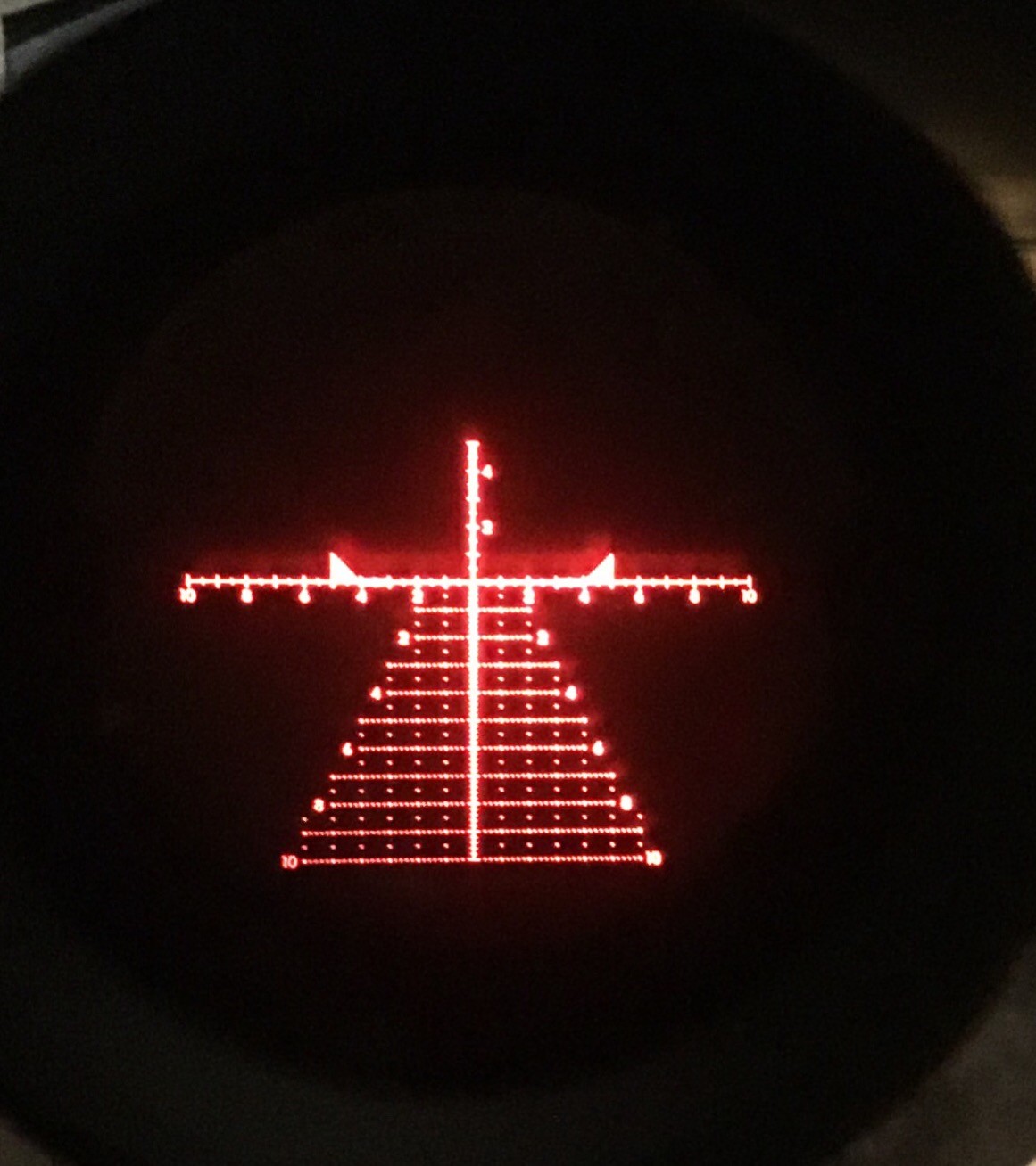

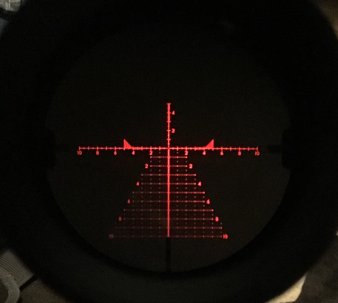

I had never noticed this issue in mine, but it does appear I have a similar fade out in the lower left at lower intensity levels. It’s not as pronounced on the higher settings. Sorry for poor picture quality, that’s the best I could get with my iPad camera.43D20C93-FADA-43D4-ACA9-ACFF9B35FD82.jpeg50085432-3BAD-4118-AB16-CB602876C250.jpeg
Reactions: tomcatfan
