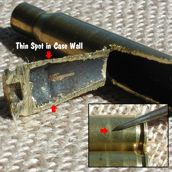

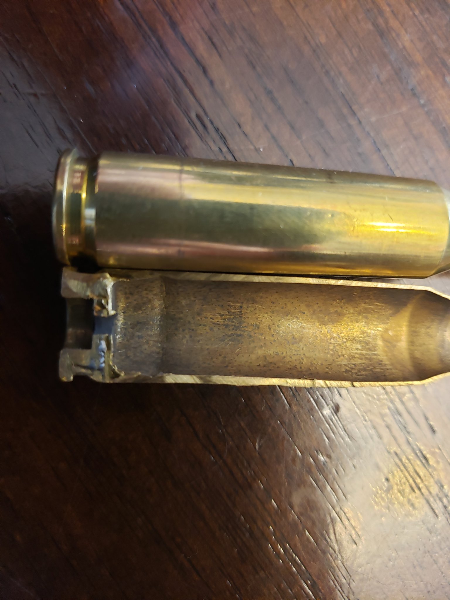

If you really wanna know 100%, cut that case open. You'll know 100% with zero doubt. People talk about the paperclip method, but why? It's very easy to miss what you should be feeling with that method, whereas cutting a case open reveals all you need to know.
I do this exact thing too. When in doubt cut one in question open. Another fact is the rub ring from being in an ammo box upside down will rub off with polish, a ring of death will not.

We're the determining factor when it comes to reloading. We're in control of what we're doing and usually have the ability to answer our own concerns literally right at our fingertips. Incipient Case Head Separation can be dangerous shit. If you think a mark on your brass is suspicious, stop guessing what it 'might' be. Cut one open and WHAMMO, your definitive answer is right there, no questions asked.

I could never quite get the feel of the paperclip test. Instead I shine a little keychain sized maglite down the case, which makes a very distinct shadow where the case is thinning.

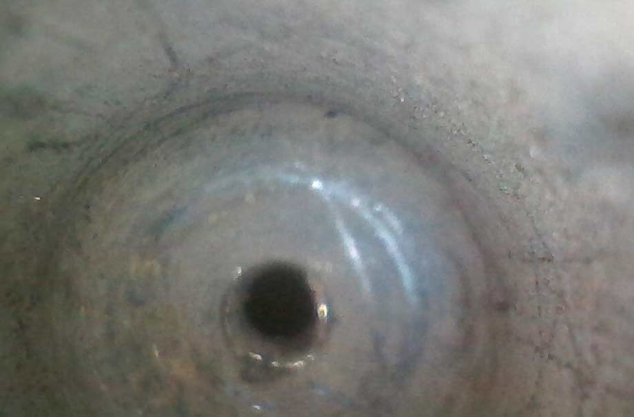

I tried a borescope, but the light on the scope washes out the groove too much to see easily.
What i see on the O.Ps case does not look like the beginning of CHS. Its just looks like normal fired brass. I would not cut up some Lapua brass 1x that looked like that. Most of the time CHS is from shoulder movement and not loading hot. You can load way too hot and blow the case off or have a big fat chamber at the base overworking the brass. But most of the time what we are looking at in CHS is thinning somewhere in the brass from the shoulder moving forward and back over and over.
