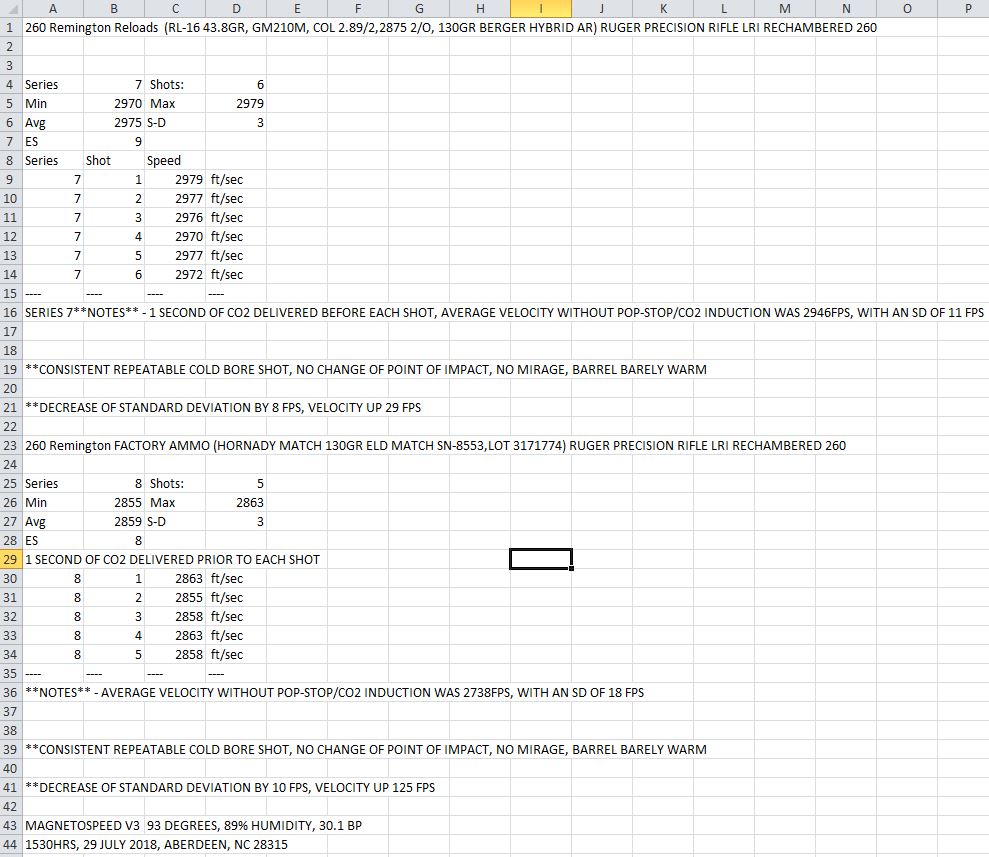

Got some results back today from a a former SF sniper we sent a 5/8-24 PopStop to for evaluation. For those unfamiliar, the PopStop was conceived as a method for eliminating First Round Pop and First Round Flash. The device itself is a machined titanium interface between muzzle and silencer with an external valve allowing for injection of CO2. We've received independant results from Bill Arevelo showing significant sound reduction when he tested it using his array of 2209s. However, we did not anticipate such significant reduction in velocity SD and increase in overall velocity with precision rifles.
Results can be seen here:
Here are the shooter's notes:
I honestly thought that something was wrong when I started testing this. While using the pop-stop on a suppressed rifle, it performed phenomenally. It was stupid quiet. This weekend I rehashed the data, and pulled this chart from my Magneto-speed Chronograph (Version3). Both my shooting partner and I had the same consistent results… Lower standard deviations of muzzle velocities, higher feet per second velocities, cooler barrels, no mirage—even when using a suppressor. I ran reloads as well as factory ammunition. The data is attached, with all pertinent info. This is a HUGE find and needs to be advertised. Running the POP-STOP with an extension line to my rifle and using it between shots cools your barrel enough to make your cold bore shot repeatable. All groups were under an inch/SUB-MOA, and it was tested with a Silencer-co Harvester Can which after shooting, I could remove without gloves. I have to get a sturdier extension line, probably steel braided on the outside, but the concept is there, as is the data. Now, please make a pop-stop that is bored out for 458 SOCOM!!

Very helpful, thank you. You are reading the results correctly. It would appear from this data, velocity deviation is reduced as a result of creating a relatively pure and consistent CO2 atmosphere in the can which is accomplished by purging before every shot is taken. However, just as the subsequent shot is typically quieter than the first (traditional FRP without using this device) as a result of the lack of oxygen in the can, it can be posited that the propellant gas remaining in the can could act in a similar fashion as the pure CO2 environment - less turbulence, and therefore less velocity deviation. This is something I will check today.

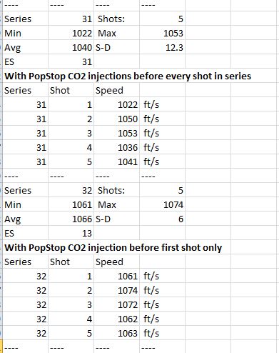

More data this time using one of our test guns (18" savage action in chassis w/ Q Full Nelson silencer) with our commercial 308Win subsonic in Lapua brass from same sleeve/lot # etc. Magnetospeed V3 chrono
At least from this small sample it appears that a single injection of CO2 before the series of 5 results in smaller SD than injections before every shot. Maybe it has something to do with the cooling factor of the CO2 injections. I'll have to get my thermals on it for the next test...
