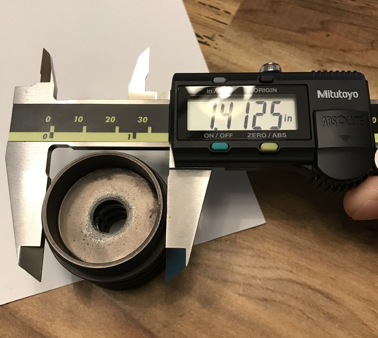

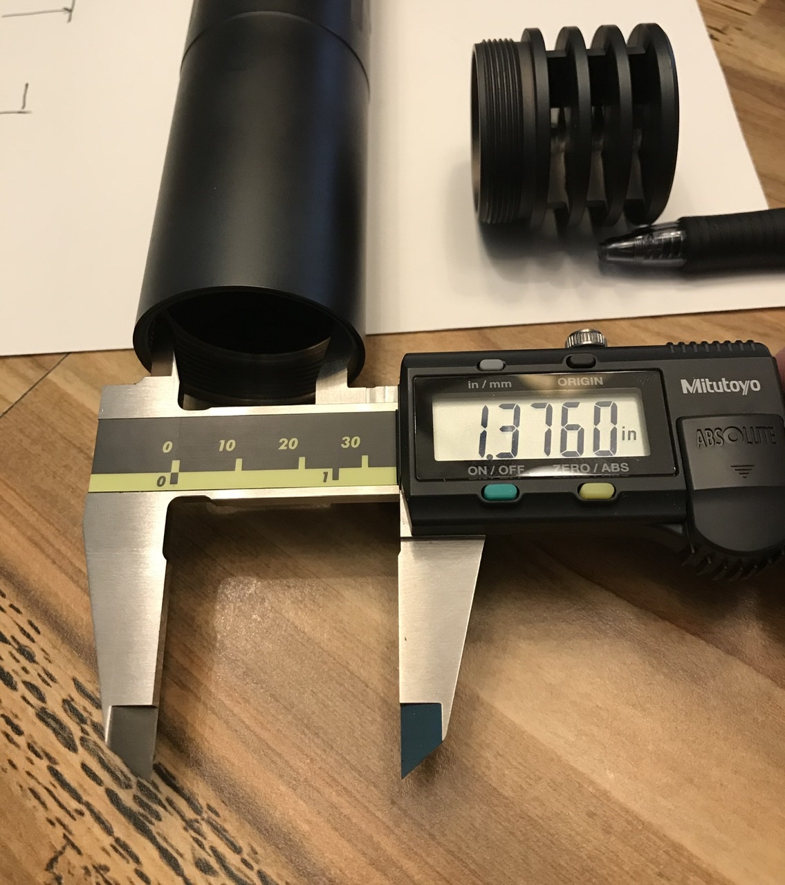

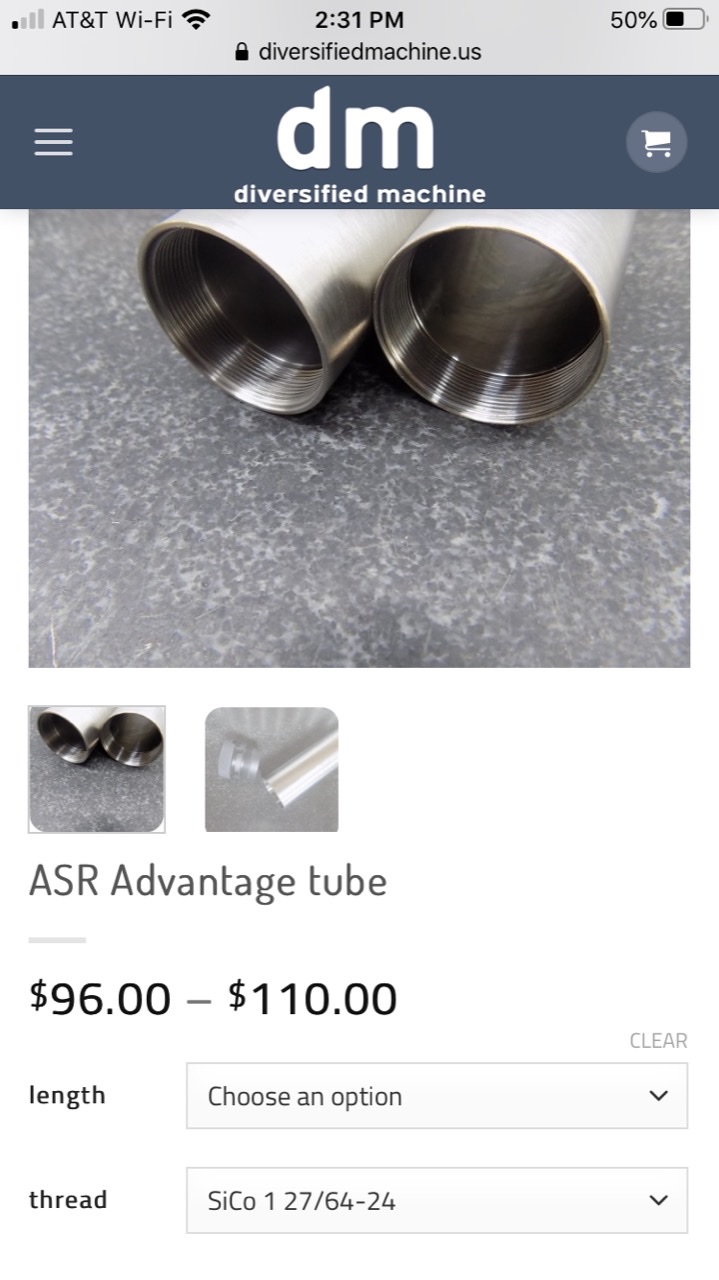

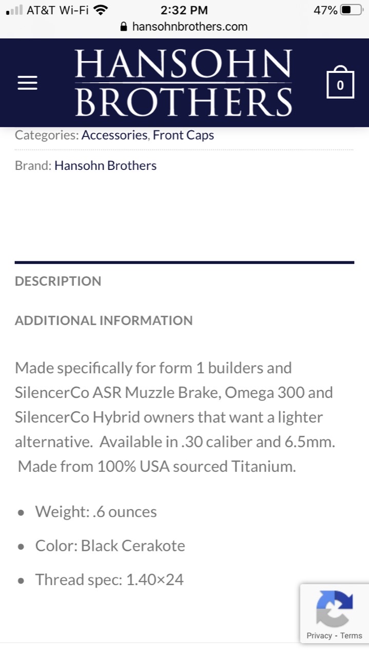

    @HansohnBrothers says 1.40x24, but that doesn’t make sense to me because the physical major diameter is 1.4125” and the physical minor diameter on the female portion of the suppressor is 1.376”. Another company that sells solvent trap kits says 1 27/64x24, which seems closer, but that would put the major diameter at 1.422”

    On the measurements I just took, I have 1.400 on the minor and 1.4175 for the major, thread pitch is definitely 24tpi.

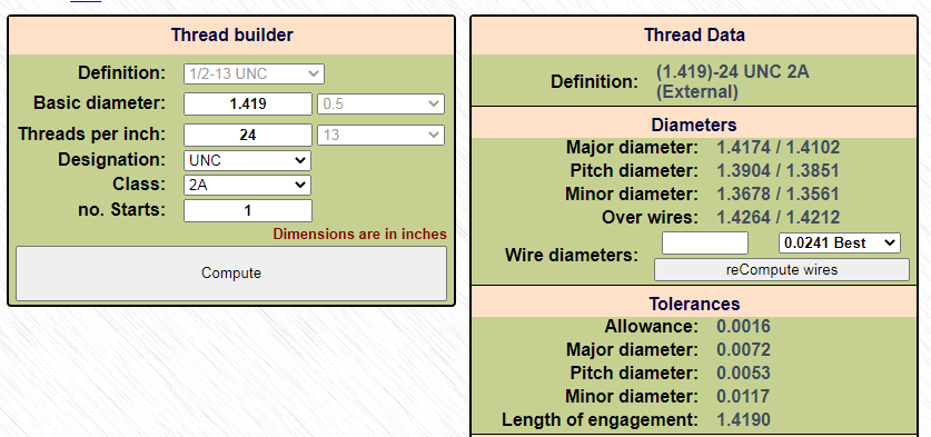

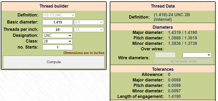

    Came across http://theoreticalmachinist.com/ which has a thread calculator. If I input 1.419x24-2A it aligns fairly well with the measurements I'm seeing online, assuming it's dead in the middle of the tolerance range. It looks like 1 27/64 x24 (1 27/64 = 1.422") is probably it.
    External Threads (Anchor brake measures 1.412" major diameter):
    Internal Threads (my Omega measures 1.376" minor diameter):
    @HansohnBrothers site now says:
    • Thread spec: 1.420×24 UN
