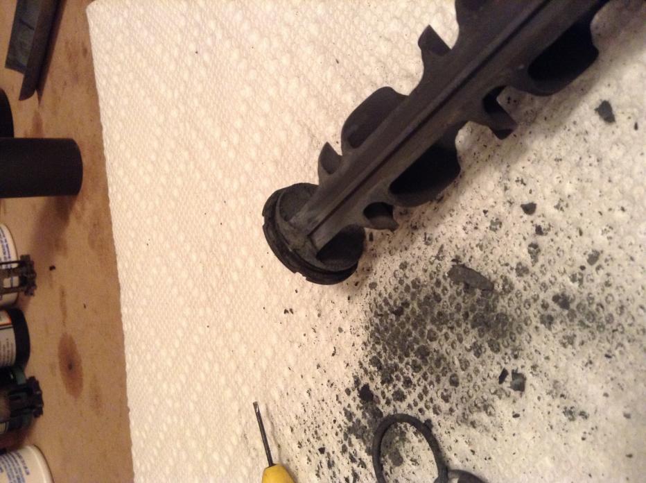

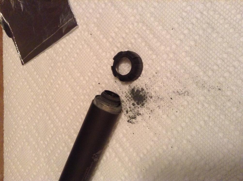

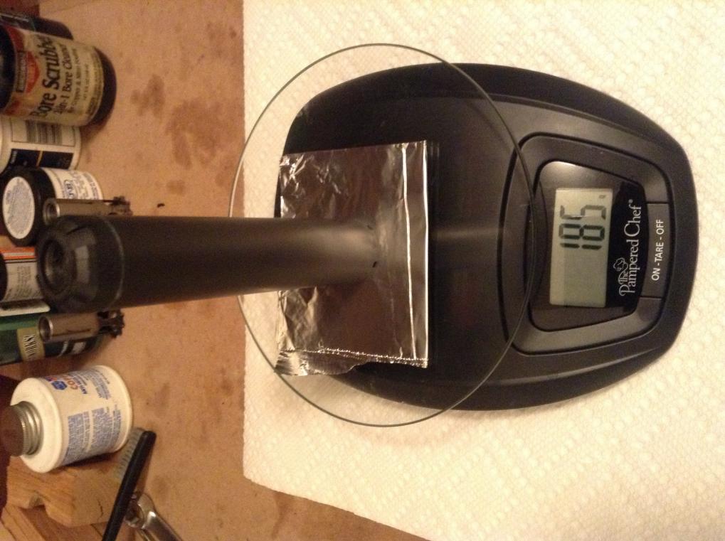

2500 rounds since the last time it was cleaned
Mostly federal bulk and some Winchester HV
On a M&P 15-22
After cleaning lost 10 grams of lead/carbon
Did it give you any trouble coming apart? That thing looks nasty, but in a good kind of way. :p Hopefully the tax stamp for my Sparrow will be in by July along with the stamp for my SBR. :cool:

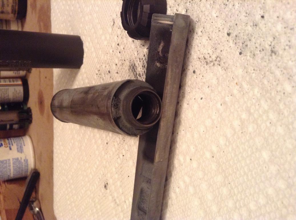

Your clamshells don't seem to have leaded up nearly as much as mine. Perhaps there is something to be said for plated ammo? Mine has seen mostly CCI Standard Velocity through a 4.5" Tac Sol barrel. 2k rounds in one camp weekend and it was almost sealed shut. Heavy leading on the clamshells, which is about impossible to clean off.

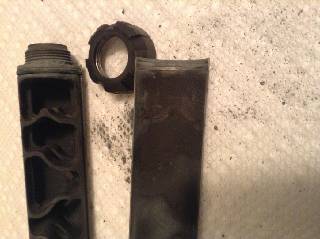

Made this to scrape the inside of the SS Sparrow clam shell.
Gets everything off. Lead and all.
Don't know how aggressive you could get on the aluminum version.

It's probably because his host is a rifle and yours is a pistol. My sparrow gets dirty much faster on my pistol compared to my rifle.
Mine has looked the same at one point. Came apart very easily but would not reassemble without cleaning. Cleaning took a while but the sonic cleaner helped with the SS parts. The more I use this can the more impressed I am with it. It takes the abuse in stride. I am 100% satisfied with sparrow.

the federal bulk i was shooting is copper plated i think that is the reason it hadn't seized up

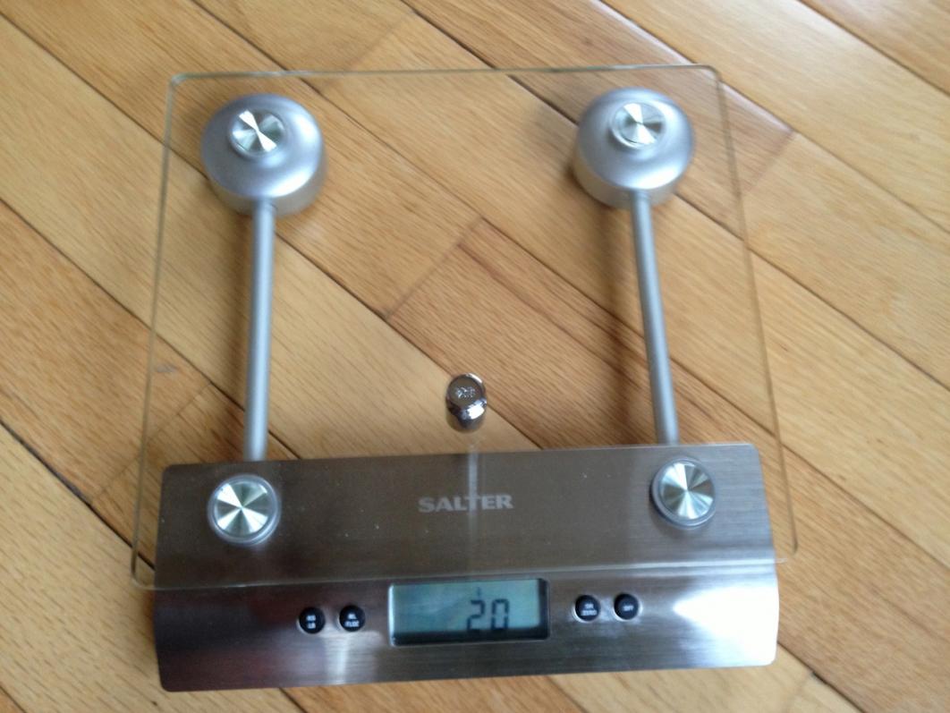

the internal parts are sitting in a dip solution right now when they get done i will reassemble and re-weigh
the can i don't expect a huge weight difference but i'm sure it will be a few grams

Question

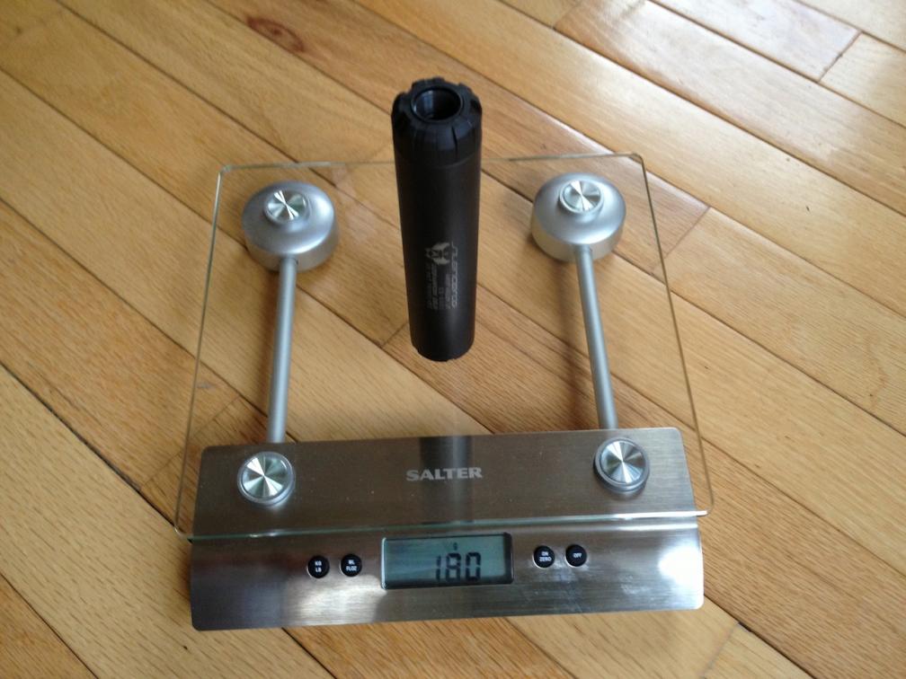

1Shot, just curious is that 185g photo after your 2500 rounds? Here's my Brand new Sparrow, picked up yesterday and it weighs-in unfired at 180g (6.35OZ) just under Silencerco's spec weight of 6.5OZ.
