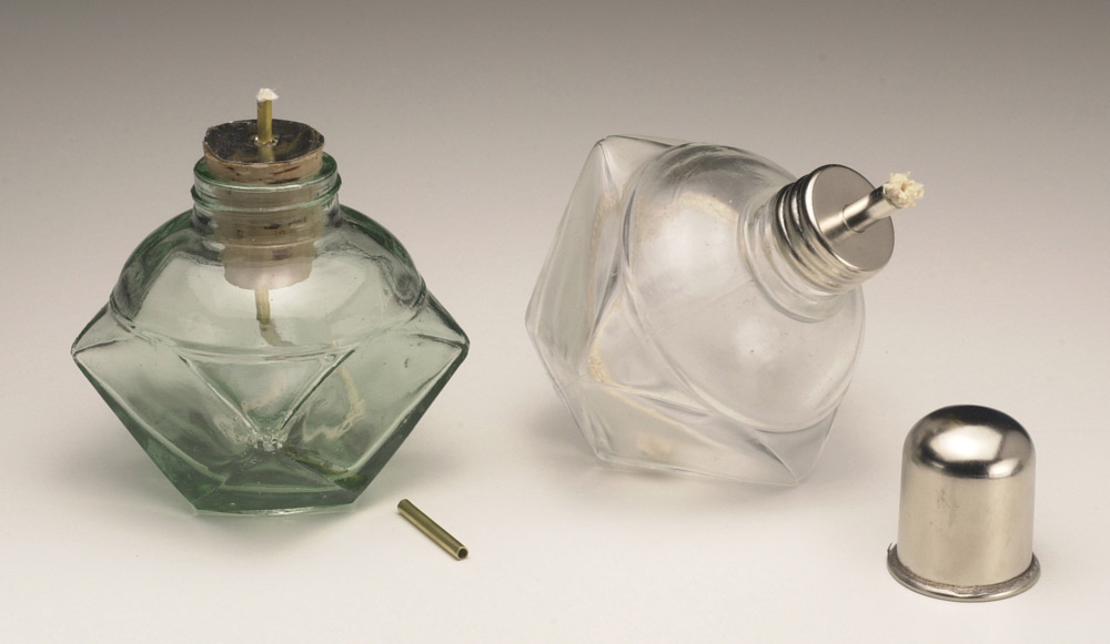

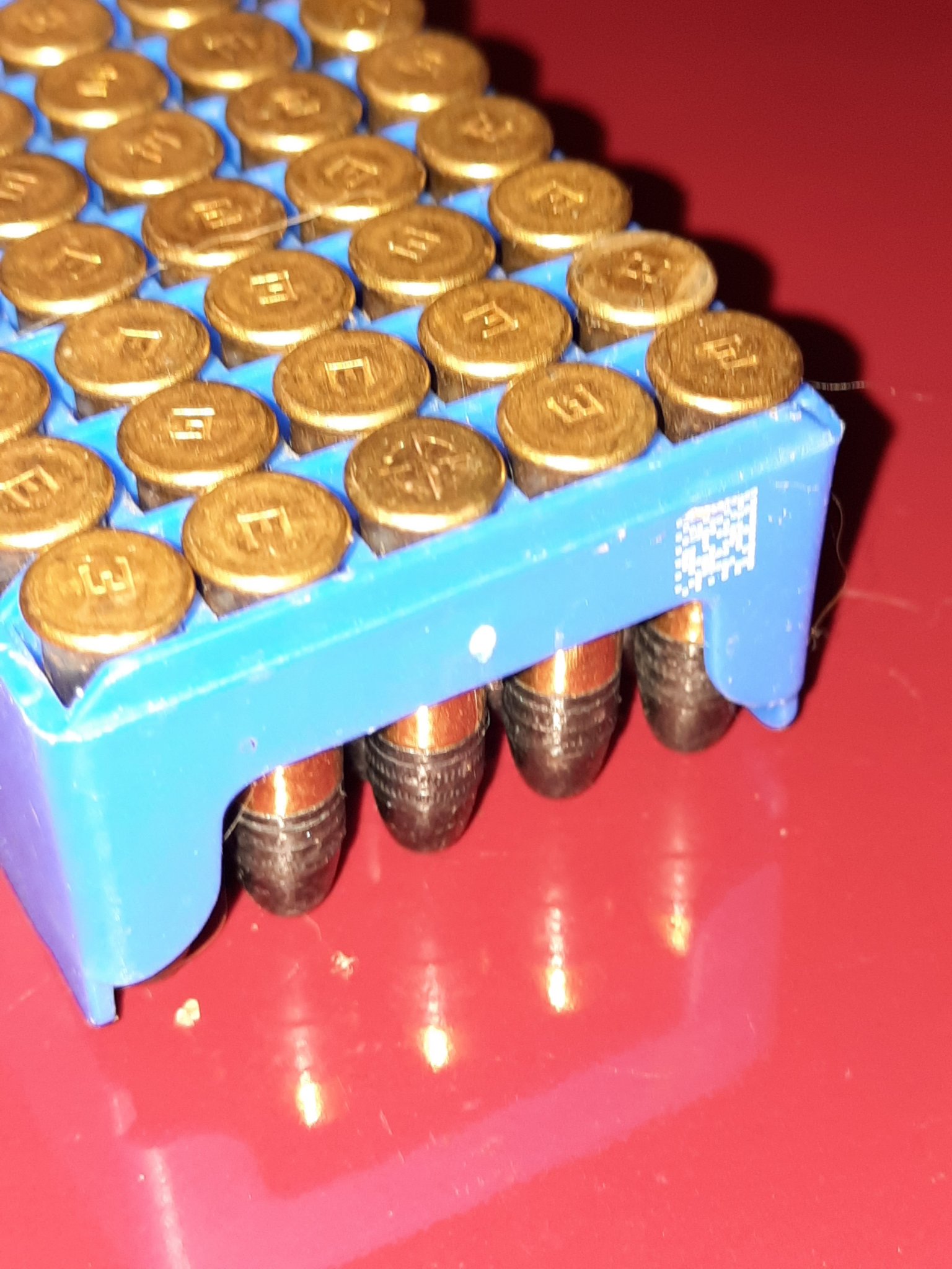

If I were to lube my bullets, I would use the handy bullet carrier that is provided with any good grade of ammo as shown
in the attachment. I think of it as the candle making approach. Nose down and 50 at a time. I may even pre warm the lead
so the wax skin would be held to a minimum.
The plate or other container contains the lube. Certainly you could keep the lube melted with Sterno or back packing stove
or alcohol burner / lamp from your sixth grade science class. Even a double boiler if your into cooking.
All it takes is 75* to 180* to melt wax depending on type.

I hadn’t picked up on the date of this thread either, but can relay some of the info I gleaned from a gents tests about 2 decades ago on RFC:
1. A chemist type fellow weighed in that silicone when superheated became an acid.
2. Another gent did some exhaustive tests and claimed he got best results with bullets treated with....
Wait for it....
Preparation-H
Obviously jokes and puns ensued, but other folks claimed to test it and said he was right.
I have discussed this with a friend who has experimented with imperial die wax, as well as Hornady case lube/One-Shot, he noted an improvement on cheap ammo, but felt the application could be more uniform.
I still wonder about other potential “lubes” such as moly grease and anything with a chap-stick like consistency that doesn’t attack barrel steel.
