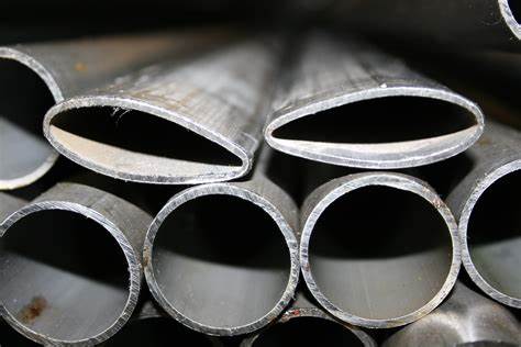

    The last time I got any welding rod, about 2003, I bought it from Lancaster Alloys in California. I was welding 70 sets of landing gear
    for our hang glider club and the local copper coated stuff just wasn't working. The MC rod I bought was just over $30.00 / pound but
    welded beautifully. The airfoil shaped 4130 had to be connected to round and it was on about a 45* angle. That meant I had a fair
    amount of mill time into each set. Virtually anyone else would have been happy with the local rod but I'm not that guy.
    I don't view it as being different than people wanting a Vudoo because the company has paid attention to virtually every detail.
