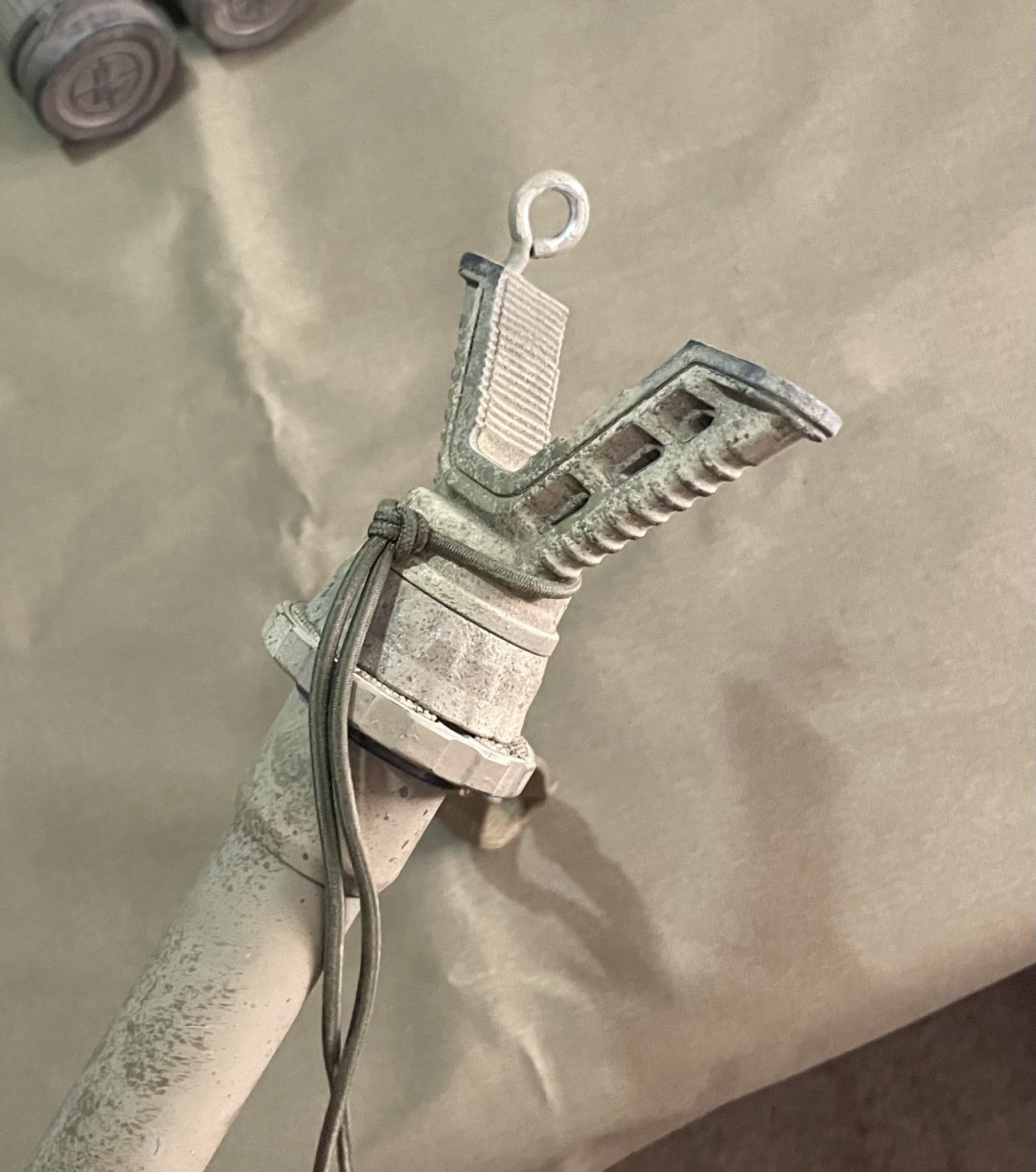

So, with the intent to do more things with less things, I came up with this little hack to use binos on one of my monopods without having to use a seperate attachment.

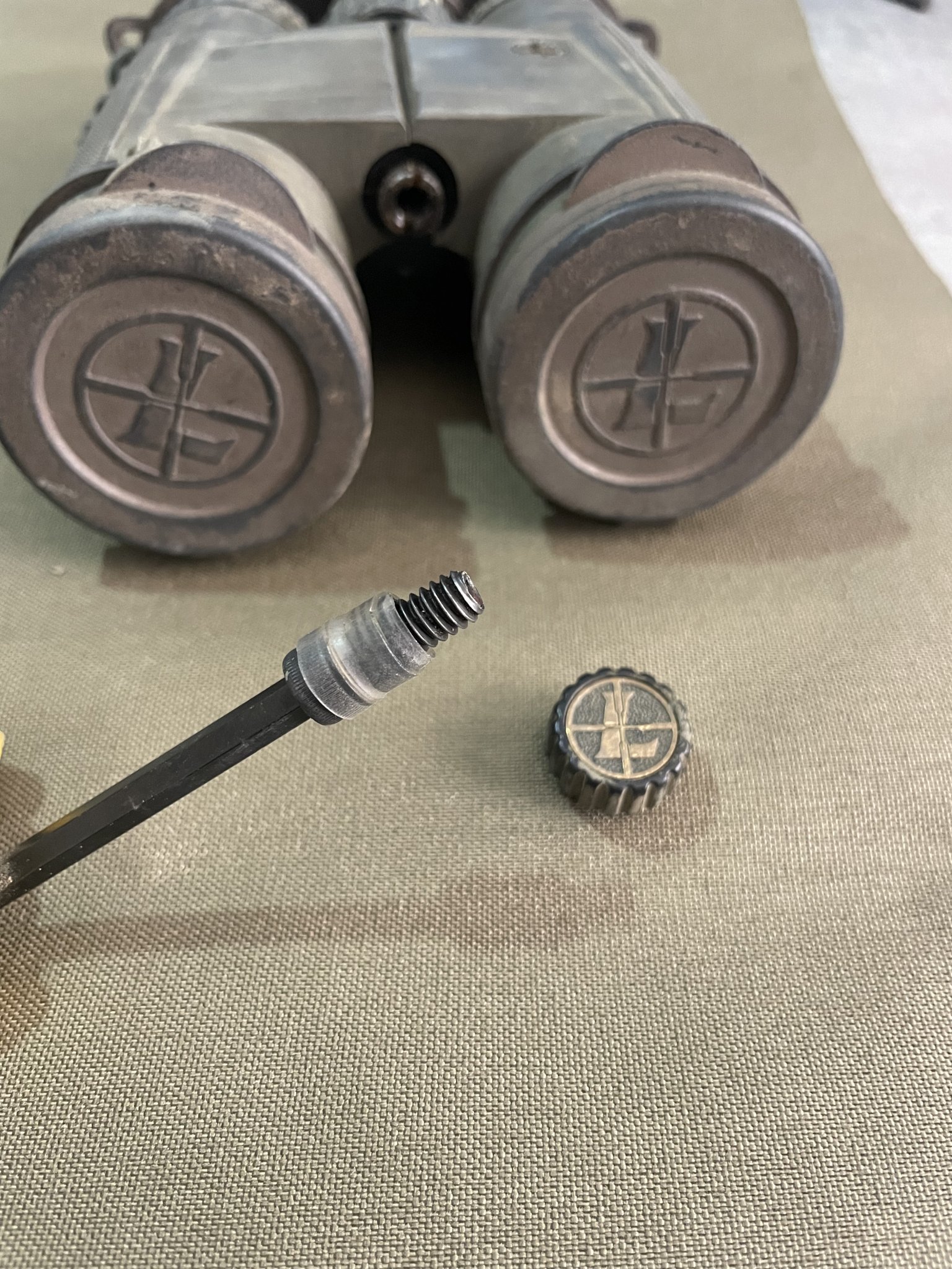

First, remove the front cap exposing the threaded hole. Take a 1” 1/4x20 screw and thread it in. I put heat shrink on the exposed threads.

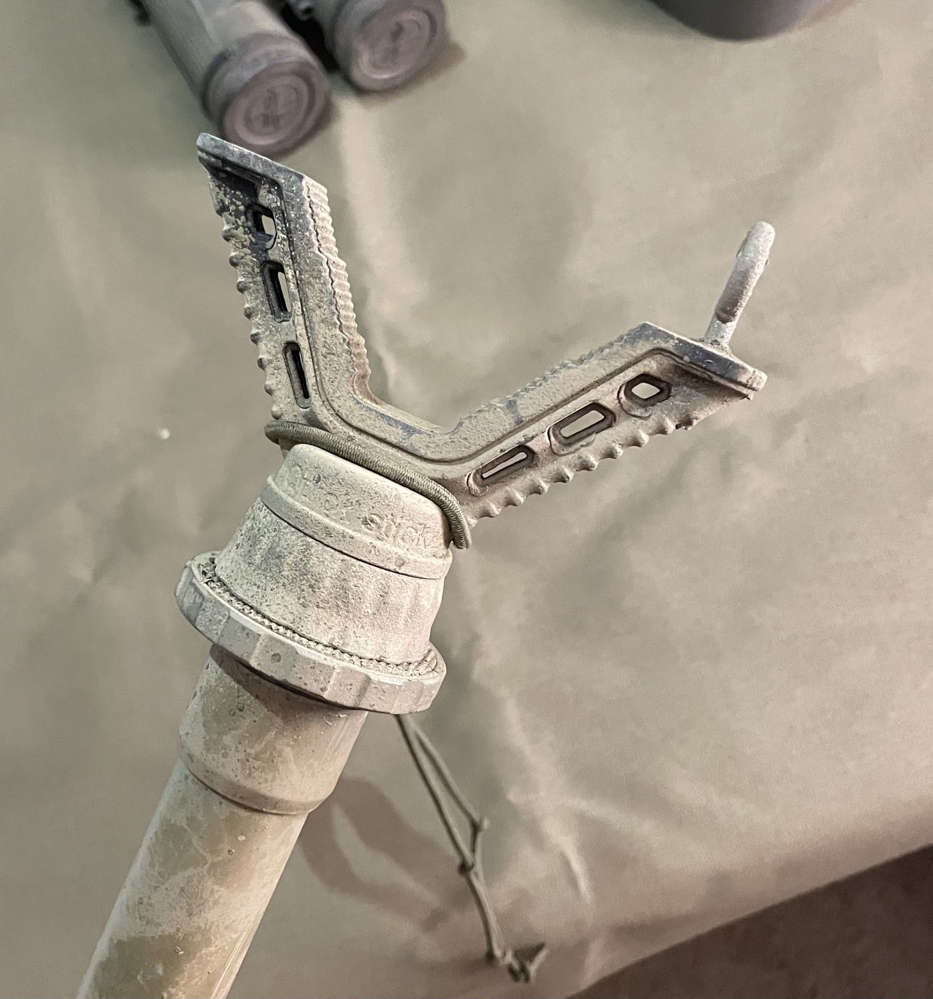

Next, drill a pilot hole in the top of the yoke and just take a simple eye screw and thread it in.

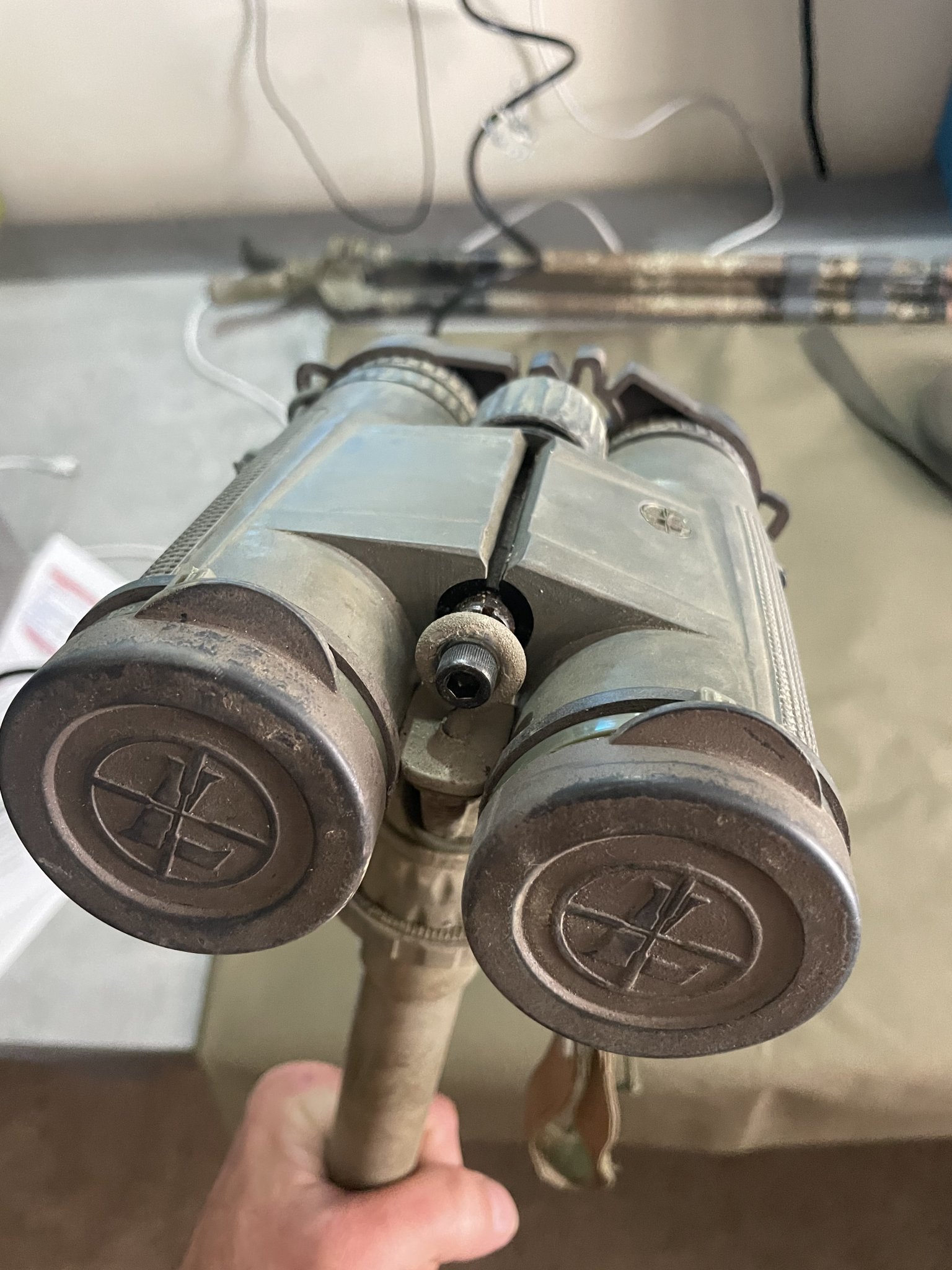

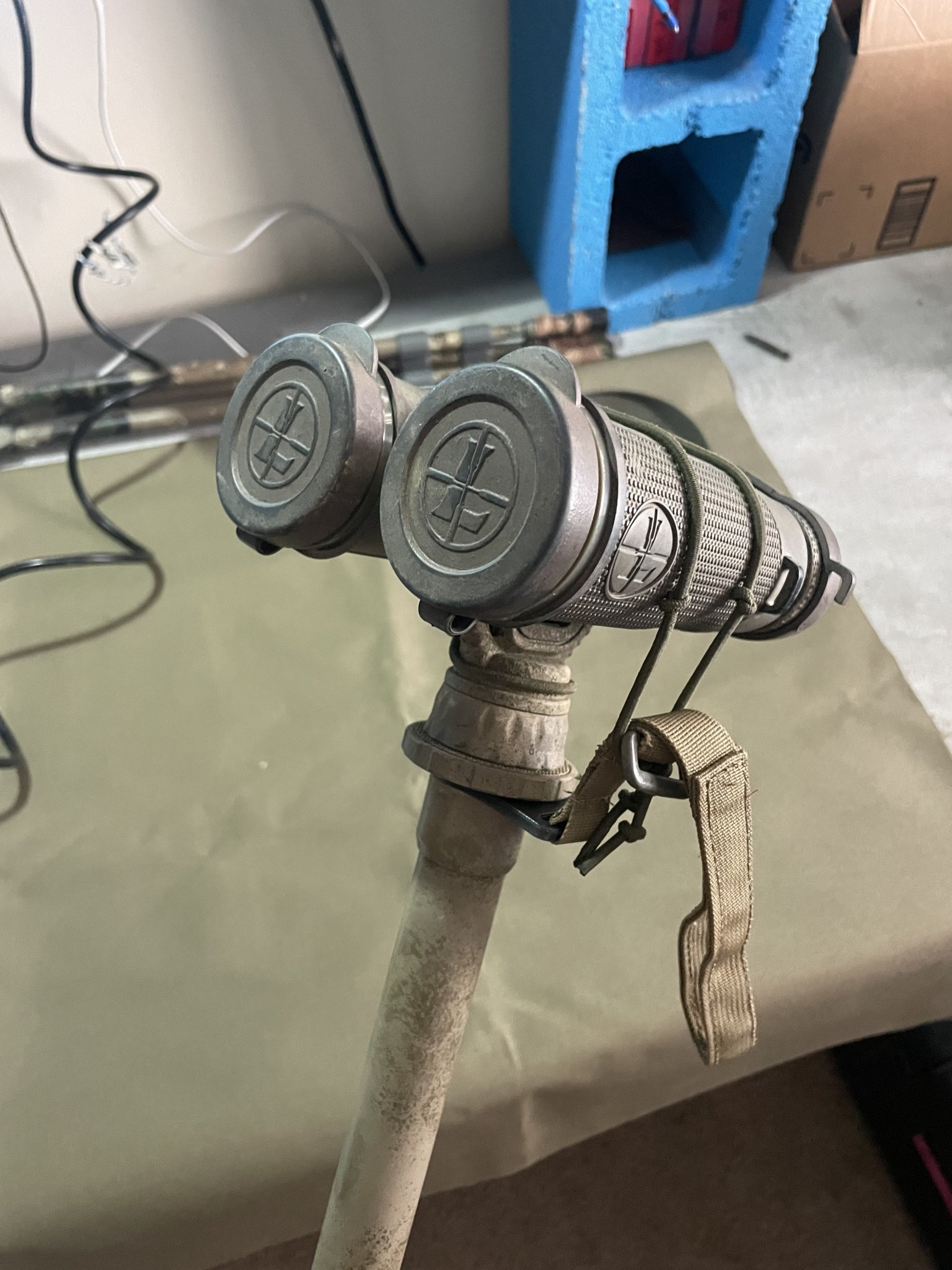

Insert the bolt into the eye and secure it with a bit of shock cord. Stupid simple and stupid practical. Great idea for streamlining your pack.
