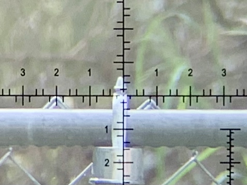

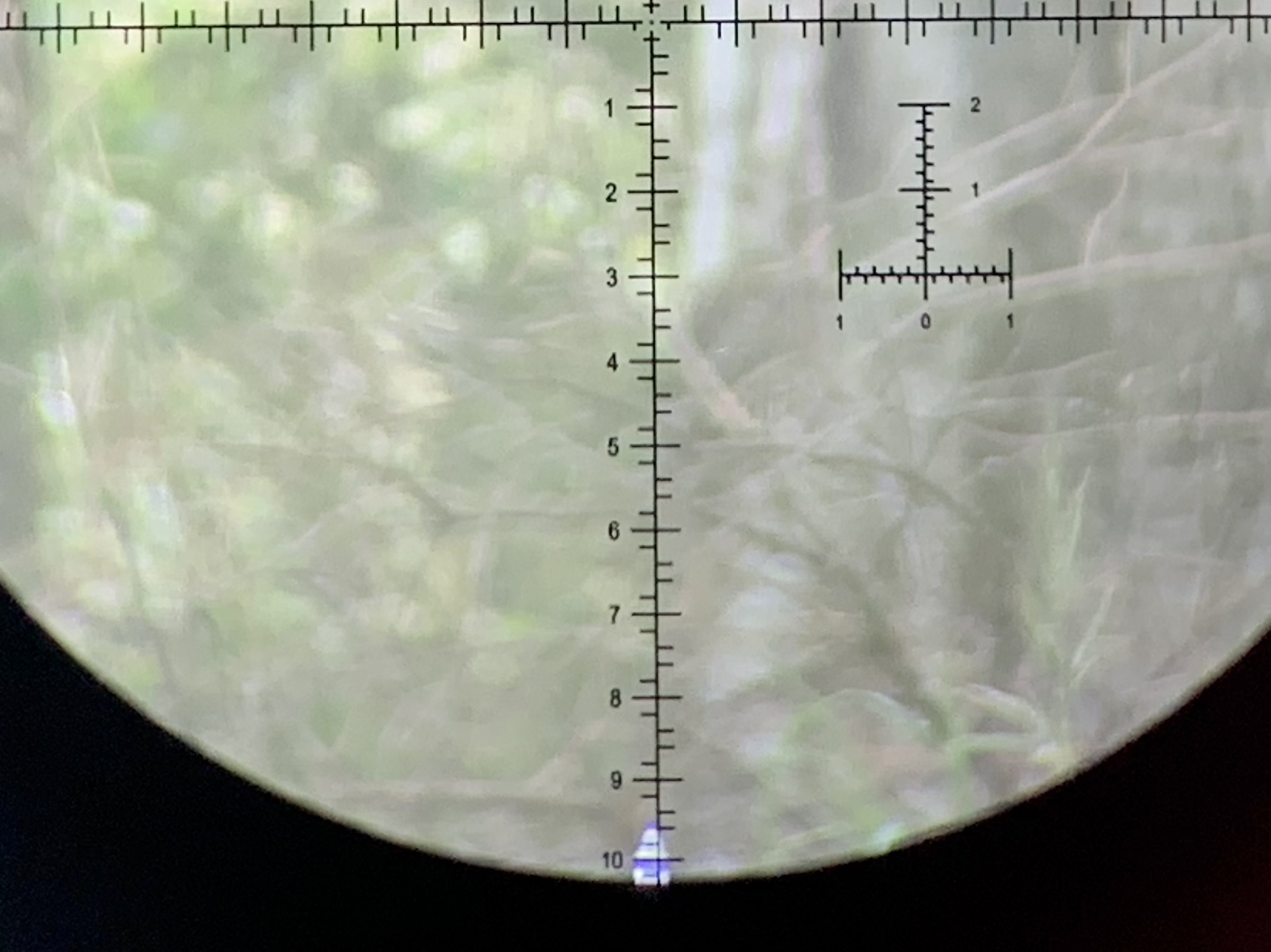

Stick the rifle on a solid setup, in this case a ARCA rail equipped rifle attached into a RRS 34L Anvil 30 tripod. Find a solid fine aiming point, dial out the parallax and put the reticle 10mil hash mark on the aiming point. Then dial on 10mils of up elevation(the reticle will move downward), at this point the center of the reticle should be on your aiming point if the scope tracks 100%. If not what hash mark is? This NX8 looks to be .2 beyond. So it tracks 102% and is actually .102mils per click. Obviously I’m just floating my head above the stock and not touching the set up while doing this.

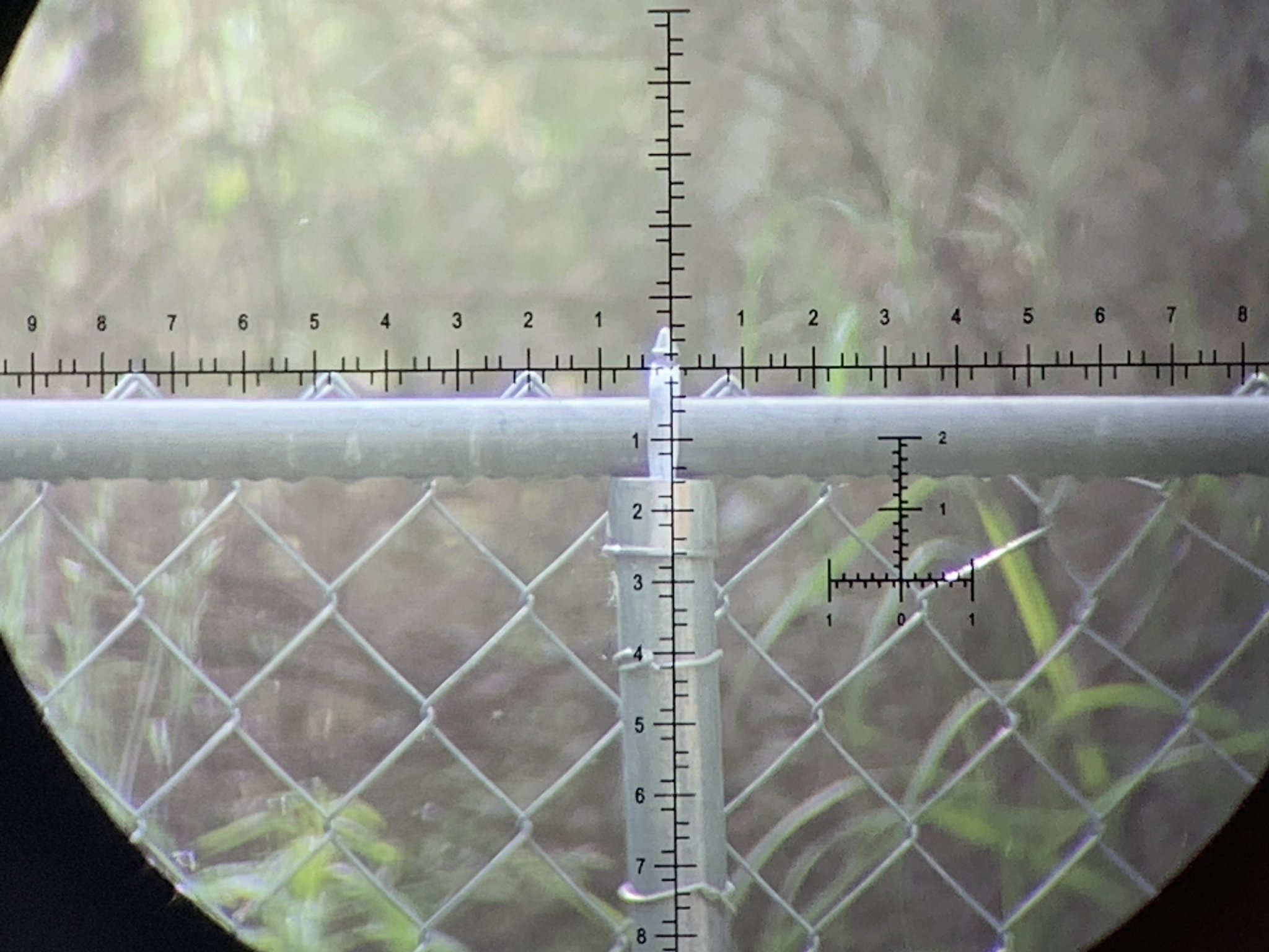

I used the back yard fence, one of the post tops has a bell shape, that has a defined flared bottom edge that’s white in color. Put the upper edge of the 10MIL hash mark on the bottom edge of that white line for my fine aiming point.(Think line of white technique with irons)
Initial 10MIL mark with 0 on the turret.
10mils dialed on the turret. Showing .2mil over tracking in the reticle.
Close up
What do you think? Does it need to be done anymore complicated then this? I did try it with a verified 100% ATACR that Enoughsaid just tested at a class in June and came up with 100% again doing it this way.

ETA: And I agree with your assessment, 102%.
Only question is, how certain can you be that it's the tracking that's off 2%, as opposed to the reticle being off 2% ?
It probably doesn't matter, as long as you know which it is. It is more likely to be the tracking, than the reticle anyway. Just an academic thought.
If you have an accurate distance to the fence, 2 marks with a sharpie spaced 10 mils apart could settle that question.
