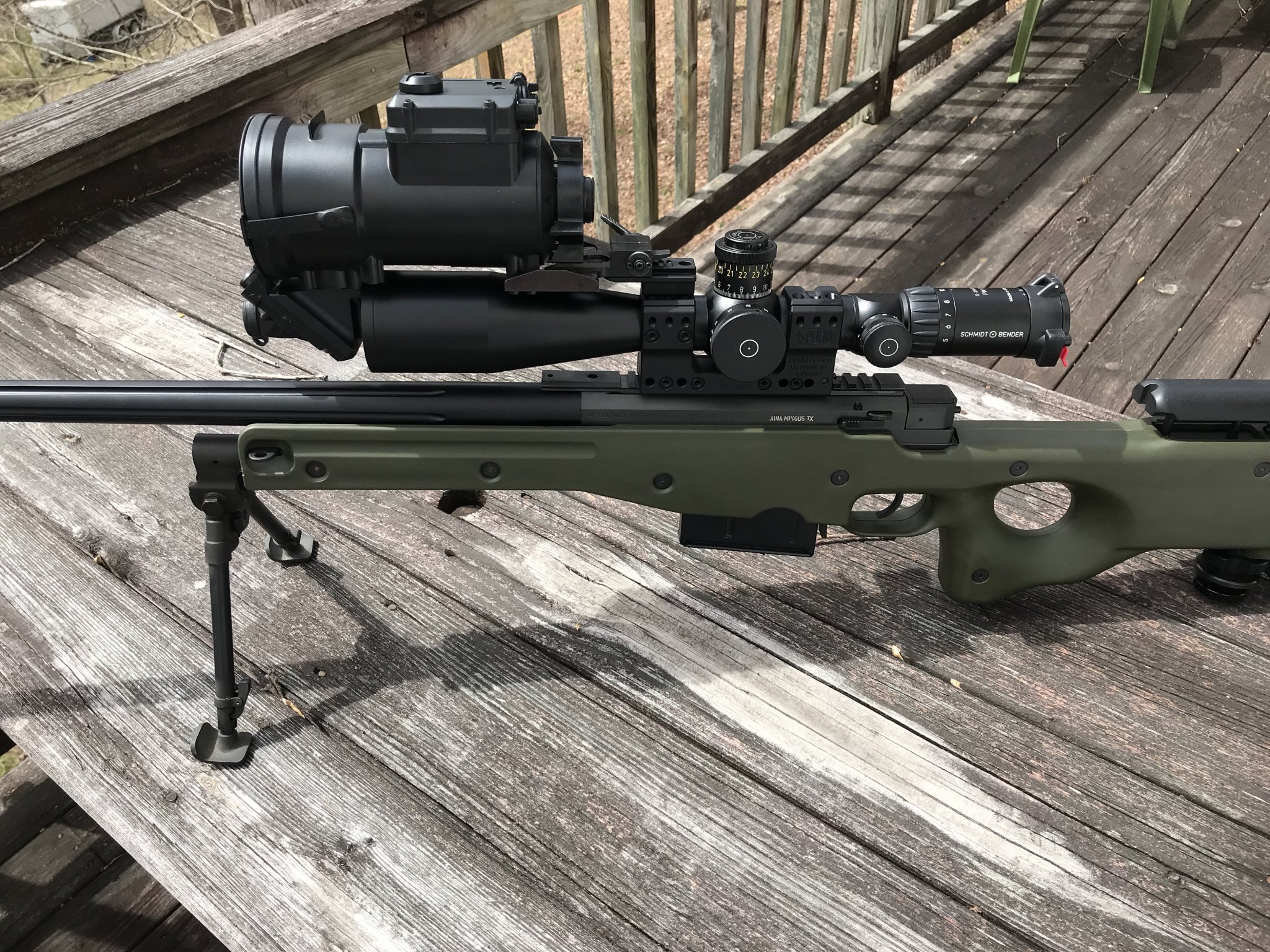

@Greensnake
Can you tell us more details please?
Is that the 10mm spacer ?
Looks like the 253 is mounted fairly far forward on the SIMRAD mount. Where there any mods to the mount ?
And looks like the light shade is removed.
Anything else involved ??
Thanks !!
@wigwamitus
Scope is mounted as far to the rear in the Spuhr mount as possible without damaging the scope. It is a 10mm spacer. Sunshade removed. Does make slight contact with bell of scope when mounting, front not top, so I have to be careful and use a cloth or something between the two when mounting. Once mounted, makes no contact when shooting. It is a very tight fit.
Reactions: wigwamitus
The Spuhr ISMS mounting system has a ZILLION optional attachments.
And for the SIMRAD (US) Mount there are both 4mm and 10mm spacers. These allow the SIMRAD mount to get up higher and allow the SIMRAD to "reach over" larger objective bells. Mile High is the USA distributor for Spuhr, so you can view most of the options there and also view them on Spuhr site itself. For the items that Optics Planet has, you can usually get a lower price with OP.
I used to run a 253 on a 4.5-27 Gen 2 Razor. 10mm spacer and removing the shroud was all it needed I'm fairly sure.

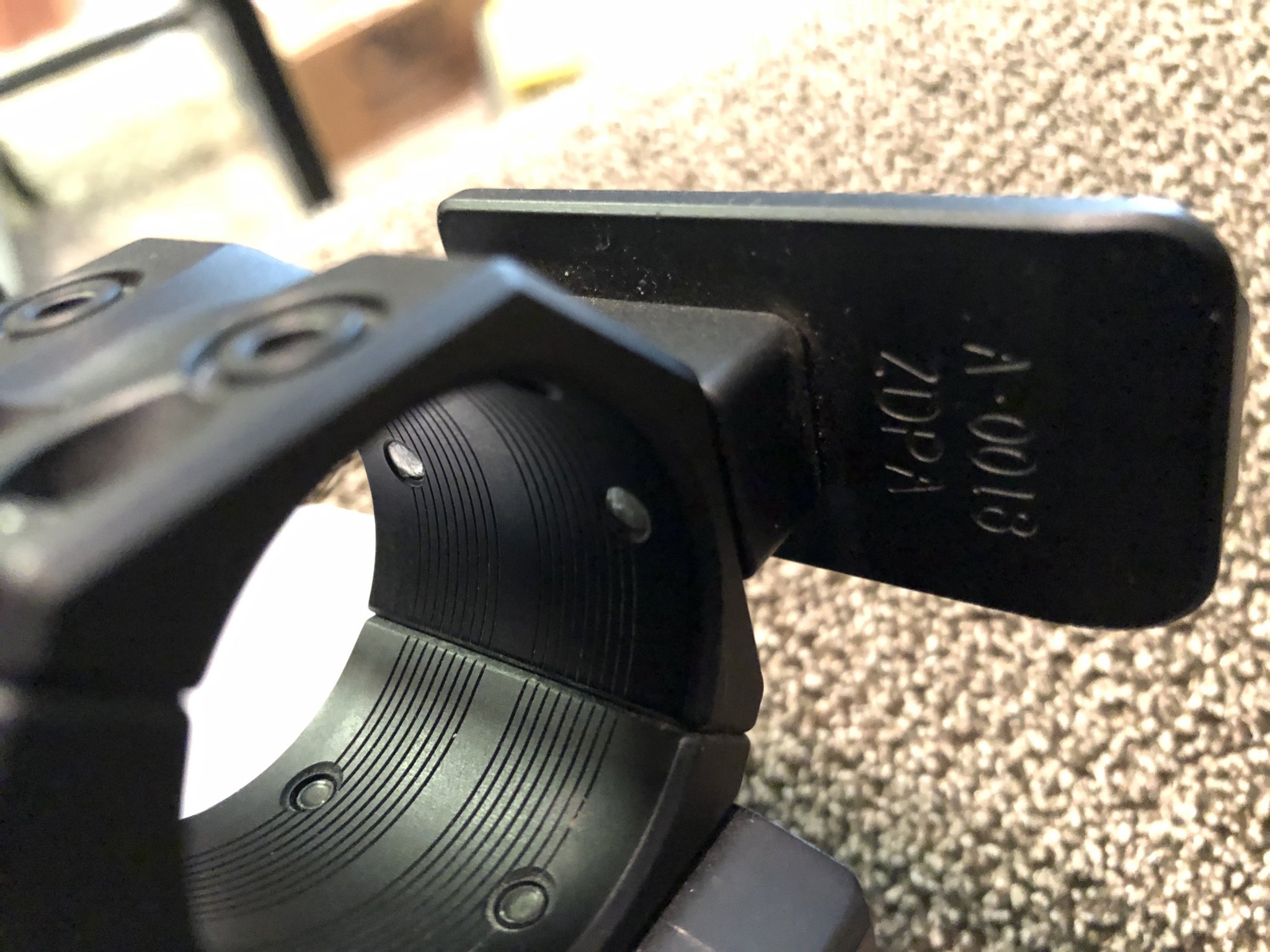

See I thought I was missing something about the mounts until you said that
Then it dawned on me after your post... The spacers you guys are referring to have nothing to do with the simrad mount
Trip back to mile high
4mm
10mm
So I see what you are doing now.
Does this offset give you guys any trouble?
Also I noticed the simrad mount references that it's for 34mm mounts... So I guess there is no option for a 35mm mount?.. I would have thought it would work with either
And as has been said in other threads ... be REAL careful with the screws and the spacers ... you can dig a hole in your scope if you are not.
True that. The screws they ship with the spacers sometimes are not correct. I put a screw mark on my S&B:mad:
Yep. Luckily I read that beforehand and checked or I'd have done it to my razor. I shortened them a little with a precision gunsmithing tool (Dremel).

So I decided to don't fight it, and take the easy route, just relax and go with the flow. A PVS9 ( it is, What it Is )
So I been just using the Badger 30mm setup for years, with just making my Scope use decisions put to the natural working dimensions of PVS9 . Limits set is still pretty large. 30mm tubes. low power variables with a 42mm obj. or smaller, for night hunting . and so I been using anything from 1-6 x24, to a 3-16 x42 .
