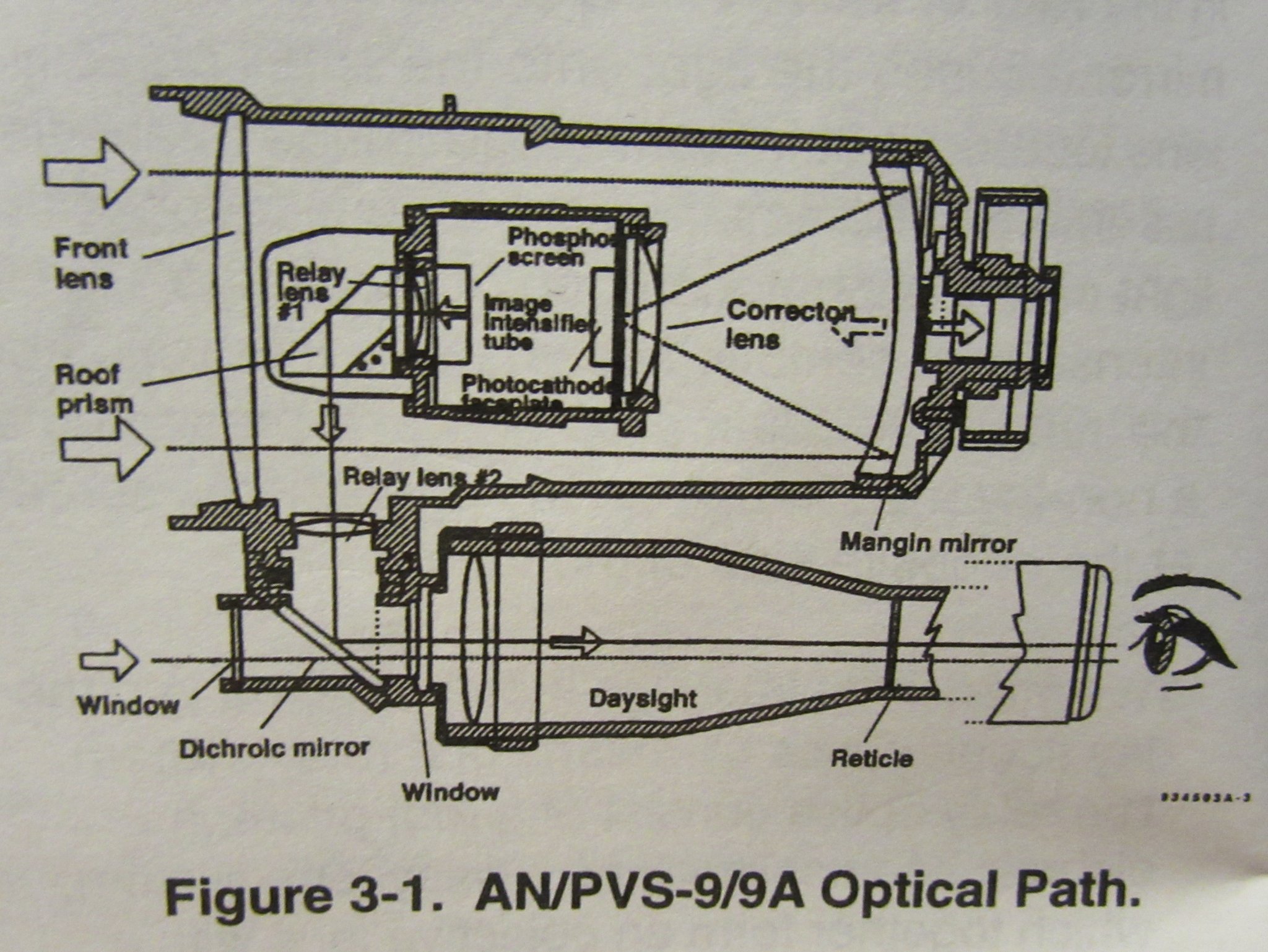

I was thinking that they move a prism or something internally that affects the view, no matter if it being viewed via the day port or the night light gather lens…….
So, are they likely just not working, or do they really only affect the night time lens, so any real adjustment needs to be done while shooting at night?

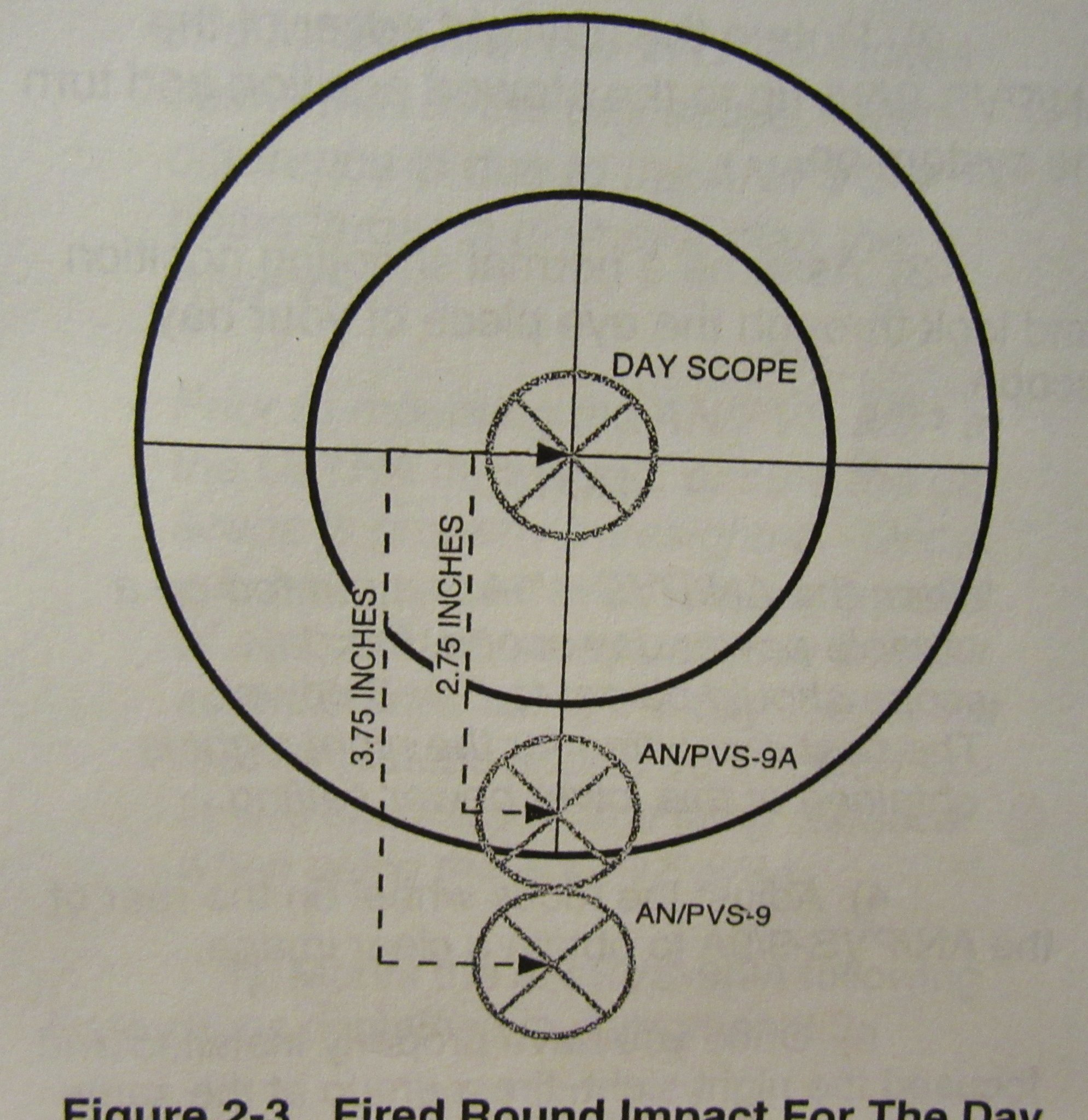

I've never heard of this and it is definitely not what the Simrad manual says. Is it a KN203 or KN253?
I have a 253 and a 203. I dial 1.1 MIL up on the day optic that runs the 203 and then made the needed adjustments on the simrad to make poi meet poa. From then on, I just dial the 1.1 MIL to the day optic when I mount the simrad. For the 253 I use the same process but a .8 MIL adjustment to the day optic. For both rifle/simrad combos I have a second profile on the kestrel with the height over bore set from the center of simrad to center of bore.

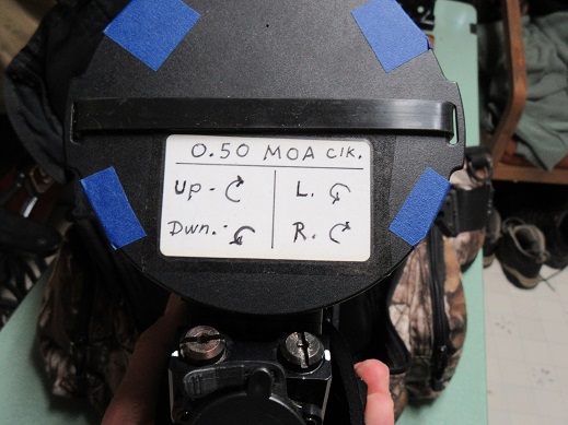

0.50 MOA
an easy diagram for Collimation, Left side and Right side knobs .
For 203 Dial 1 mil or 3.75 MOA (.7 mil 2.75 MOA for 253) on your elevation turret, then zero by shooting your Simrad at night at 100 yards, not with the silly little see through thing. Magic, your Simrad is collimated and you can dial a mil on any optic to pop it in front of and she’s good to go. Hold or dial additional dope from there and have a separate ballistic profile for the height over bore of the Simrad unit.
this.....
