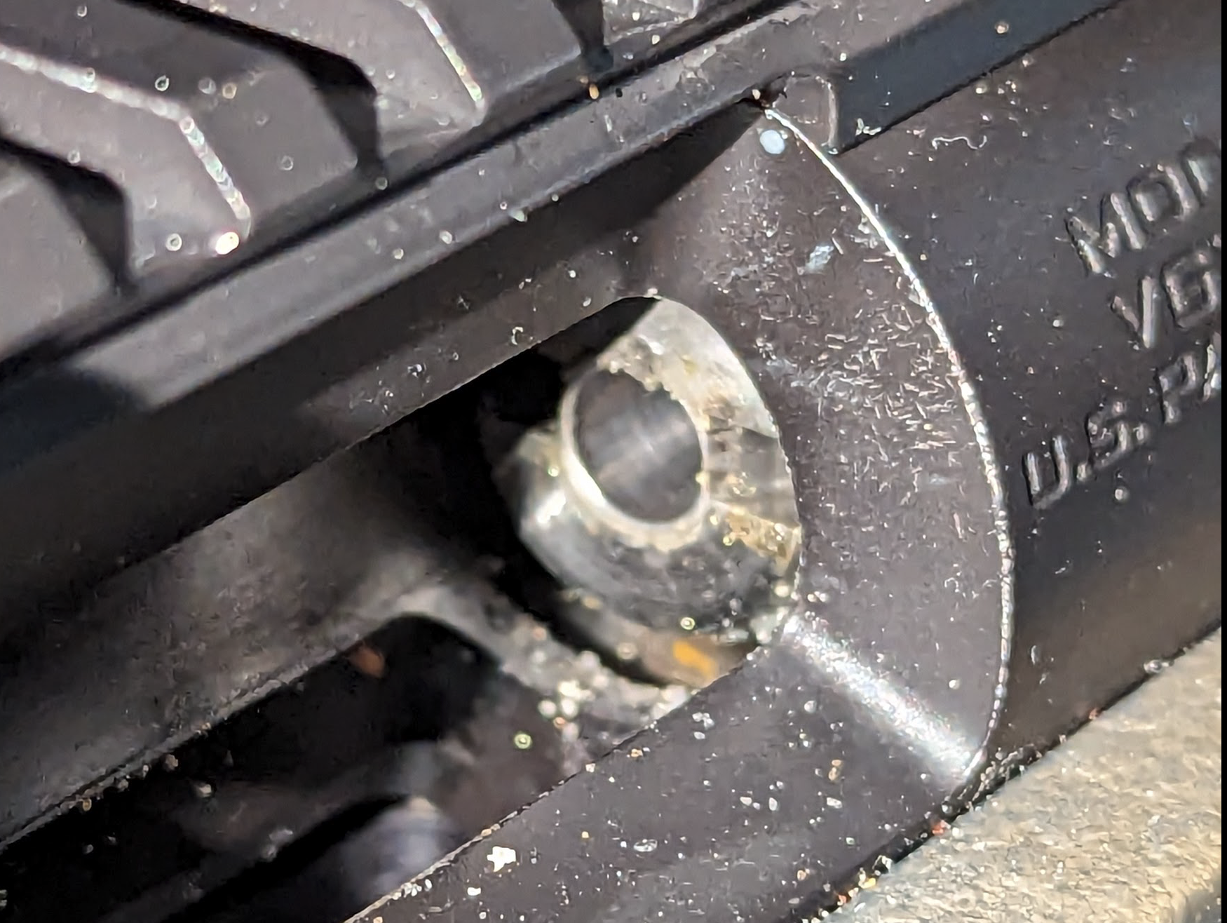

This is the breach face after 300 rounds. There should be no build up at all around the ring of the breech face. If you have any shavings, it means your mag is not properly aligned. In this picture, all you can see is the dirtyness of the 22 but no buildup on the bottom ridge from shaving any lead.

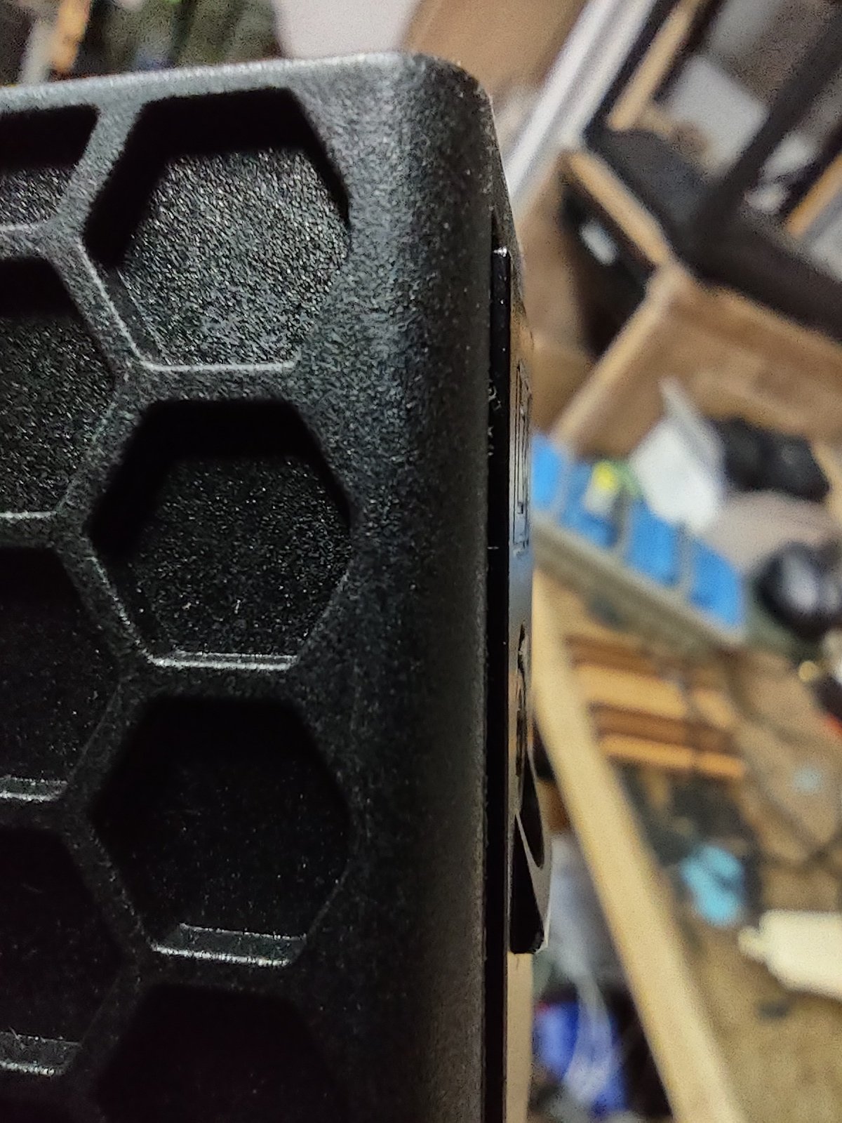

FYI some more feedback on mag. Shooting some practice today and put it in my SAP mag holder. L3i Elite locked up so solid in the mag holder I had to take it home and completely disassemble the mag holder to get it back out. Once I took it apart I saw the adjustable mag catch had dug into the kydex and created a burr that held it solidly in the mag holder. Not sure if I just need to round the edge of the mag catch or what. Would have been terrible at a match. For now not putting it in those mag holders and only using it when starting a stage until I figure that out.
I bet taking the sharp edge off with a bit of sandpaper would work, but that’s good to know.

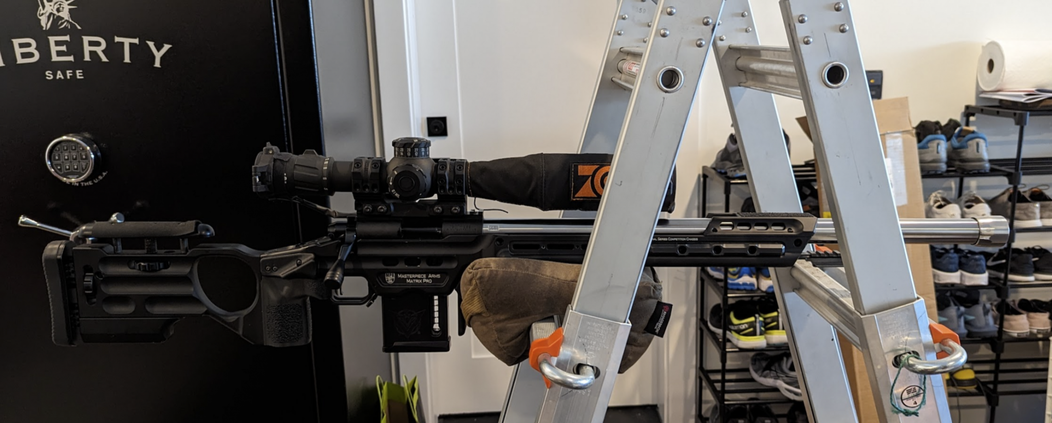

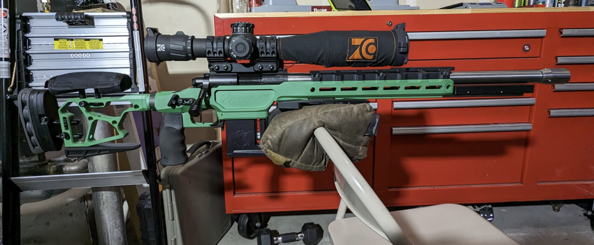

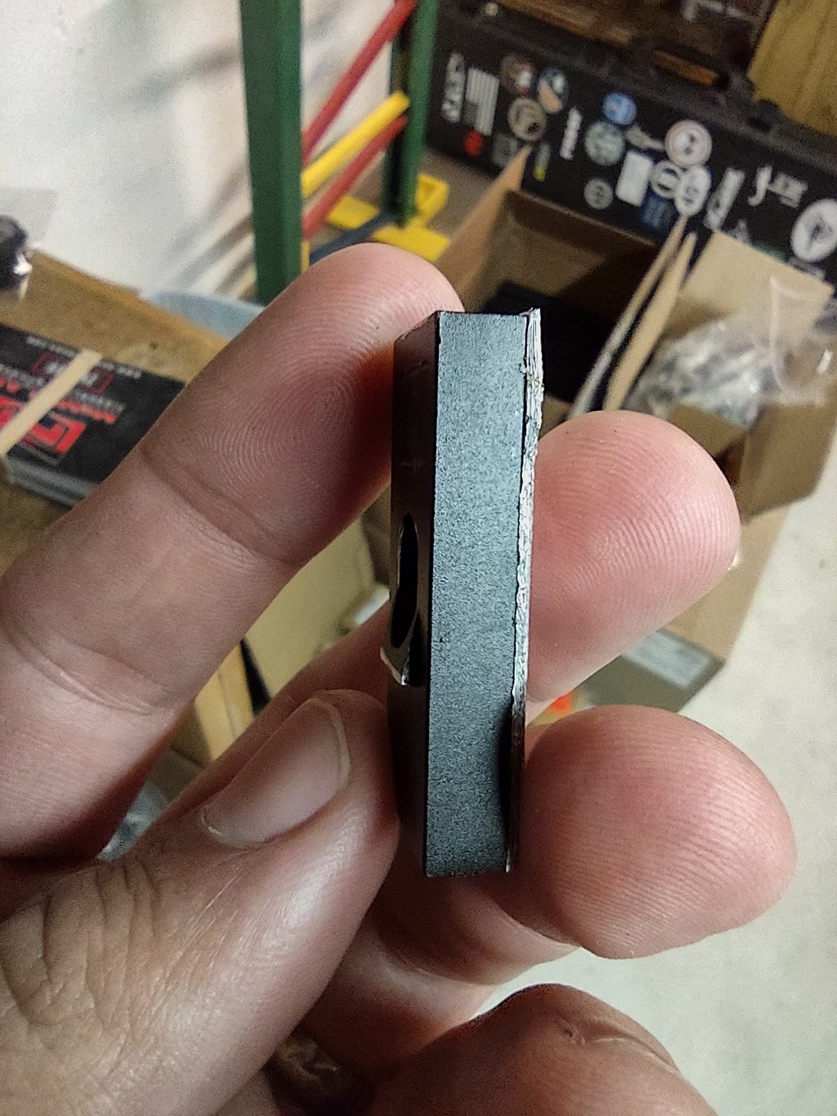

You can add shims under the Elite mag catch to take up room front to back. If you set it for your rifle you won't need a barricade block.
