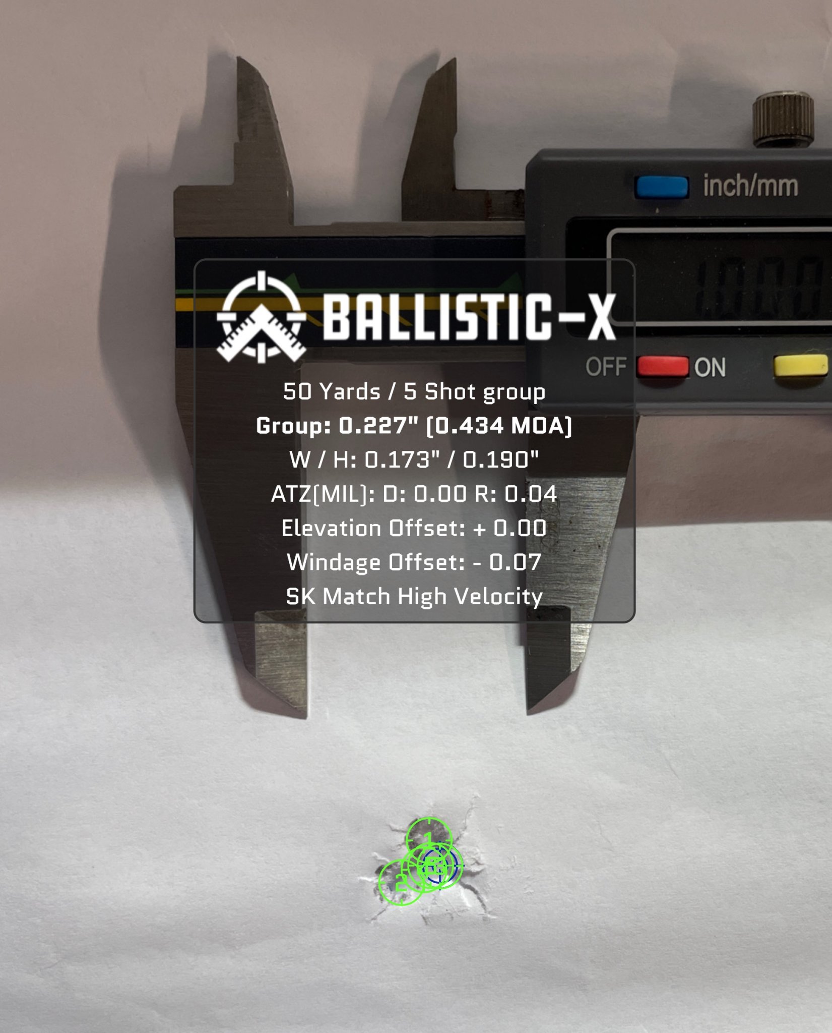

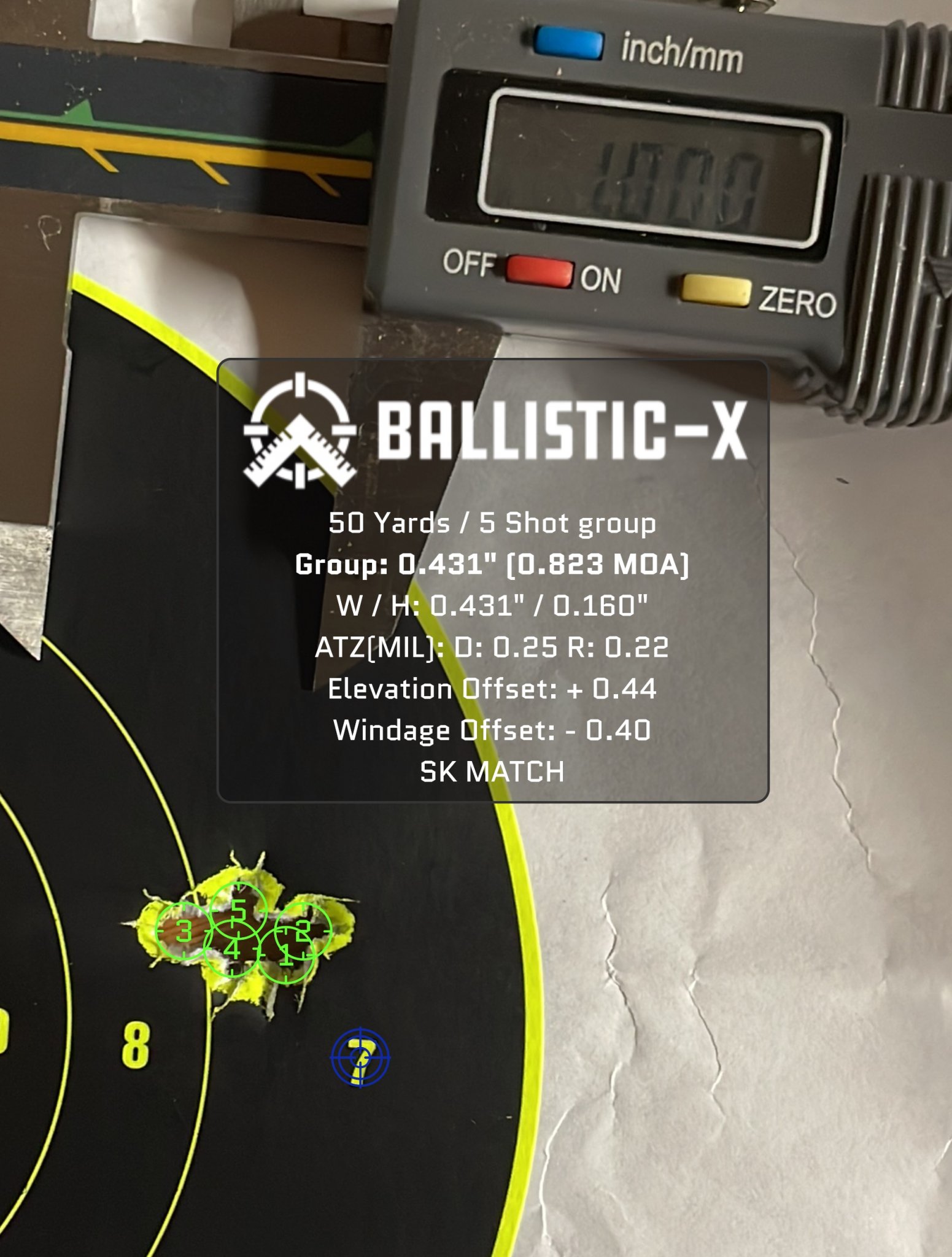

    Does anyone have experience with it and have good results? I grabbed a few boxes to test out since it seems very easy to obtain since I’m assuming it’s not all it’s cracked up to be and who doesn’t want cheap available ammo if it shoots well.
    I didn't spend time trying to adjust my tuner for it, but SD on it was ~29 fps and ~.750" groups at 35 yards out of my Tikka T1x
    These are groups out of my CZ457 with SK Match high velocity. It seems to shoot good groups BUT my SD was 25 fps.
    CCI Standard shoots slightly under 1 MOA groups. I ran a 20 shot string and got an SD of 8 so I’m considering just running that for $5 a box

    Well now I’m very happy I’ve only got 3 boxes of it to waste, it’ll be interesting to see how terrible it is with a 12tw since it’s gonna be spinning at an absolutely ridiculous rpm.
