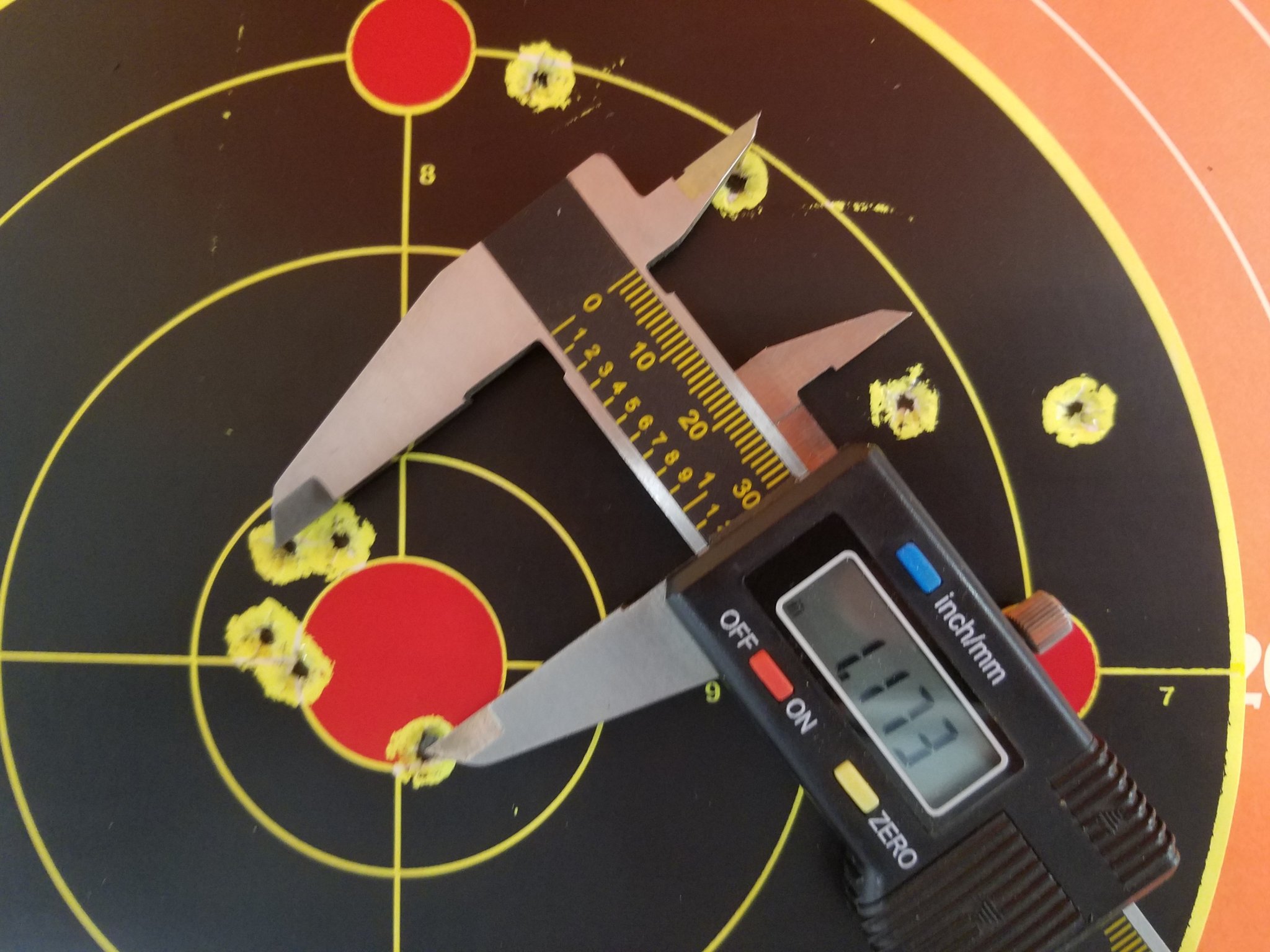

This was a match last week at 200yds. I was shooting over my flags and got tricked by swirling gusts on the 4 high right shots. Measured group is 6 rounds. Early 18" Ace barrel.
