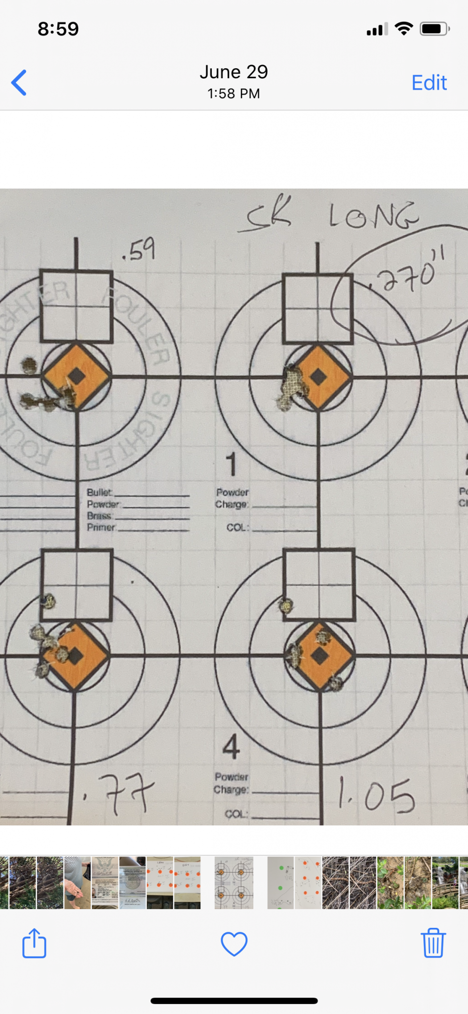

Sk long range has some inconsistencies but I put it right about equal with center x. This is a target with my vudoo at 100 yards. Best 100 yard 5 shot group to date .270” .
