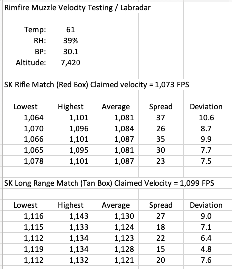

This is the first time I have done any muzzle velocity testing for rimfire, was testing my CF loads so figured WTF and wanted to share. This was all done today using a LabRadar for velocities through a Vudoo with Ace / Kukri contour 16.5" barrel with just a thread protector. Was surprised at both the velocity out of this shorty barrel and just how consistent this ammo was running through this rifle. Was plinking a 3" swinger at 100 yards, next time will try to shoot groups and match the strings.
velocities seemed high but at 7,400+ feet, probably right on. SD's looked good, I thought, for rimfire.
