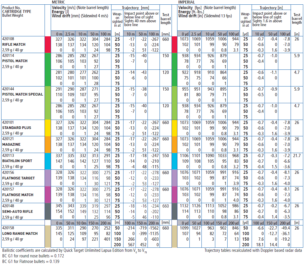

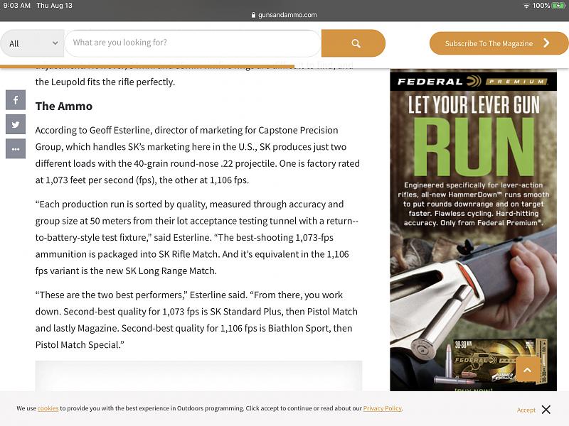

Have posted these before but are still a good reference to have handy. There is a Feet Per Second Speed difference between them, long range match is the faster cartridge at 1106 fps and SK rifle match is slower at 1073 fps IIRC. Both are considered by SK to be the best in their product lines as far as their internal testing goes.
