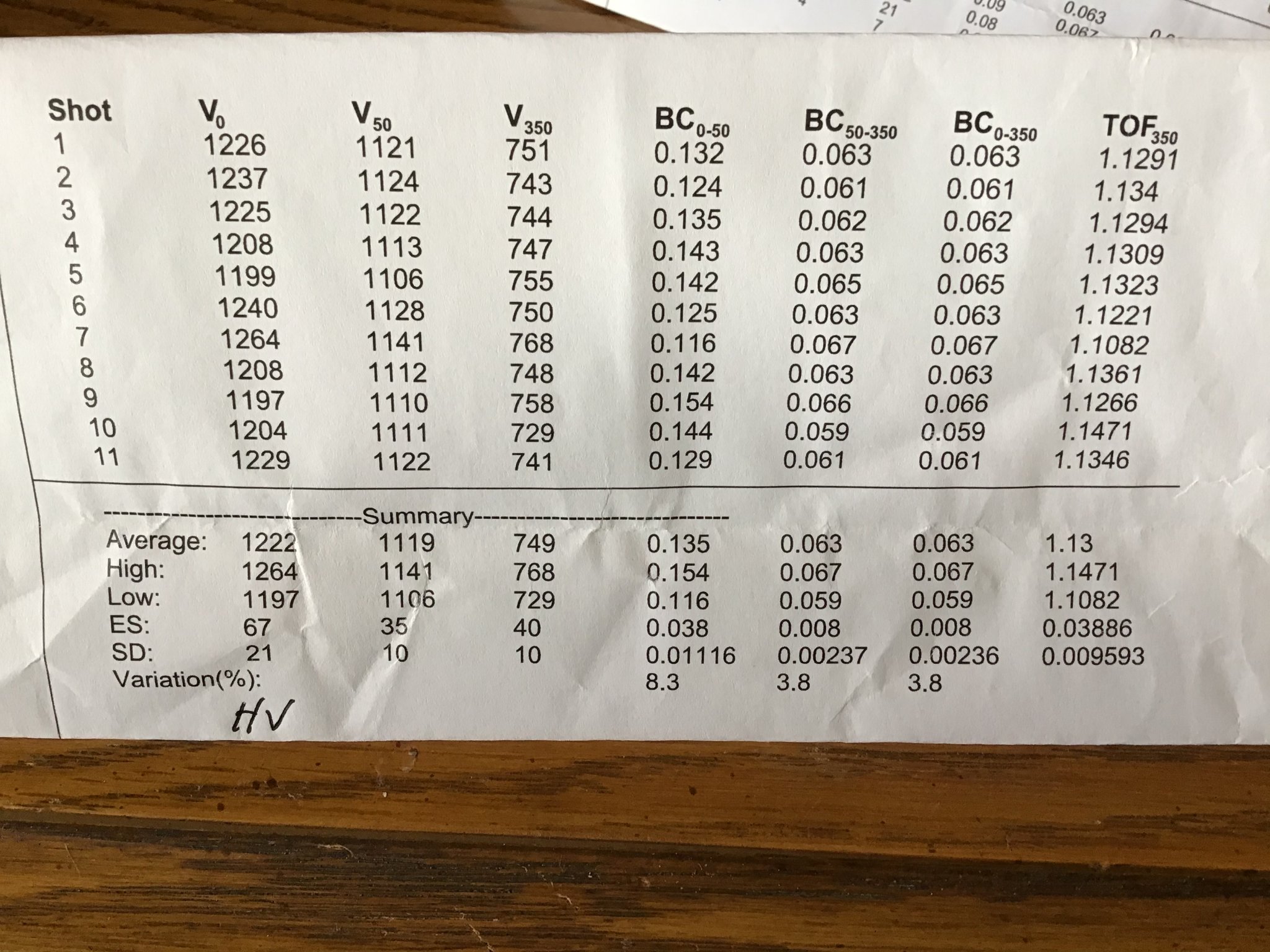

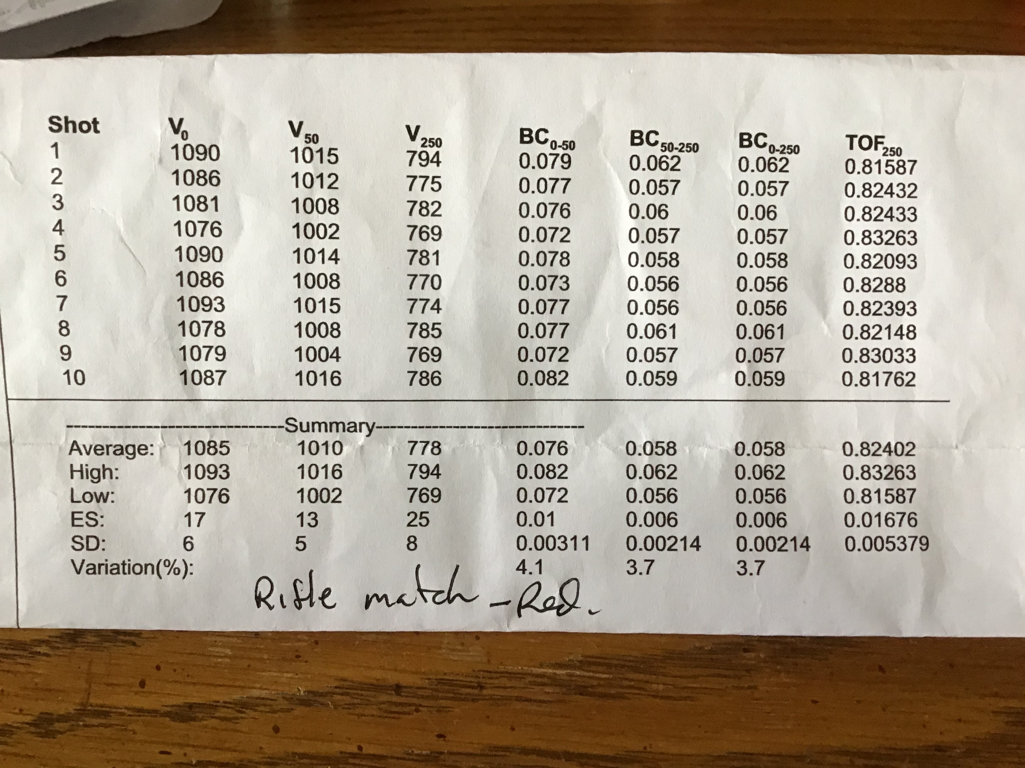

Performed doppler radar ballistic summary out of Vudoo gen 1 18 inch barrel
SK rifle match and long range summary was performed at 68 F
SK HV at 60 F

So based on your numbers and my 612 yard targets your ES would produce a 17.5" vertical spread at this range 612 yards my low to high shots measured just over 25" with 7 landing in a 9x9" square that adds up possibly the best it can do LONG RANGE is green marks.
Have been curious about the new HV ammo; the rather large ES/SD numbers you got out of that particular lot would make me shy away from it if that's typical for this grade of ammo. However, it's just one lot that you tested, so unless/until the ammo shortage comes to an end, and we're again able to order in lot samples, I'll leave this HV stuff on the shelf...if I ever see any of it available.
What conclusions can be drawn about these three varieties of ammo based on the ES and SD of a small sample size of a ten-shot string for each?
I can say 100% rifle match and long range have been very very good lot to lot for me.
I’ve ran 10 - 12 different lots of sk red and long range.
Never had sd’s like the HV yes it’s one lot( if I had more would do a better study)
Feel free to send me SK HV,long rang and red for further study. ( 10 lots each)
All the different lots of Sk red and long range I’ve shot out of my Vudoo have been very very good.
The charts/Summary are a base line to start out with or to compare what data someone else has recorded to determine a trend in quality.

The one main thing people over look in these self test , is how the manufacture derives their data. SK used a 26 " barrel to test the ammo shown in this thread not a 18". Loads by them or anyone else are derived by burning a powder that is continuous and not erratic. So that 99.5% of total gas expansion is achieved without spikes during the expansion right at muzzle exit. The ES AVG. For SKHV is 31 fps in my 25" barrel your dumping some powder that is in the burning process ,but not completed in a 18" barrel. Other words a good load doesn't work in all barrel. If it groups good this week in my extended testing it would be a plus, why ? It's velocity alone picks up 2.8 " of group size at 600 yes over any ammo running 1090 fps down 😉

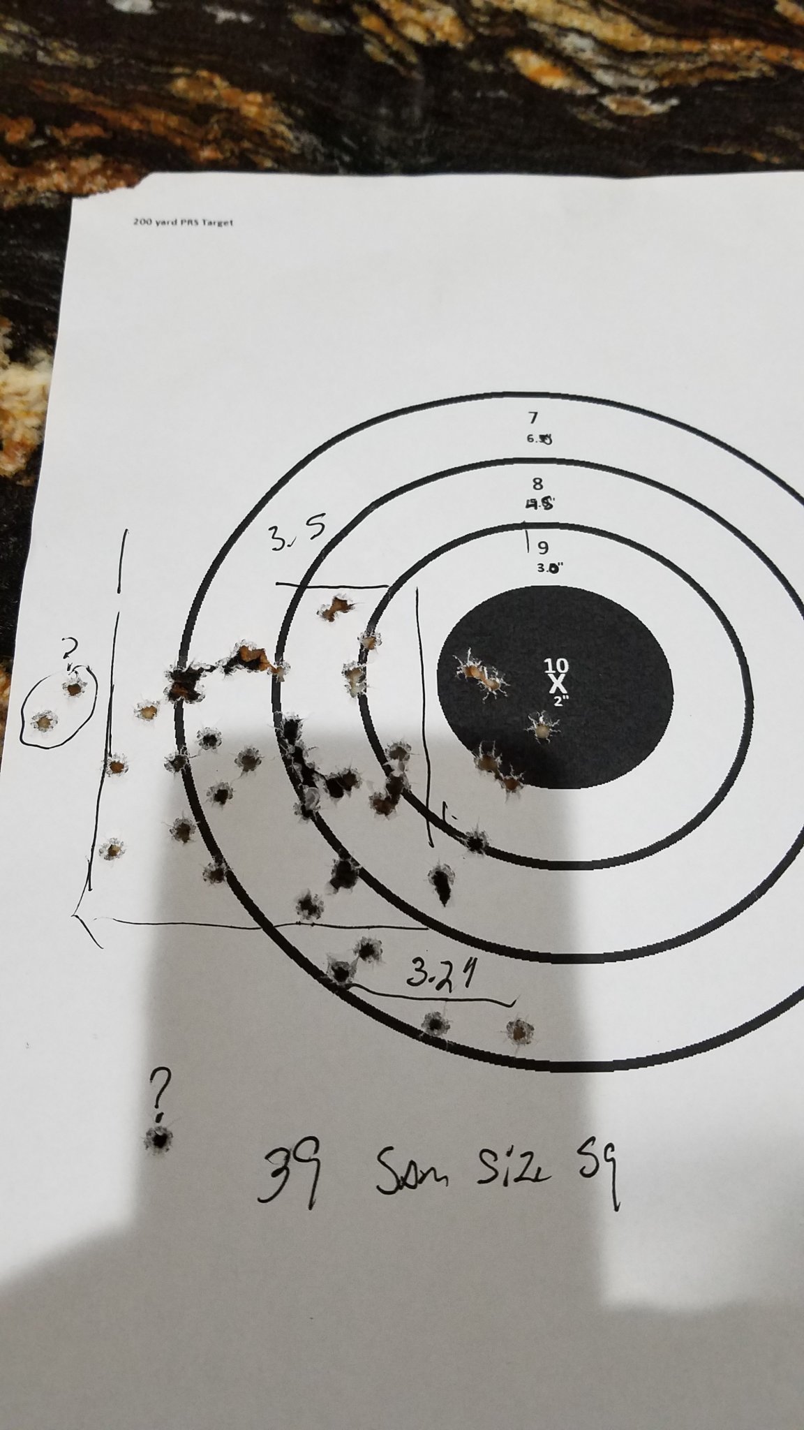

Here we go I dont think I've shot 50 rounds that fast in 40 years I dialed back from my 612 yd session and cutim loose o I did set the chrono 25 feet out front that way it was clean air Long range was 1st up 50 shots total now I had 3 wind shifts that affected impacts wind started at 5 back rt shoulder 1st shift from 9 oclk. Blew 2 rt at 3 second shift from 3 ok last shift in my face from 11 pushed 3 low and rt. All n all 42 rounds in a 2.505 x 2.708 group everything in less then 3"
High 1101
Low 1079
Avg 1091
Es 22
Sd 4
Reactions: Gleedus

Gun was not shot off front bag or bipod it had a rear bag and 2 bricks under the front 😁 I was in a hurry !

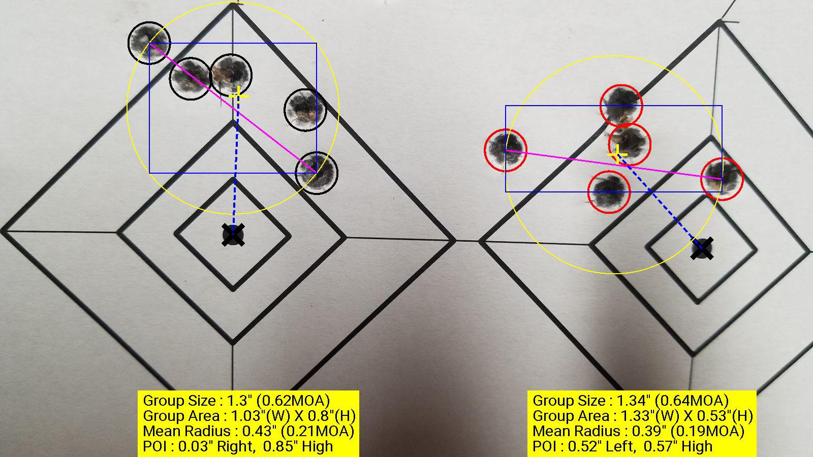

Heres 2 back to back groups I shot at 200 yds today I was 2.3 moa left and up 1.1 moa into a steady 10 oclock wind 6.2 mph SKLR. I stopped after the 5th shot on #2 diamond wanted to end the day happy.
