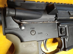

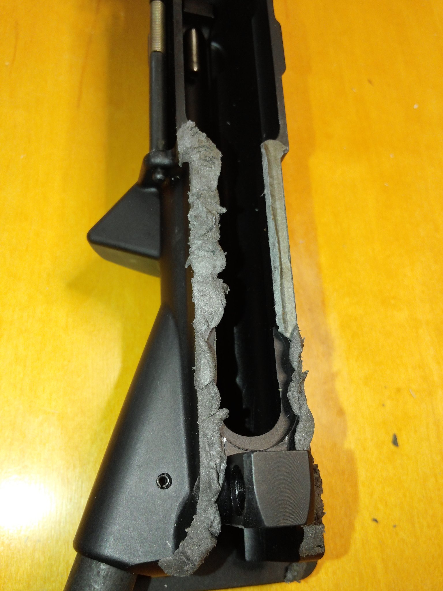

The easiest and cheapest way I have found to fix it is to us a hot glue gun. I clean the lower at the rear take down pin really good so the glue will stay in place. I wipe the corresponding upper area with very light film of oil. If the gun has already been shot it will be fine without more oil.
I use a hot glue gun and put a blob where the upper will seat into the lower then I close the two, push the pin in and wait a few minutes.
This gets rid of 100% of the upper/lower slop. Gets rid of any up/down slop as well as any side to side slop. It is reversible and only takes a few minutes.

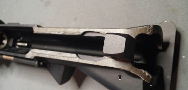

Well I tried the oversized JP pins and that didn't fix the problem. It actually created a new one. I had to use a delrin punch to get the rear pin out. It won't pass through the upper without a lot of force. I am going to try to bed it and see how that works. The rifle has proven more than accurate enough for what mouse it for. I didn't buy it to be a competition gun but to a cheap hog blaster and plinker.
When you bed it, temporarily put an O-ring around the front upper lug, as shown in the pic below. That springs the upper and lower as far apart as possible, so that when bedding is complete (and the O-ring is removed) you have the tightest possible fit. If you bed with black RTV (the toughest kind) this way, you get a very solid fit but can still install and remove the pins easily. This is how you get an upper-lower fit with zero play/movement/rattle.

So I've got a couple of rifles with somewhat sloppy fit. I also have a glue gun... Well, a bit of oil on the rear upper receiver mounting support (and a good wiping down of the lower receiver to remove any oil) and a blob of glue down in that recess. I also put an index card between the upper and lower, near the front take down pin (as a wedge), while the glue was cooling. The index card was just enough shim to make the rear take down pin slightly difficult to push home. On the rifles this was done to, the slop is not totally eliminated, but it is so much reduced that they feel like different guns. Has the accuracy improved? Probably not, and I've only shot one since the mod. But, the rattle is gone. I didn't care enough about the slop between the receivers to do anything about it before I saw this thread, because they all shoot really well. When someone suggested the hot glue gun, that was an idea that is sufficiently easy, cheap, and reversible that I thought "What the hell, I've got a few minutes." I also didn't risk gluing my gun together permanently with bedding compound. Well, it works, and I can still easily open the rifles without tools. This is not something that can be said about over-sized pins, tensioning screws (one of the rifles is built on an Aero M4E1 enhanced lower), or other bits of AR15 "magic."
Yes, I could have replaced the uppers and lowers with units costing several x the money. (For rifles that already shoot really well? Talk about throwing good money after bad.) I could have bought accuwedges and pins and other bits and bobs that would eliminate the slop. But, the glue gun was sitting in the garage. And, if I don't like it, I can pop that little glue pad out of the lower with no wear to me, the rifle, or my wallet.
If you've got a glue gun, a rifle with some sloppy fit you'd like to tighten up, something to use as a wedge while the glue cools, and 20 minutes to kill. Go for it. If there is a best part==> If you try it and you don't get exactly what you are after, add more glue to the pad and go again. It only takes a few minutes for the glue to harden. Build the pad up iteratively. But, don't expect magic. This won't make your AR15 feel like a bolt gun. There will likely still be a bit of play. But, I don't notice it on mine unless I torque around on the rifle.
