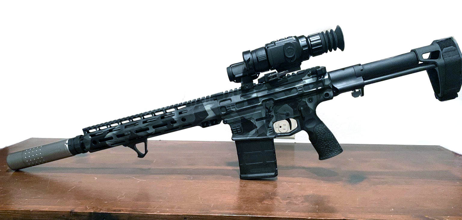

I just got done building a suppressed 308. Only have a few rounds down it. So far it’s quite as can be for a sbr. Might try some subsonic rounds down the road

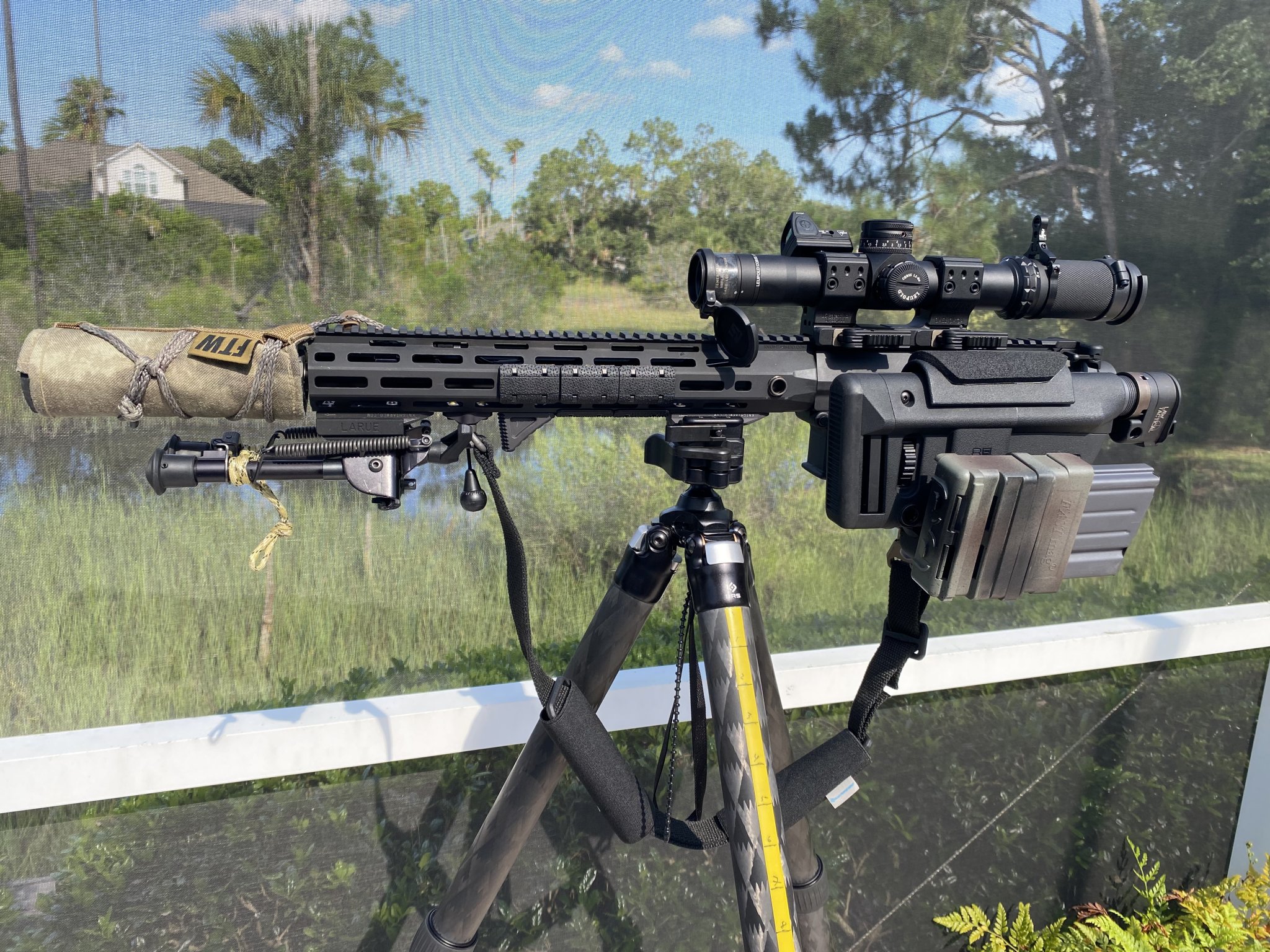

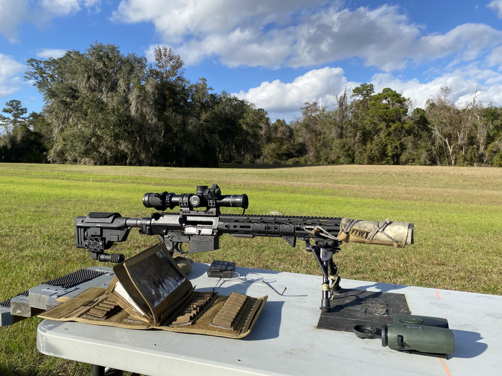

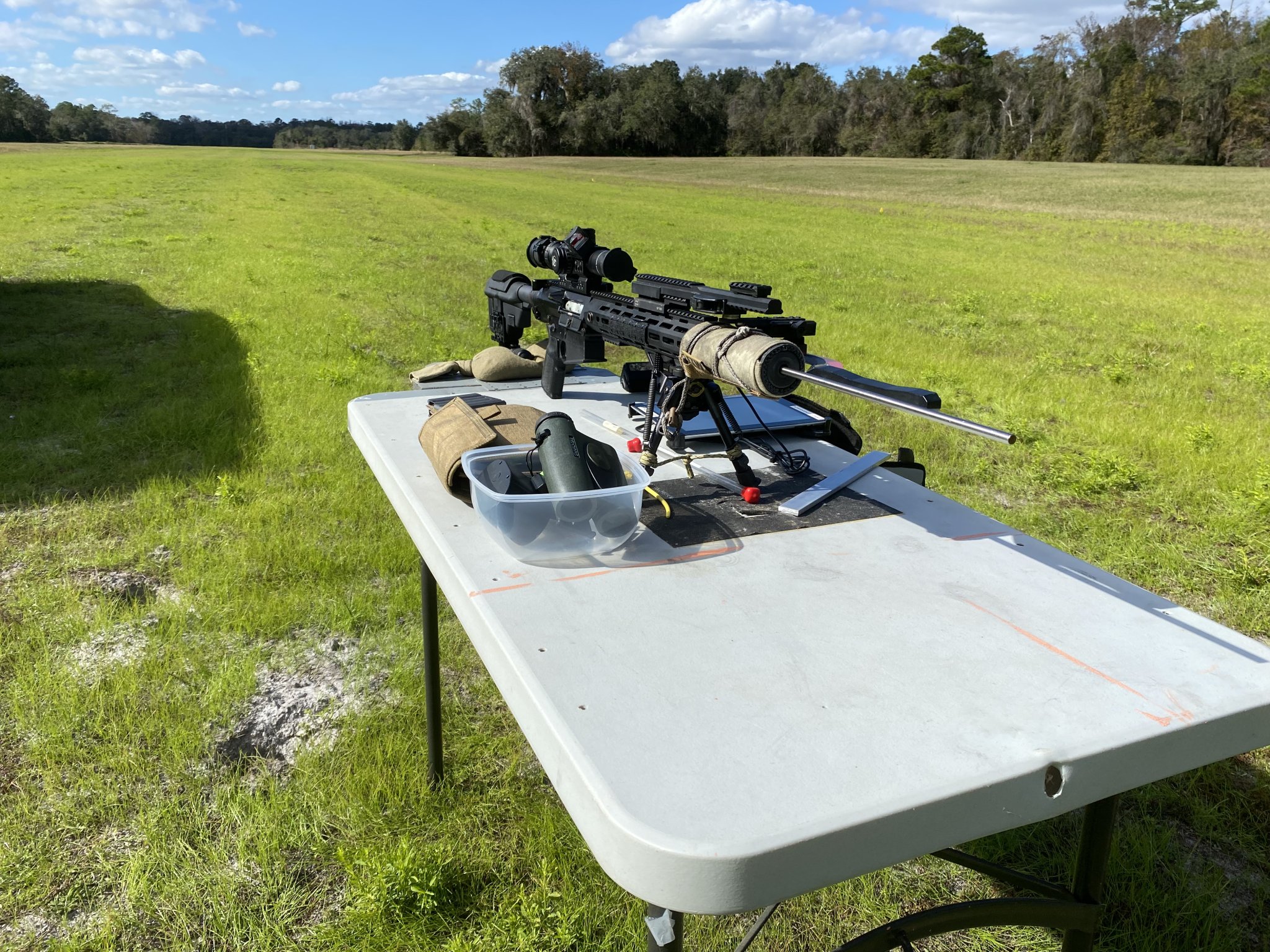

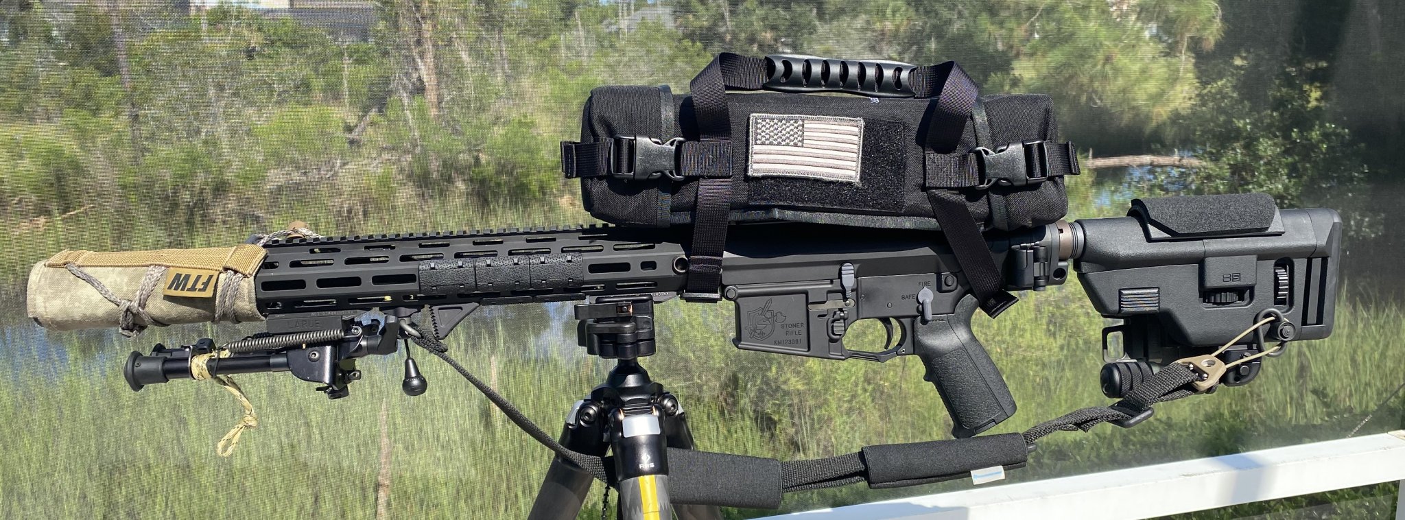

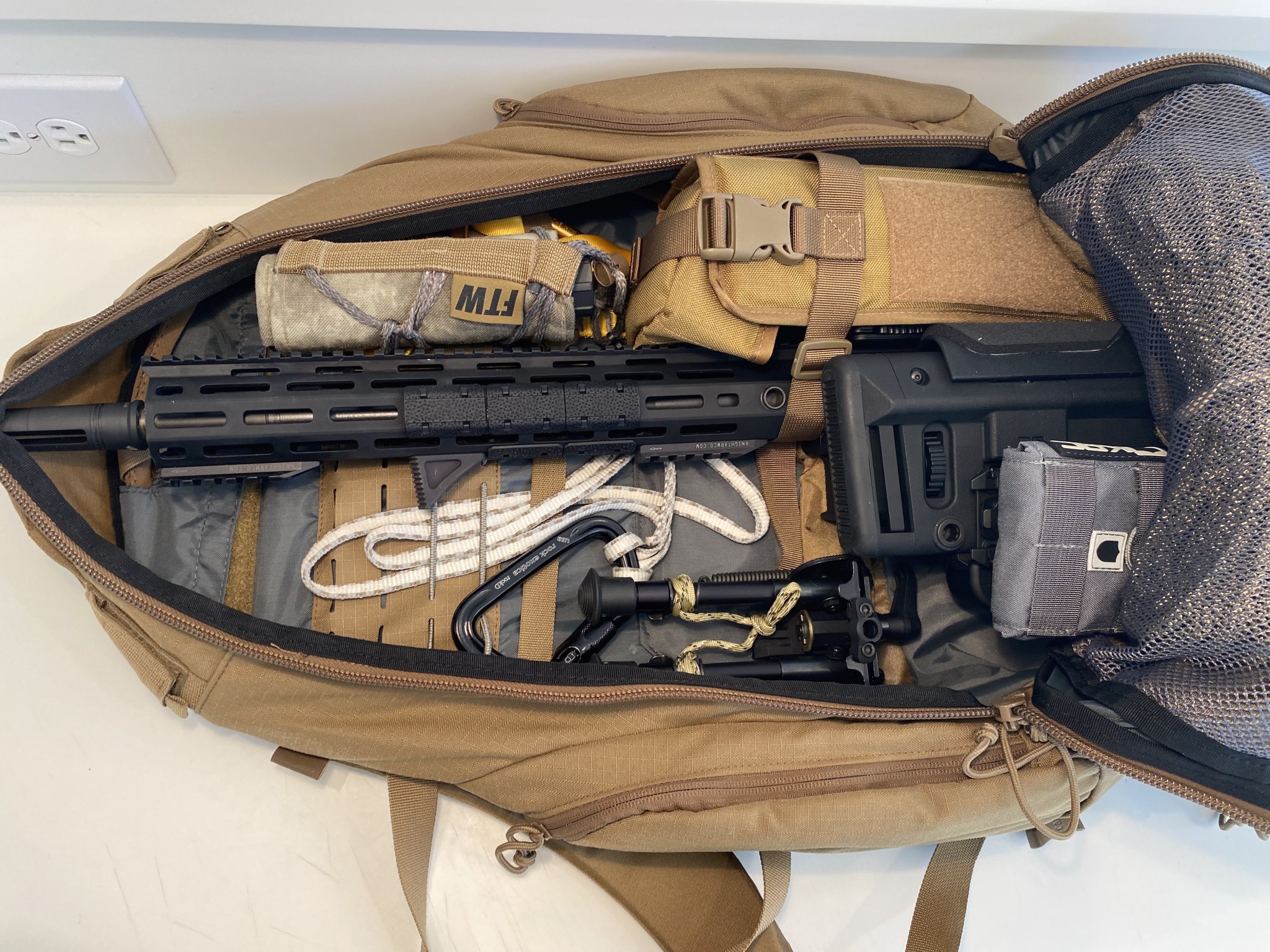

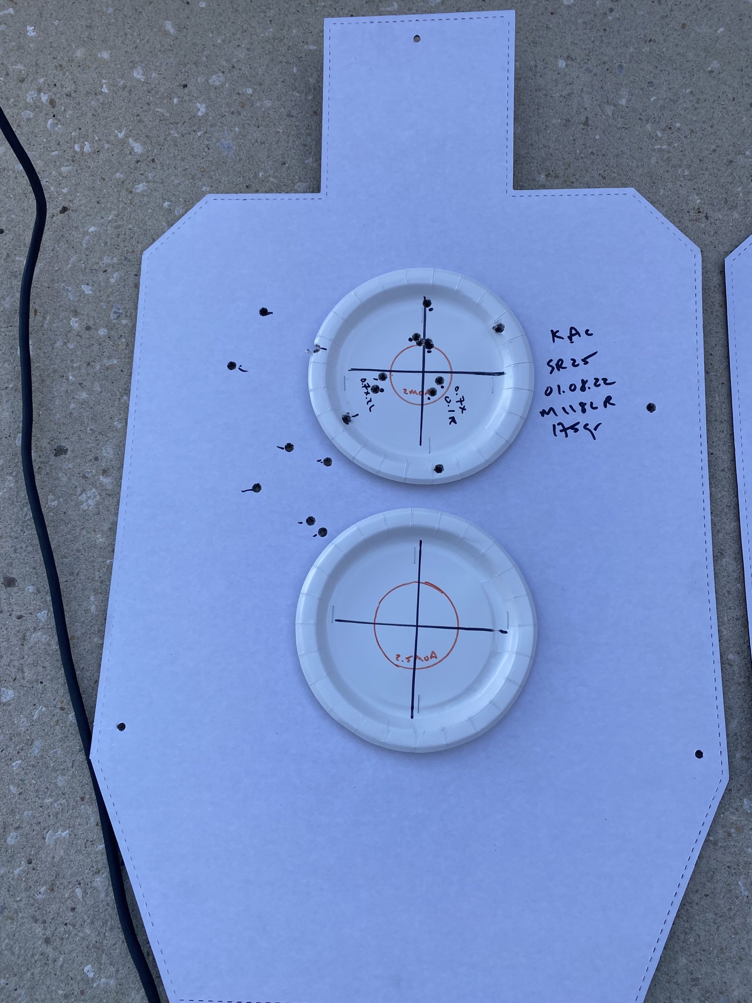

Finally finished sourcing all the kit for this 14.5" KAC SR 25 SBR, 1:10 RH late 2021; would like to shoot it 300 - 400 meters. I have about 175 rnds thru it so far getting some data with M118LR last weekend. I have ~10-12 Law Gen M3 folders that all work perfect. Still looking for a KAC 31693 NOS bipod! there was one on ebay a couple of months ago, lost the bid @$1500 with a few seconds to go! Easily fits in a common pack.
IMG_1720Cracker Swamp KAC SR-25 01.08.222ND SESSION 25-50-100-150-200 METERS copy.jpg
IMG_1734Cracker Swamp KAC SSR-25 01.08.22 2ND SESSION 25-50-100-150-200 METERS copy.jpg
IMG_1735Cracker Swamp KAC SSR-25 01.08.22 2ND SESSION 25-50-100-150-200 METERS copy.jpg
