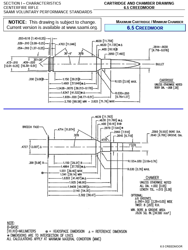

    There is a 3 thou difference at the base of the case and .200 line between new and resized brass, and 1 thou difference at the B datum
    Resized cases measure .471 right at the base Vs .468(new case) and .470 at 200 line Vs .466(new case)
    B datum line is .463 Vs .462(new case)
    Would small base die be able to squeeze that old brass into normal spec?

    Those measurements are still in spec compared to SAAMI. Do like RTH said, sharpie a resized case and chamber it. See where the rub marks are then come back.

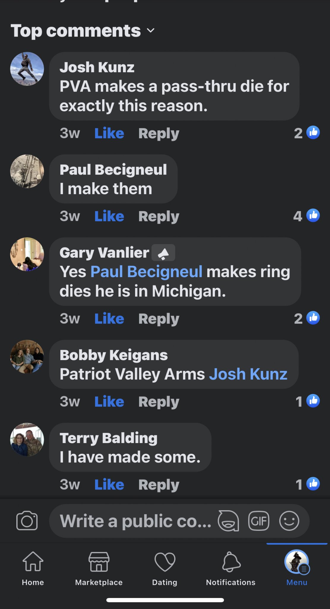

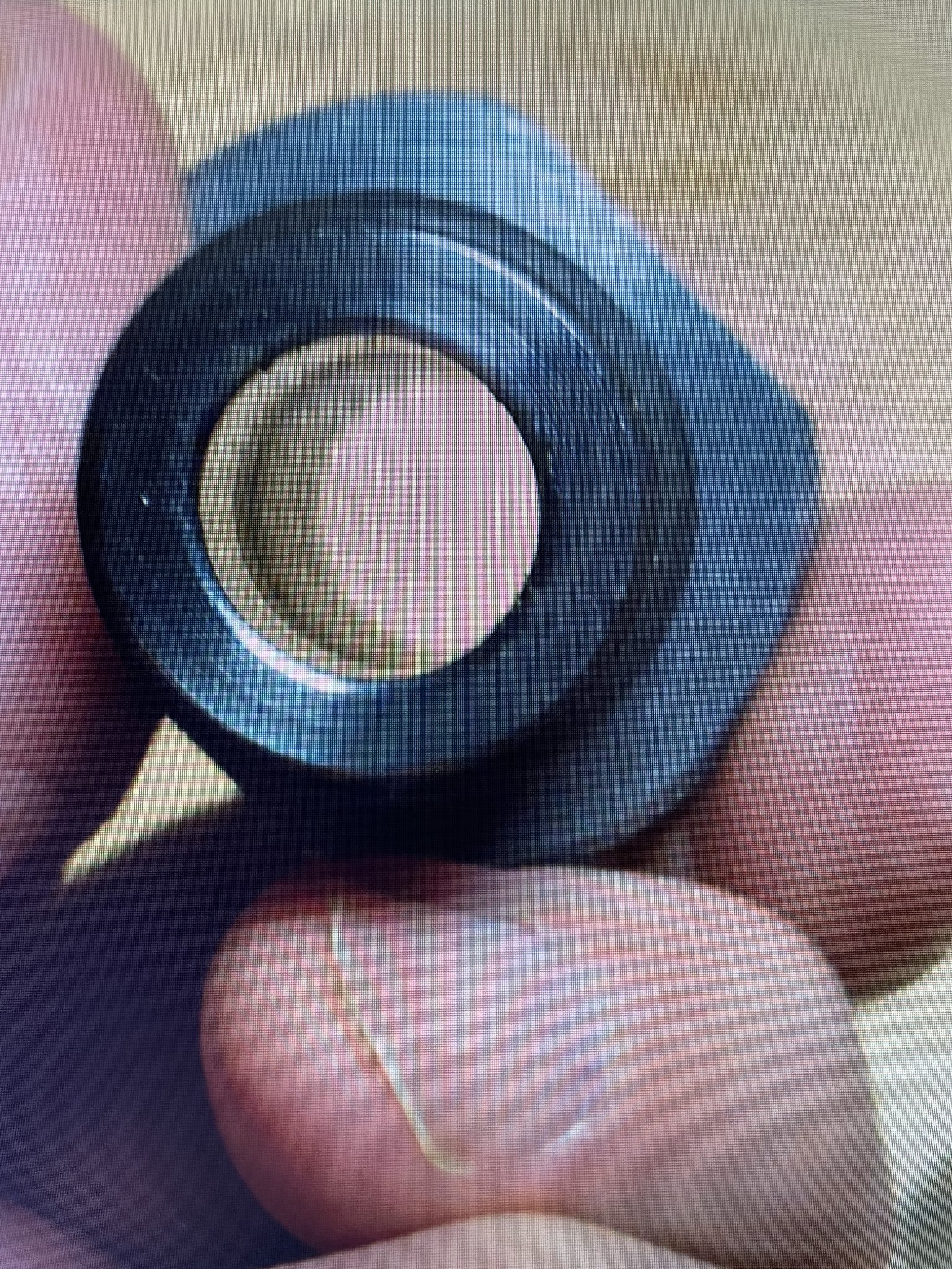

    Small base dies size the entire case back to factory and really works the brass hard to get the base down to size. Get a ring die to just size the base only.
    Check out pbike on accurate shooter forum for a ring die or Paul on the FB posts
