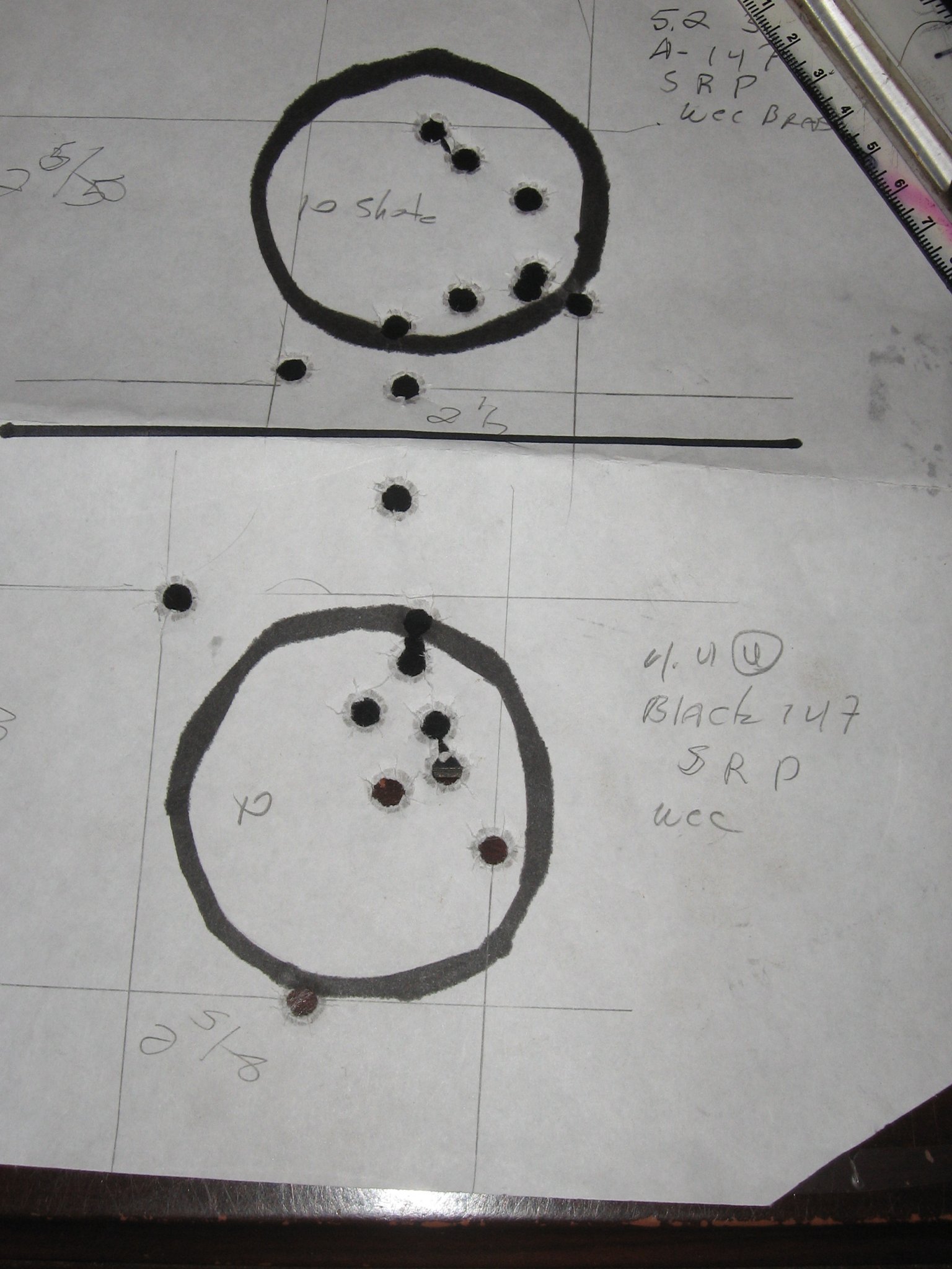

For what's worth I've been loading WW SRP's for my 9 MM's for a while W/O any problems. I use them with Unique and powder coated 122's & 147's Both loads were shot from a Canik TP9SFX with a 3MOA red dot at 35 yds.
In other tests I could not see any difference between the Fed. SPP & the WW SRP
