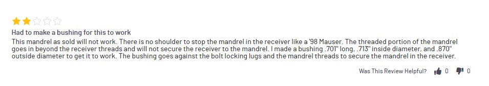

    I have a Brownells receiver facing mandrel that I bought years ago. I always thought I'd be the one to do the work and so I slowly bought tools to work on them. I have 4 receivers total. One tool I don't have is a lathe. Which is the most important tool.
    When I received the mandrel and threaded it into the receiver, I noticed they made the tool wrong. In my opinion. As you screwed it in, it was not threaded enough to hit the bolt lugs and stop. It was threaded about the length of the receiver threads. So eventually as you turned it in, it would thread all the way through the receiver and pop out inside and then the receiver would slide along the mandrel sloppily. So a guy turned a collet that would stop on the bolt lugs and provide the hard stop for the mandrel to lock up against while still engaged with the receiver threads. I hope I explained that well enough. If not, I can draw something up.
    Long story short, I have a mandrel. I will check it out.
    Reactions: ZG47A
    As I read the reviews on Brownells site, it appears someone did the same thing as me.
