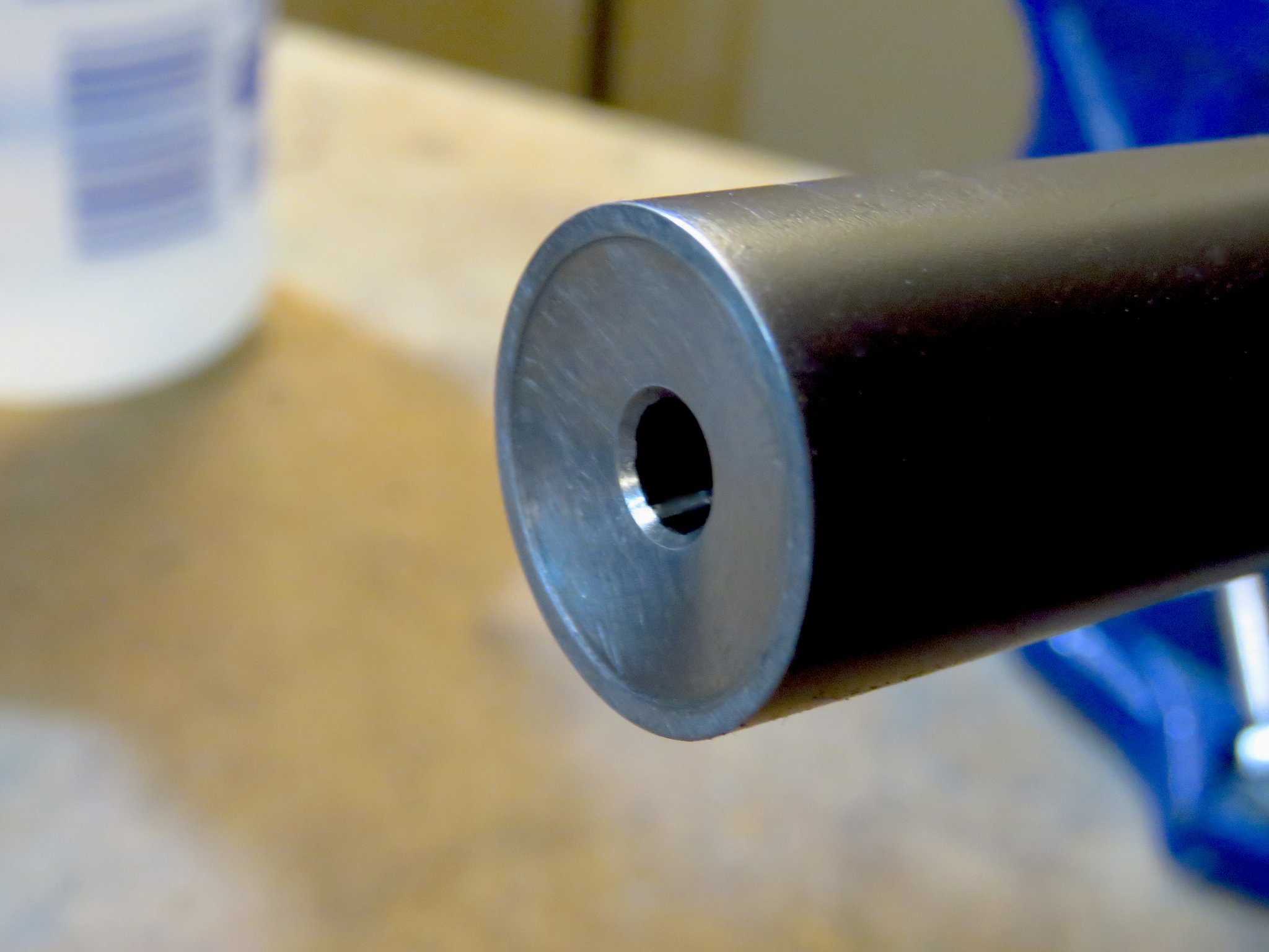

I agree depending on the application I don't have a problem chopping and recrowning a barrel myself. I've done a couple of shotgun barrels and a rifle barrel, which all came out pretty good using some hand tools from Brownells. Threading a barrel is a whole different ball of wax though, that's something I'd prefer to have a gunsmith do to make sure everything is concentric to the bore.
This is a .223 barrel I chopped and crowned myself before I cleaned it up and applied some oxpho blue.

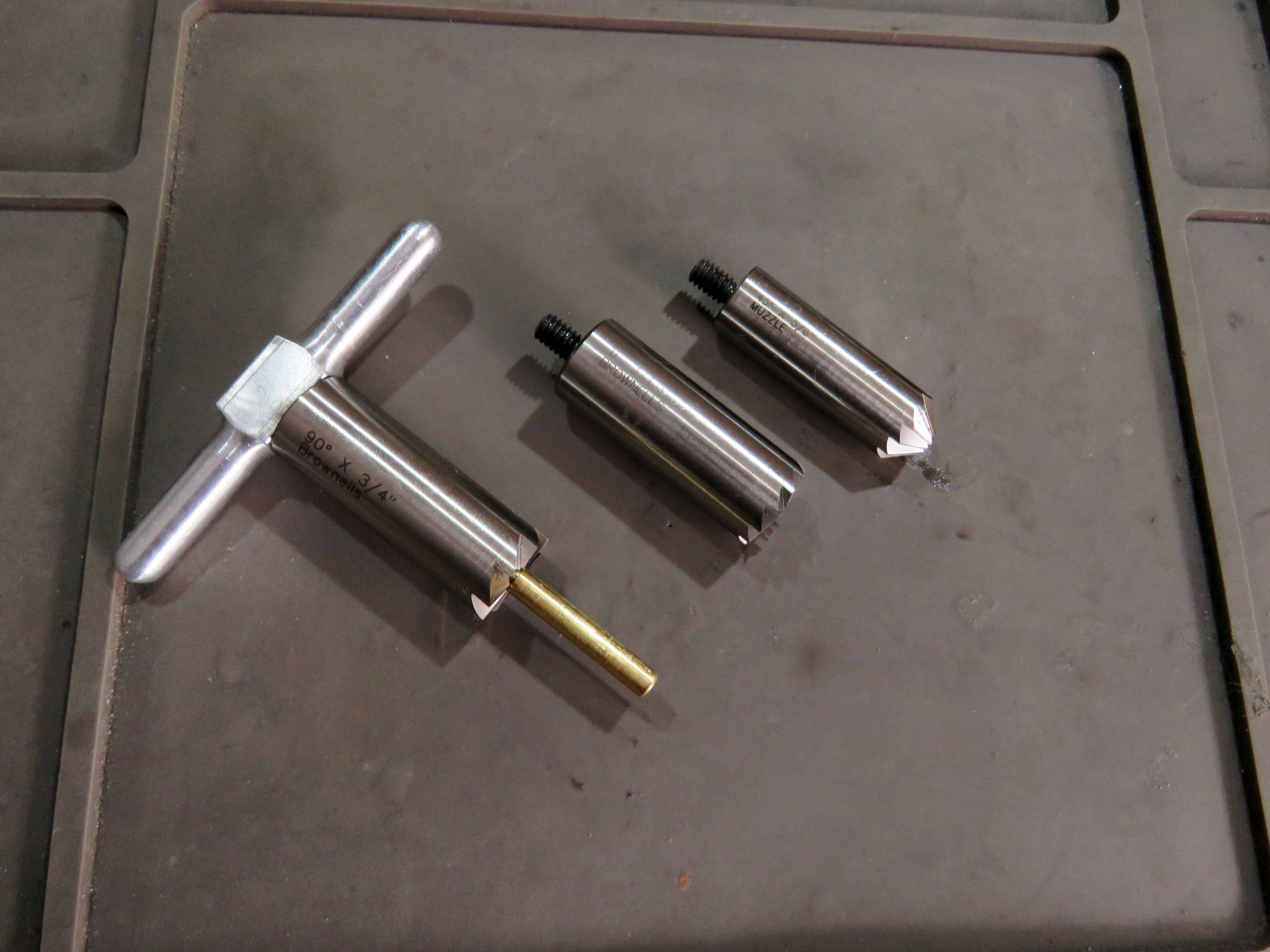

This is part of the Brownells kit I use. I've also used to repair the crown on a Remington 700 AAC-SD that got dinged up.
Nice job.
Should doing it myself be a consideration? I’m cutting the rifle down to make it easier to handle hunting. There’s not enough recoil to make a brake a necessity. Or would the cost of the tools rival the cost of having it done by a good gunsmith?
I got the tools because I wanted to learn how to do stuff like that on my own. A cut and crown job in and of itself isn't expensive and by the time you factor in shipping both ways, it'll probably be about the same as buying the tools and doing it yourself. Cutting just one barrel down? Probably not worth it. I've used mine to cut a few barrels and fix another one so it's already paid for itself IMO.
