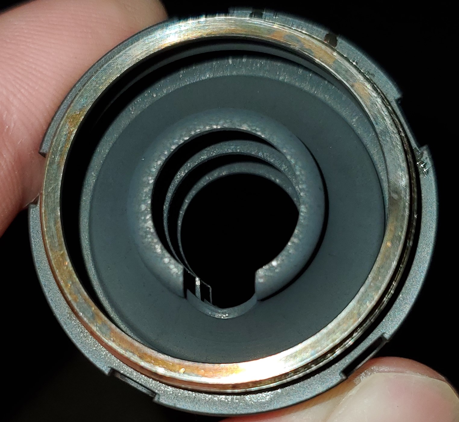

Just received this suppressor (SiCo Hybrid 46M), put it on my 11" grendel AR to start out. I shot 30-40 rounds at a slow pace. It was working fine, until I noticed smoke/steam coming out the endcap for a solid minute. I'm pretty inexperienced, this isn't normal is it?

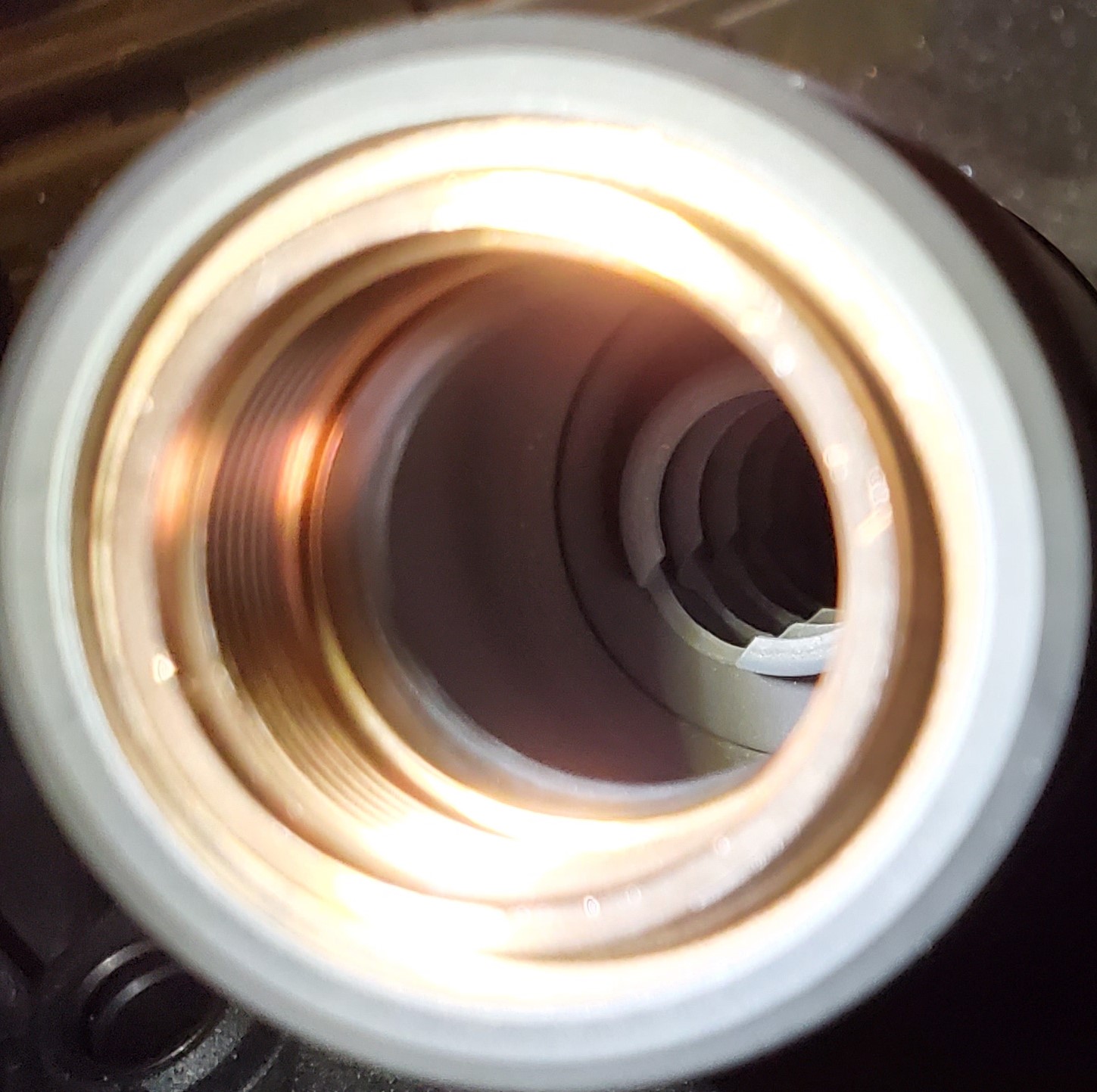

When I got home I looked through it and noticed something on the baffles, but only in the removable extension. I'm attaching pictures, first two are of the extension, third is the mount-side baffles which look unaffected. Did I fry off the finish from the stellite? Or is this just carbon fouling?
I'm multitasking too much, completely overlooked the possibility this suppressor isn't made for 6.5g in such a short barrel. The manual does not list a minimum barrel length restriction for 6.5 grendel (or many other cartridges), but if I was more discerning I would have tried to ask SiCo first.

Your fine. Keep rocking. Suppressors can be glowing red hot and be fine for a while. If you don’t have full auto capability you can’t tear that can up.
Reactions: Bluedog82
Being that the 6.5 Grendel is much larger than a 5.56, but smaller than a .308 Win, I'd say a happy medium would be barrel length somewhere in between the recommendations. So, I wouldn't go less than a 13" barrel 6.5 Grendel with your can, just to stay on the safe side of the warranty. You probably need a can more suited towards your needs, that's rated for short barrels and such.
As for smoking, that's normal, especially with a brand new can.

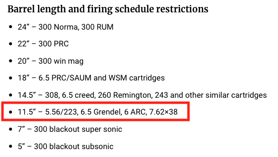

For the best performance, out of what I listed, the Otter Creek Labs Hydrogen-S or Hydrogen-L will get you some amazing results. They even offer them in a 6.5mm bore diameter for maximum DB reduction. And it's rated for down to 11.5" 6.5 Grendel. 👍🏼
Here's the Otter Creek Labs barrel length restrictions right off their website for the Hydrogen series suppressors.
I have both the L and S, and have shot them on my 20" 6.5 Grendel, and they sound amazing. The L is obviously quieter, and makes for an amazing lightweight and quiet precision and hunting rifle suppressor, and if you want slightly shorter, but still a VERY quiet can for it's length, the Hydro-S is also a VERY good sounding suppressor, and one of the best .300 BLK suppressors I've tried to date. 👍🏼

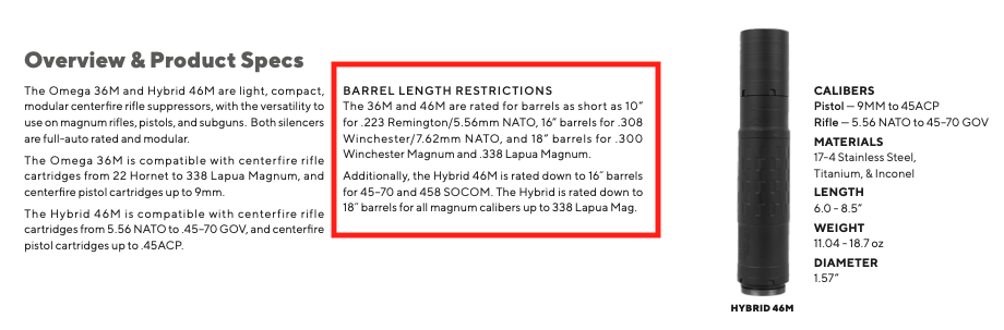

But a couple of days ago I was looking at their site and found a 2022 catalog.
https://silencerco.com/wp-content/uploads/2022/01/catalog-2022-web.pdf
Page 30 has a barrel restriction chart. It shows 10" for 6.5 Grendel with an Omega 300. Also shows 10" for Hybrid 46M. :unsure:

I contacted Silencerco about barrel restrictions on an Omega 300 with 6.5 Grendel. I have one with an 11.5" barrel and another with a 12" barrel. They replied
"We generally recommend 12 inches or greater for supersonic 6.5 Grendel with an Omega 300."
I plan to use the Omega with my 11.5" barrel once it is out of jail.
That is handy, thanks, especially for a more comprehensive list of cartridges. But I'm wondering if that 10" might be a typo or outdated since we were both told 12"
I would suspect the rep that said 12" might have it wrong. I might contact them again for clarification. But Silencerco does have a lifetime warranty and it does say 10" in an official publication, so I would say send it. I doubt 1 or 2 inches will make much difference. That's what I tell my wife anyway.
