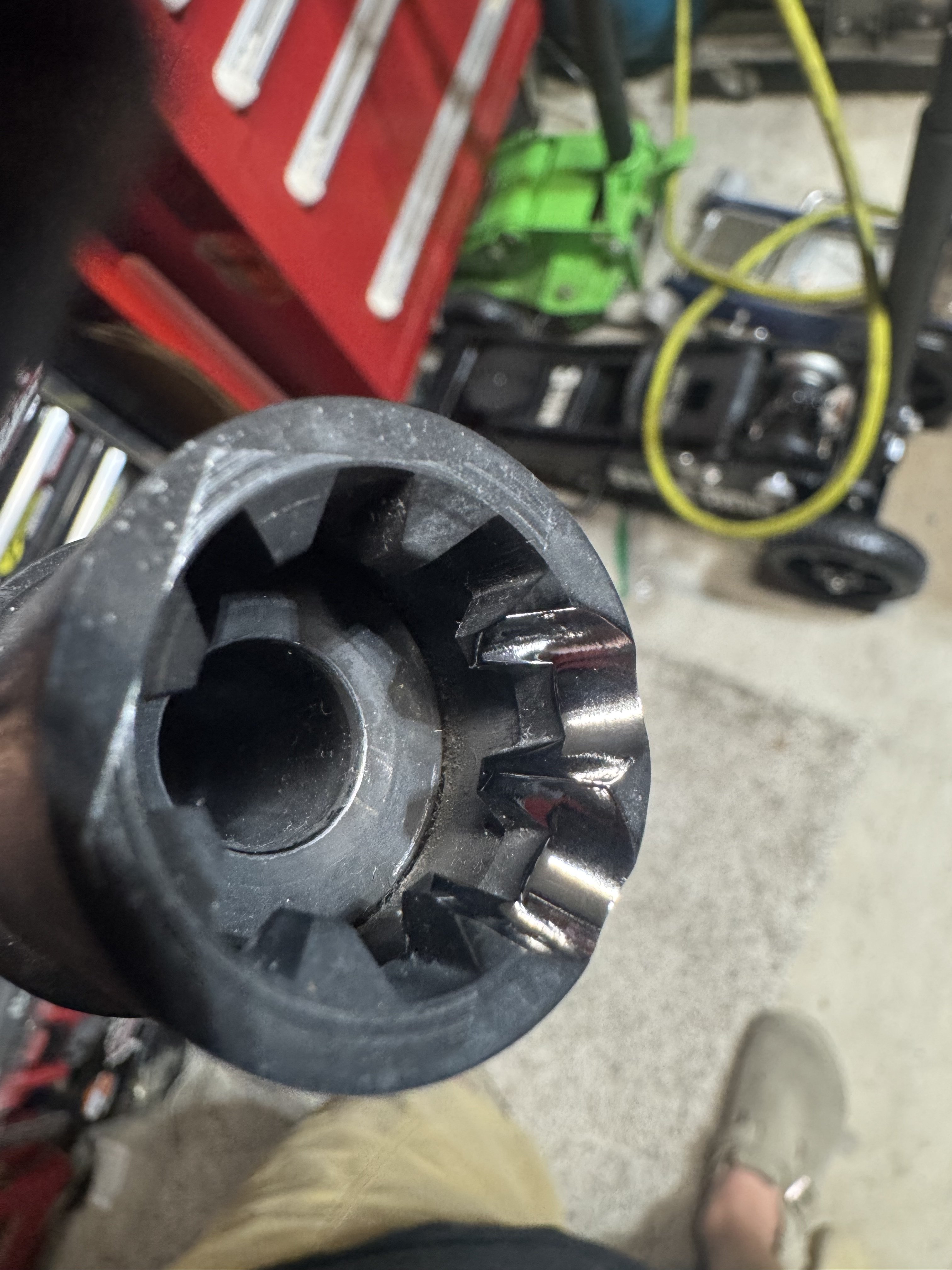

Got a Wilson Combat AR barrel and it scores/scratches the brass on the neck and bit on the shoulder of the fired case upon extraction/ejection. I can chamber and eject lives rounds and it doesn't happen. It's only on fired cases, so it's happening on the way out.
I think the barrel extension lugs are sharp at the 12 oclock. Thinking just using a piece of sand paper with my finger to smooth the back sides of the lugs a bit.
Possibly a better way? Thoughts?

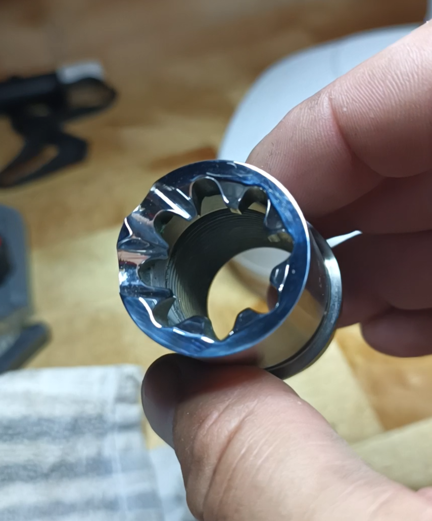

The vampire neck effect is from the leading edges of 2 lugs in the extractor clock position during the extraction and pivoting force caused by the ejector, countering the purchase of the extractor lip on the other side of the bolt.
As the spent case withdraws from the chamber and the neck clears the breech, the ejector forces it into the lead edges of the barrel extension, causing those gouges.
iu
You can deal with it in several ways:
De-edge the corners of the lugs in that clock position.
Reduce ejector spring pressure by shortening the ejector spring or using a lower power ejector spring.
Reduce cyclic rate with adjustable gas and action spring weight.
The main concern for reloaders is obviously split necks from continued gouging and re-sizing/firing.

That's exactly what they look like.
