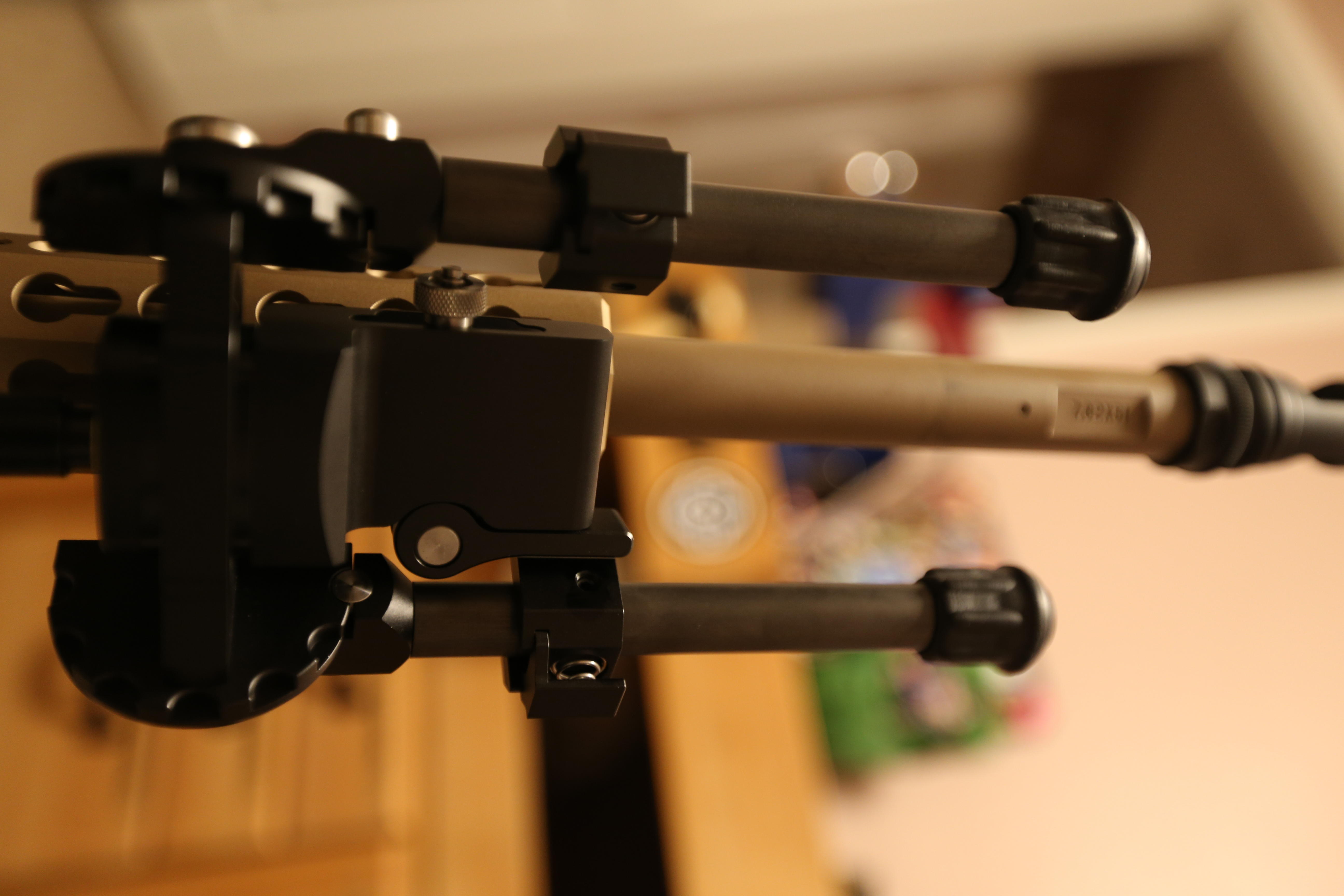

It's no secret that I'm a big fan of the LRA bipods, I have owned or currently own almost every bipod on the market including the Sako, Atlas, Parker&Hale, etc.
My biggest comment to LRA's owner, Dave, has been "size size size" even though I've been using his bipods in matches exclusively since 2011 and doing pretty well at it.
Here's what he came up with:

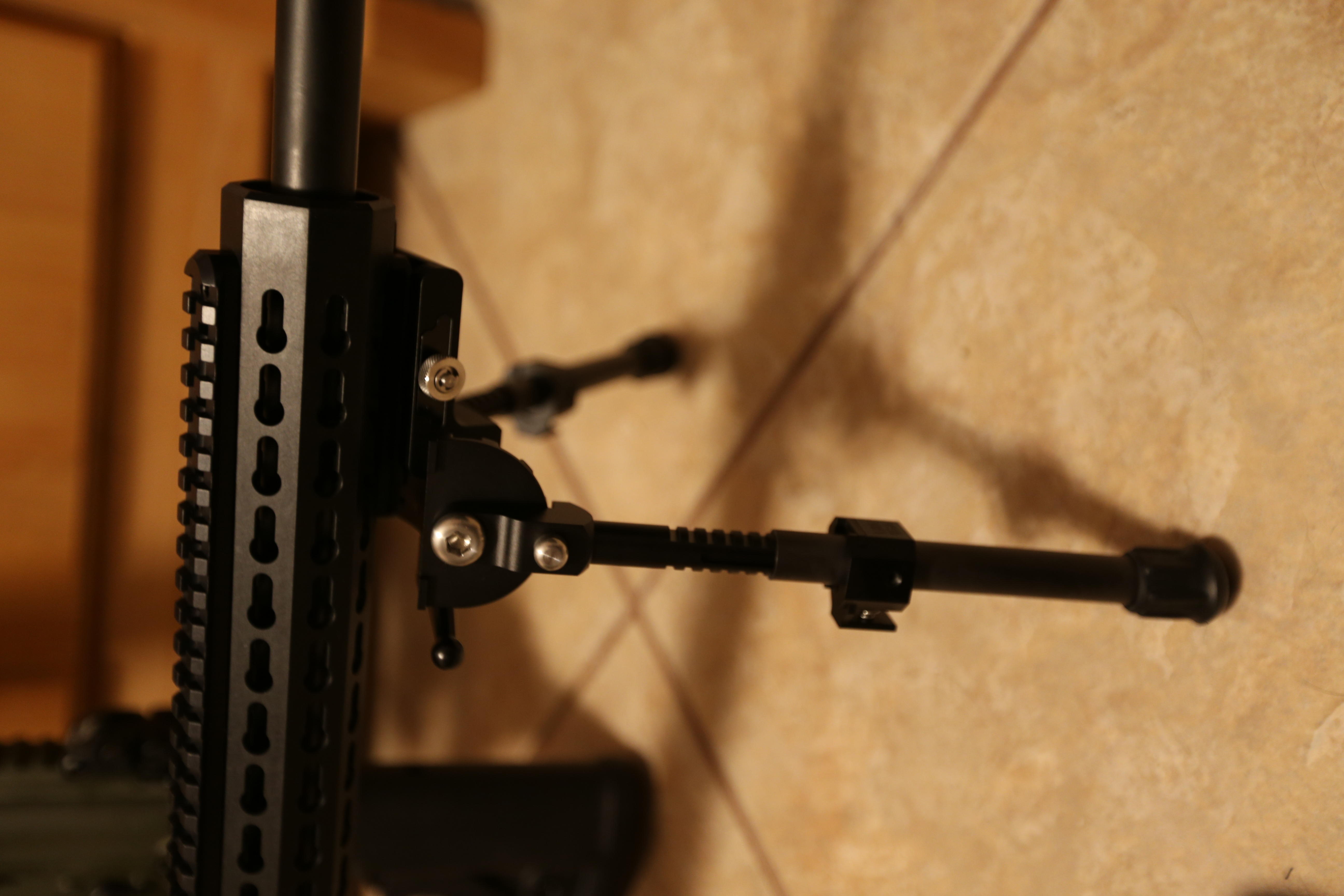

Same super stable design concept with a reduced form factor and weight, pull-truded carbon fiber leg tubes helps cut some additional weight. The new version is <1lb (my bathroom scale says 0.7-0.8 difference). This bipod will only be offered with QD lever, there's no downgraded option for a screw-on clamp as I understand it. The outer leg tubes still do not rotate just like the bigger version, which is something that I really hate about some of the other options out there.
This new version has the ability not only with the 0, 22.5, 45 and 90 but to fold backwards in the same angle increments as well.
I don't know what pricing will be, this is an advance copy for T&E since I've been railing on the LT's for a couple years and have provided feedback as I could. You can see from my LT in the photo below it's no safe queen (actually, it has somewhere north of 24,000 live rounds fired from it). I'll be putting this on through it's paces soon, I need to get to the range, working through it in the garage it feels excellent as usual and the fit and finish is second to none.
They're available after SHOT show, as I understand it there are some floating around SHOT next week at Surgeon, Ashbury, and I think AI's booths.

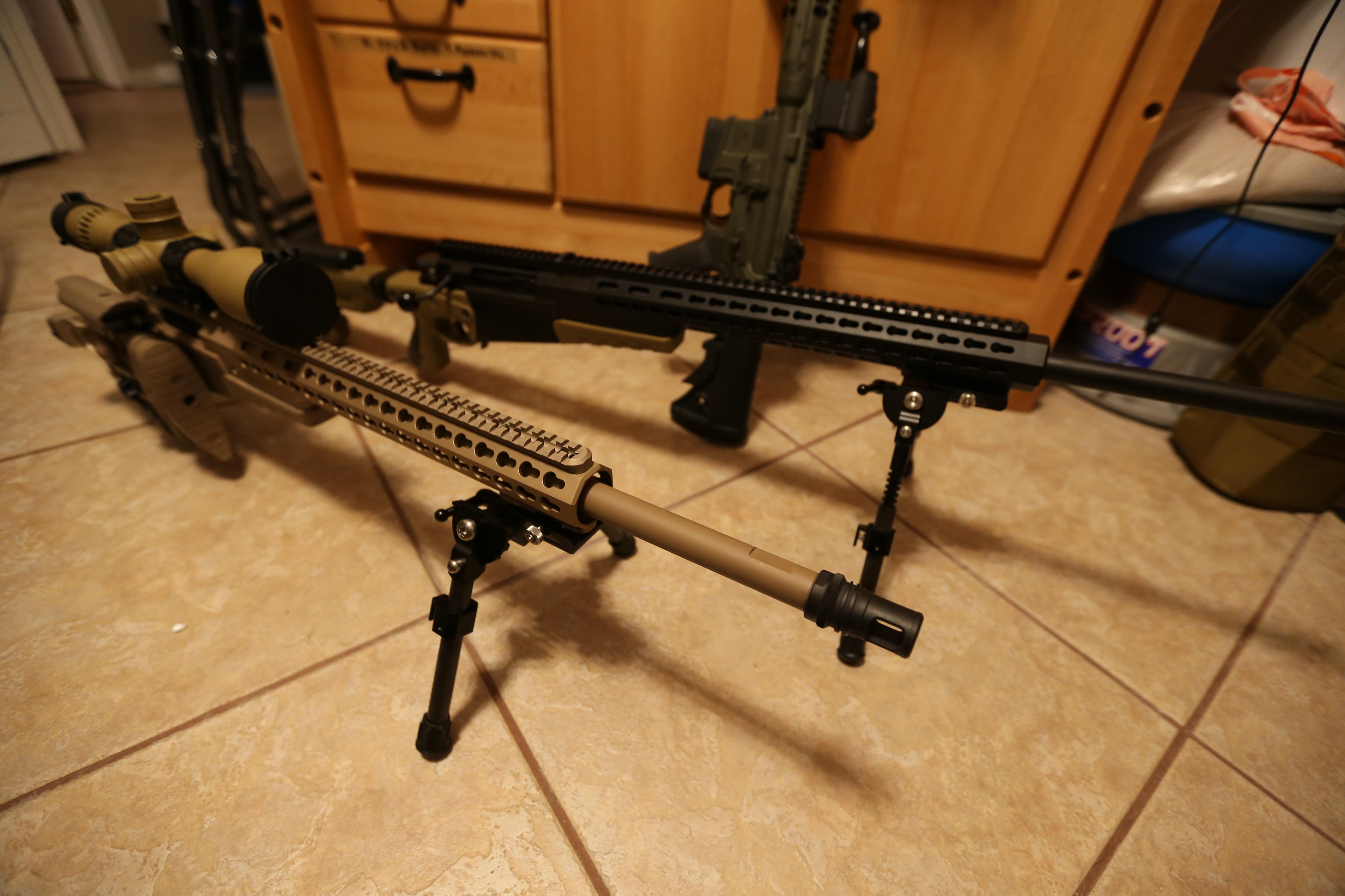

For comparison:
My full size Light Tactical, the new compact bipod, and an Atlas V8 screw mount
And some other assorted shots of it mounted to the bottom of my 6.5 Creedmoor "everyday" rifle

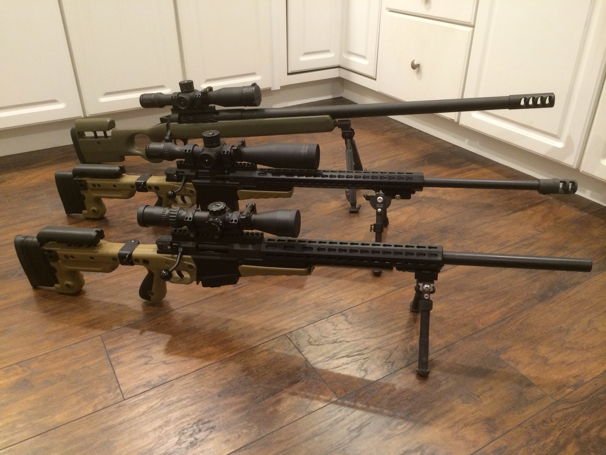

Thanks for the photos, guys. I'm giving one shot, should be here next week. I like my atlas bipods a lot, but they've never been exacoy what i want.
Shot with it today on my AX338. Pretty badass. Havent had it out in the rough yet, just doing some load development from my porch, but i like it a lot better than the atlas so far.
Does it give you enough elevation for a wide variety of positions with your AX? Some pics would be great if you have some. Trying to decide between this and the F-Class model on my AX 338.
Its hard for me to answer that question since i was just shooting from my flat porch to some paper targets. I like the lever for tightening and loosening the cant vs atlas' wheel. I like that the legs don't roll. i like the lower center of gravity and wider stance for an 18lb rifle. It may be a few weeks before I've put it through its paces.
It doesnt swivel and the tight tolerances mean its liable to lock up in a muddy competition. Its ~4oz heavier than the atlas and probably not quite as versatile. All this means I doubt I'd ever use it in a competition that involved more than shooting prone, but it may be nice to have the option and its nice to shoot heavier rifles from when the atlas just doesn't quite make the muster IMO.
I'm out of town until this weekend so I have only one photo that wont do much good. If you PM me your e-mail address I'll see if i can't send more and maybe a video when i get home.
