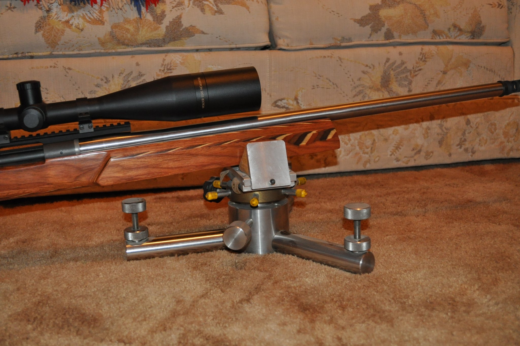

    One of the first projects I did after buying my JET knee mill was to build a stainless front rest from plans that the original designer let me use to make one for myself. I'd seen a review of this rest in Precision Shooting back in the late '90s IIRC, and always thought it was something I'd like to make for myself if & when I bought a lathe & mill. Anyway, I'd bought a bunch of surplus stainless at The Yard in Wichita, and no one there really had a clue what alloy the different pieces they had in stock were - I asked, they gave me a magnet. Guess that's how you tell 300-series from 400-series SS in a surplus/salvage yard. I got enough stainless to build two of these rests for about $45...try finding a deal like that today. Quickly learned not to peck at 316 - have your cutting oil ready, and plunge right on in there! That stuff work-hardens like nobody's business. Also learned the truth in what Nesika Chad/LRI said earlier in this thread - "When it comes to taps, you get what you pay for." Truer words were never spoken. I started buying Cleveland gun taps (also known as spiral point taps) when I got into this BR rest project, and have never looked back. I'm not saying that Cleveland taps are the top-of-the-heap quality, but they're head & shoulders better than the Hanson taps most auto parts stores carry. I've bought a few R&N taps in 6-48 & 8-40 over the past few years, and they're also better quality than most of the stuff that Brownells carries. MSC, McMaster-Carr, K&N, MariTool - those are some of the places I look when I'm buying taps. This isn't a good photo of the rest, but it's what I had, with a trued M700/Bartlein hvy Palma 6 Dasher in a Shehane tracker stock done in Indian Paint obeche stock. Rest weighs 26lbs, and I did all the knurling & threading on the lathe.
