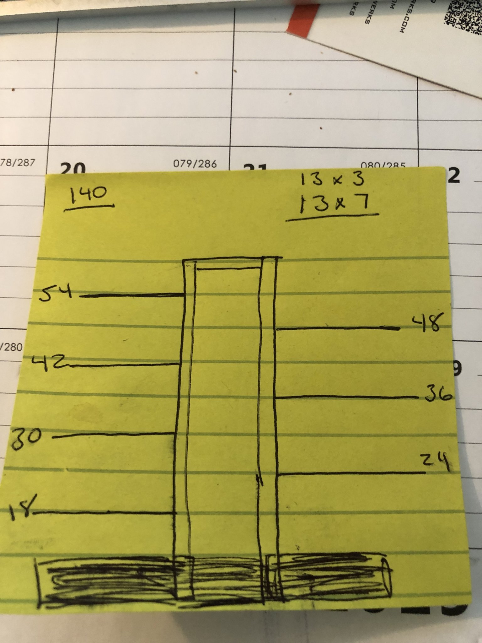

    So Home Depot has 24" heavy wall conduit for $14, with a 2x4 or even 4x4 you can simply drill a hole in it, use the conduit and you have a simply tree prop that mimics a barricade.

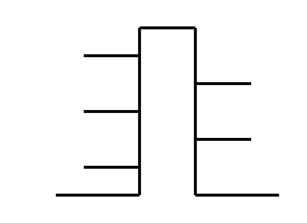

    At first, I thought about putting an arm every 6 inches alternating sides so you always have a 1-foot gap.
    Some noodling
    7043573
    The top can either be 60 Inches tall or it can be adjusted to 56" as it is now, then you scale down every 6 or 8 inches giving you maximum flexibility
    7043574
    The conduit would actually go through the wood so you have placement in the center too.
    With the steel ones I have seen, I think it is a good way to skin the cat with all the room being necessary.
    It's a work in progress and I might just run out and build it,
    Just thinking though, based on the conversation how would you change it ?

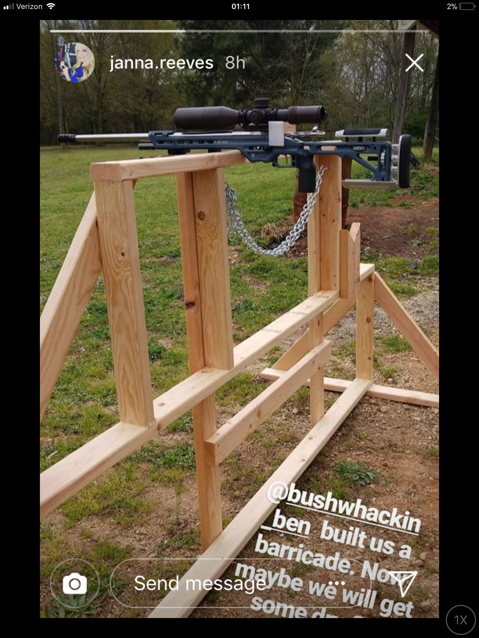

    I saw this a while back on Janna Reeves IG and was going to build similar for training.

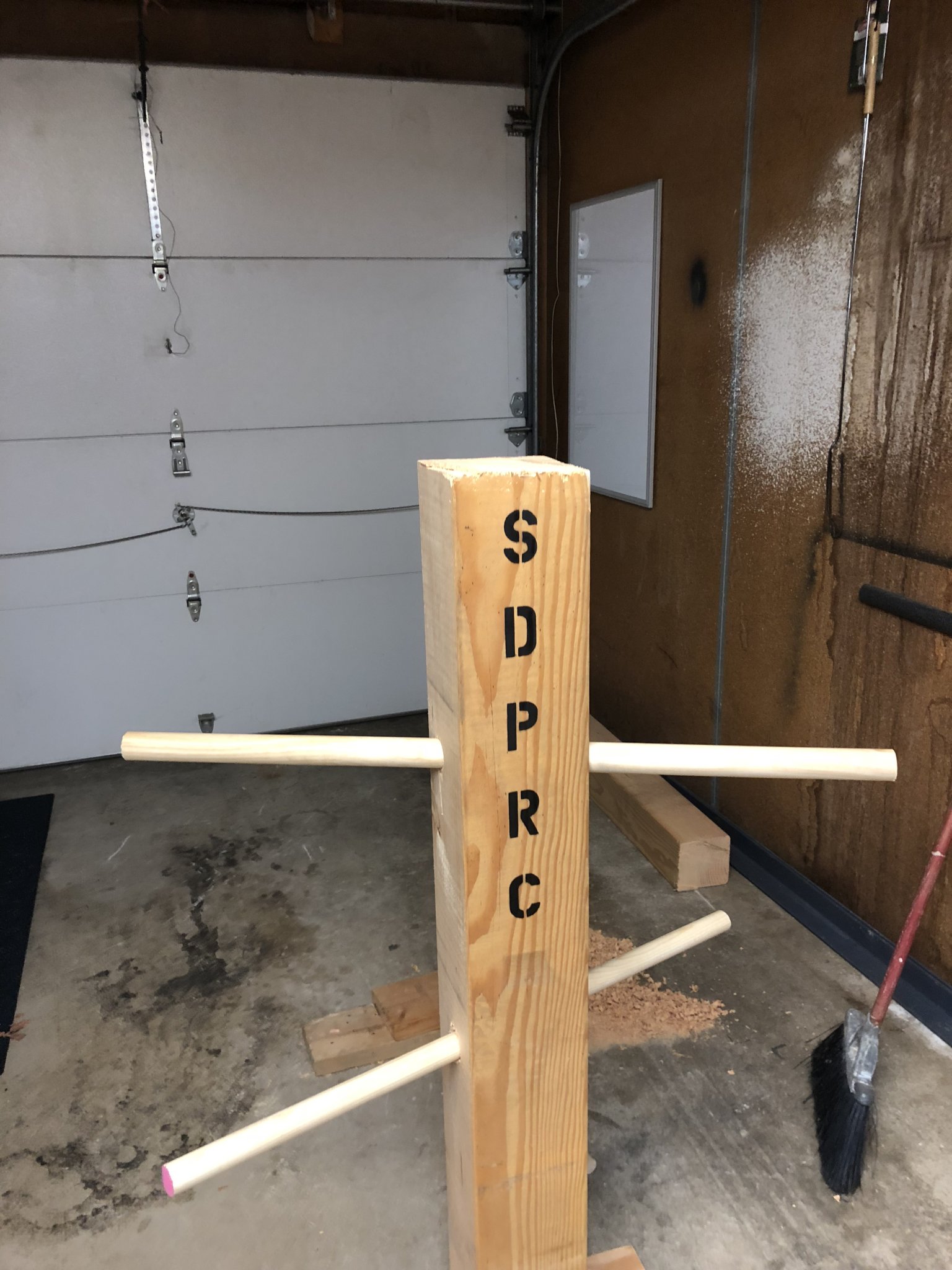

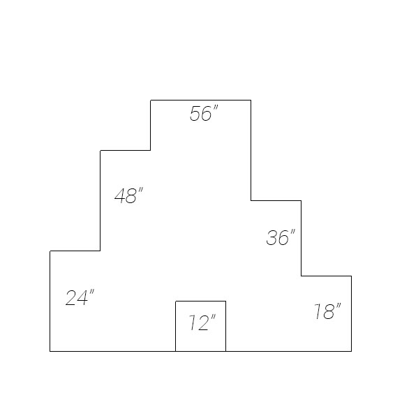

    @Lowlight, do u remember me messaging you earlier this year about your barricade measurements? This is what I did with them at the house on my 200 yard range.
    I need to throw some lag bolts on there to straighten and tighten them up. They've started to sag like some old titties.
    Lag bolts should shore that up nice, great simple design

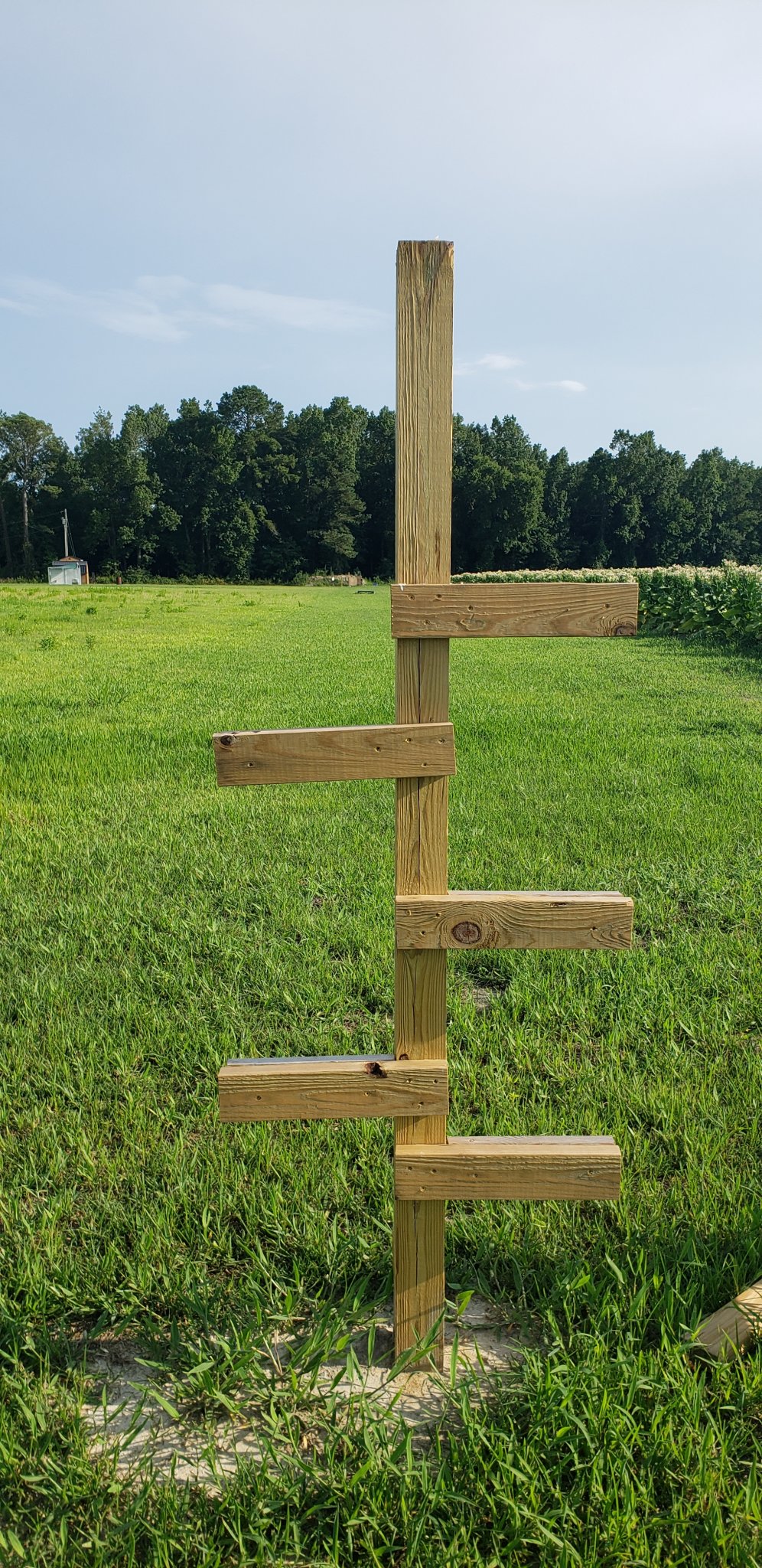

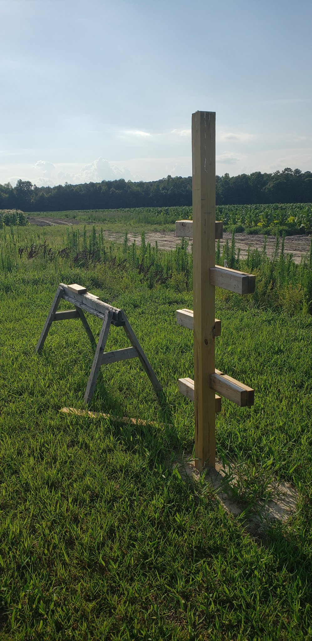

    theres a range Pigg River Precision that has a pole with welded pipes coming off each side. Spacing per side is about 1' difference per pipe from 6" off prone up to above my head (im 5'7). The 2 sides are staggered so really you have a position every 6" I believe.
    Its fairly new but it was 5 of any position you wanted, made it nicer for the varying heights and made you have to guess what were the perfect heights for your build/size.
    Liked it alot more than barricades.
