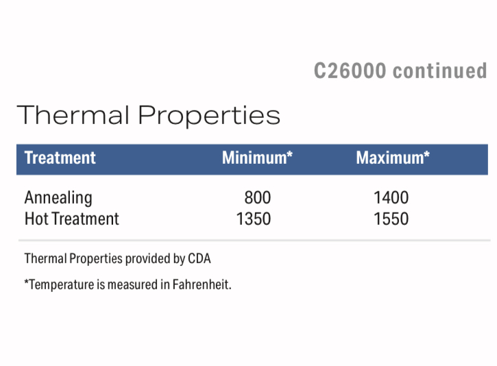

I'd say it should be dry! If you haven't looked up the figures yet, to anneal brass you need to get it in the neighborhood of 700 degrees. So your 425 degree drying cycle was not hot enough to change it.

At 425 F for 25 mins, there's zero chance of the cases being annealed.
At low temps of around 220 C which is 425 F, 70-30 brass has been measured to increase slightly in hardness during lab testing of the annealing process.
As long as you're confident that the brass didn't get substantially hotter, don't worry about crushing any of them, tells you nothing as you probably couldn't feel any reliable difference with pliers anyhow.
Even at 525 F, 25 mins is too short a time frame.
