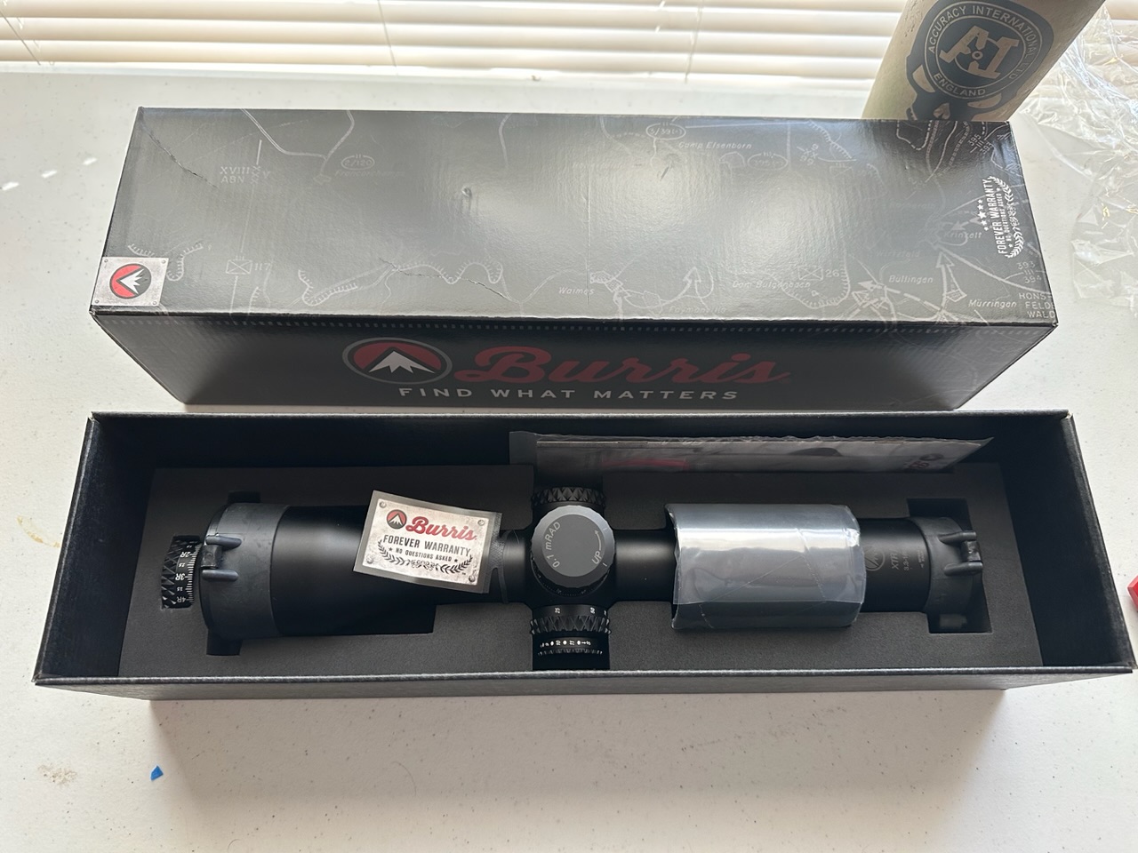

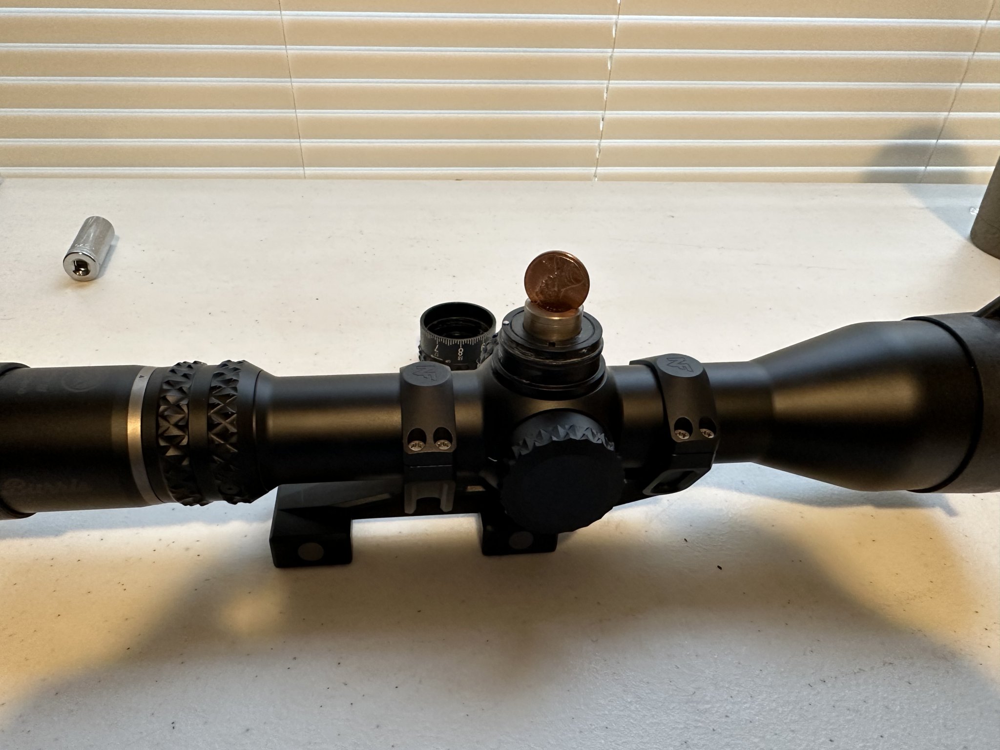

    So I bought one of these things to see what the hype is about, people are constantly comparing them to scopes costing $2K (and even more) claiming they’re as good or better. My only experience was shooting with one once on someone else’s rifle and I wasn’t very impressed. I tried to order one back in November but it was cancelled by the vendor with no explanation as to why. I came across one for under $800 delivered from another vendor so I decided to give it another try. I received it this morning and it’s indeed what it was supposed to be and not a refurb or blemished model like some retailers sell for similar pricing which I thought it might have been and misadvertised.

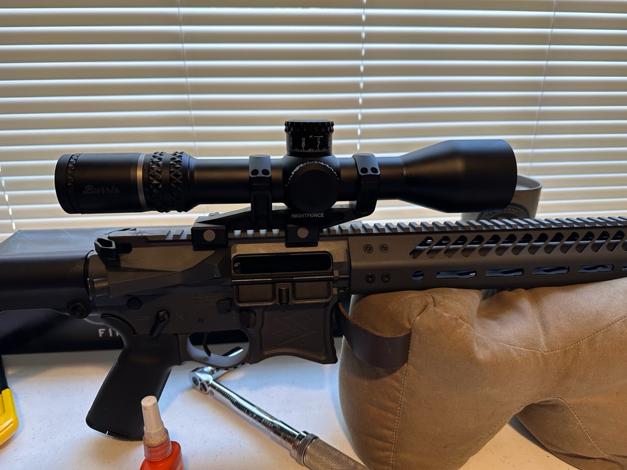

    I bought it to go on a 22 bolt gun but decided to mount it up on my Seekins 223 DMR that’s a known good shooter to test it out first.
    My initial thoughts are that it’s not bad but IMO comparing it to a $2K optic is a pretty exaggerated conclusion.
    The glass is better than the other sample I was behind and I can’t see any noticeable CA in it so far but I’ve only been checking it out for a couple hours so far and at my house where it can only look at stuff to about 600 yards. The eyebox is generous and doesn’t do any weird stuff or have distortion if you move your head around a little. FOV is very good too. SCR 2 reticle is a great design and this illuminated version is very good on the low end and I can tell it would make a great crossover options.
    The bad… There’s noticeable flaws in the overall build quality that is common with budget types scopes, and yes that is what these are. The knurling is absolute cheese grater status, I can’t imagine how bad the US made models that are supposedly worse must be.

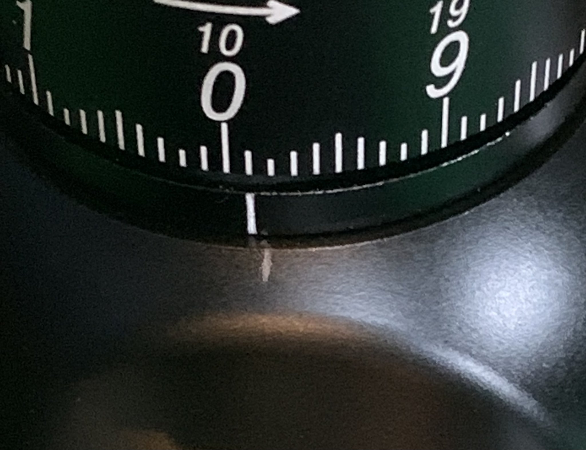

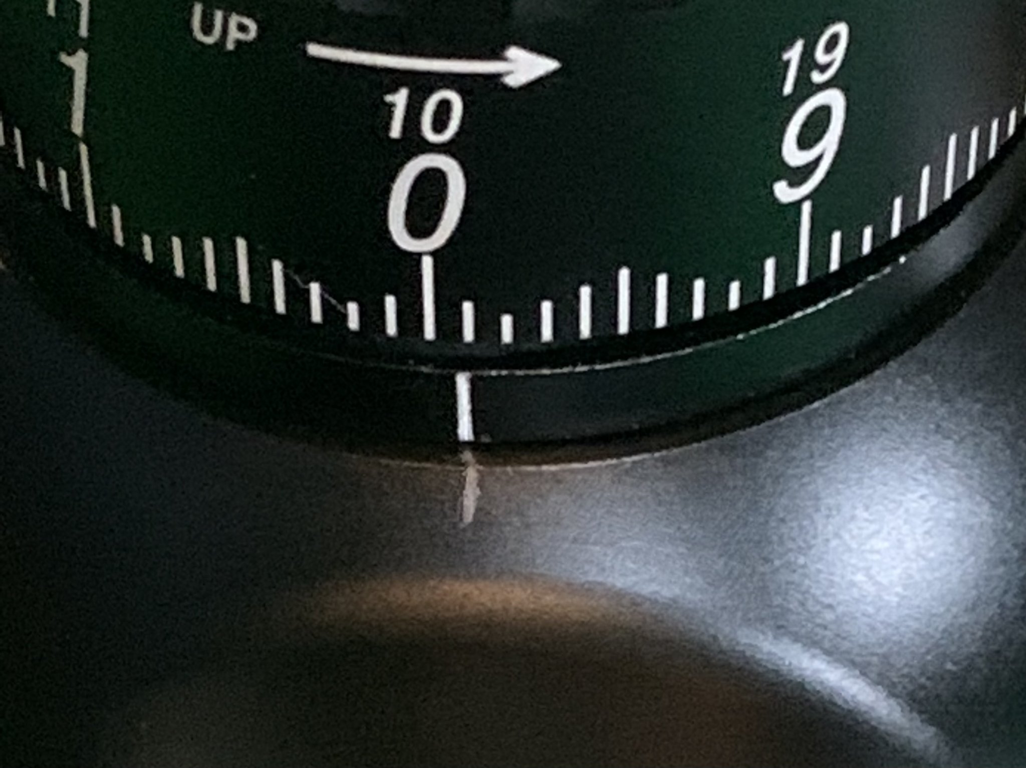

    The most noticeable thing is the play in the elevation turret, it has .05 mil of play so when you’re dialing up it basically goes half way to the next mark on the turret than what your actually on, you rotate back a little and can feel the detent. It’s honestly pretty bad and I would describe as very sloppy. Other than that the elevation feels nice, great tension, feel of the clicks, and audibility. If it wasn’t for the slop that’s on the extreme side I’d give it a 10/10 but the slop is bad enough I’d say it’s a 5/10.
    The windage turret is stiff and mushy at the same time and almost non audible and you can barely feel the clicks. If I was going to put the external knob on I would care but I don’t dial wind so as long as it tracks to zero it I couldn’t care less what it feels like. Some people are very picky about their windage turrets but I’m not. If it cost twice what it did then I’d expect it to be better. It did come with the extra windage turret.
    The parallax is stiff but not as stiff as the other sample I used. It’s acceptable but could be better. It’s not smooth at all when turning it and feels different throughout its revolution. The illumination knob cap sticking out beside it is like a circular saw blade. Really dumb design.
    The magnification ring isn’t too stiff, I’d say just a little stiffer than just right so it’s not bad as far as that goes and better than the other sample I used which was very stiff. It’s pretty rough though. It feels almost gritty when turning it and it’s not an even tension throughout the range, it gets easier and stiffer as your turn it much like the parallax. I’ve worked it a good bit thinking maybe grease needed to be dispersed around in the erector but it hasn’t made a difference.
    Overall for what I paid it’s not bad so far. This thing absolutely is not on par with a MK5, NX8, ATACR though that they constantly get compared to other than having a nice eyebox and maybe the glass being close (definitely not superior). On every sample of those mentioned optics I’ve used they have all had great feeling turrets with no play, proper tension on the controls and were smooth.
    I’ll be shooting it tomorrow at the local range and will have it at a 1000 yard range in the next couple weeks to see how it tracks and how the glass holds up through mirage and heat and how the DOF is. I’ll update this thread with any problems and periodic updates at probably the 6 month and 1 year mark. I plan to keep this thing long term to see how it holds up to see if it has better reliability than the other Phillipino optics that I’ve had which has been pretty disappointing.

    Range updates. I’ll update this reply to include range updates for the optic.
    2/2/24: Initial zero and some groups at my local 100 yard range. The optic tracked accordingly to what the reticle showed to zero the optic in two rounds. This isn’t a tracking test at all but it shows the reticle and adjustments are true. It has 19.5mil of travel left with a 100 yard zero in a 0MOA mount which is very good IMO. A 20MOA would get roughly 25mil on this setup. I shot the rifle at different magnification settings and it doesn’t change POI. I’ll do a tracking test at some point, but so far it seems to be solid mechanically.
    I played with the parallax knob and magnification ring more in between letting the barrel cool and shooting the other rifle I brought. The parallax knob is now even tension for the full rotation and is completely smooth, it’s still a little bit on the stiffer side but it’s acceptable. The magnification ring is also better as far as even tension throughout the revolution. It still gets a little easier going from 12-18x but not the opposite direction but it’s far less noticeable. The grittiness has gotten worse though, there’s definitely debris of some sort under the magnification ring that it’s trying to eat. It’s also much more audible now where initially out of the box I could feel it more than I could hear it.
    Setting the elevation turret to split the slop to .025 mil so it’s even on each side of the turret marks makes dialing and reading what click it’s on basically a non issue. The slop isn’t great but given the price stuff like this is reasonably acceptable and it could be worse so I can’t hate on it too much since splitting it took care of the issue of being able to easily visualize what is dialed. Other than the slop the elevation turret has the perfect combination of a clunk and snappiness in both the feel and audibility to what I like.
    The glass quality is very good for the price. The only other optic I brought to compare is my Leica Amplus 6 which really isn’t a fair comparison because it’s substantially better glass in every aspect. The Burris is very bright and shows colors great and it has a great FOV as reported, certainly above average. Where it falls short though is resolution. It’s good for its price point but it definitely lacks great detail when looking at bullet holes in the paper target, blades of grass, tree leaves, and so forth. There appears to be some CA but I’m not someone that CA bothers much or really notices it unless it’s either really bad or I’m trying to see it. Unless I come across a situation where it becomes more noticeable or an issue I probably won’t comment on it any further than saying it’s ok I guess and would refer looking at the @Glassaholic review for better feedback on CA.
    Overall for two days of having it and one 100 yard range session I would would say the optic is very good at its price point assuming it remains reliable which is going to take a while to prove. I’ll reserve judgement on other optic comparisons until I get it side by side and also have some other people evaluate them all as well.

    In reference to the turret being 0.05 MIL off, I noticed that on several of mine, the distance from the zero stop to the first click is very close. But I found that when resetting the turret, if I pushed continuous downward pressure on the turret and kept it twisted tight up against the ZS pin as I tightened down the set screws, it took all that away.
    Not sure if it will help with yours, just thought I'd throw that out there, as I noticed that on mine, because the XTR turrets have a very high suction inside of them. You notice this when you unscrew the set screws, and the turret pops up on its own. None of my other brand scopes do this, but all my XTR's do. Which is why I thought I'd mention the continued pressure while tightening the screws. It helped mine, and I haven't had an issue since I started doing that on them.

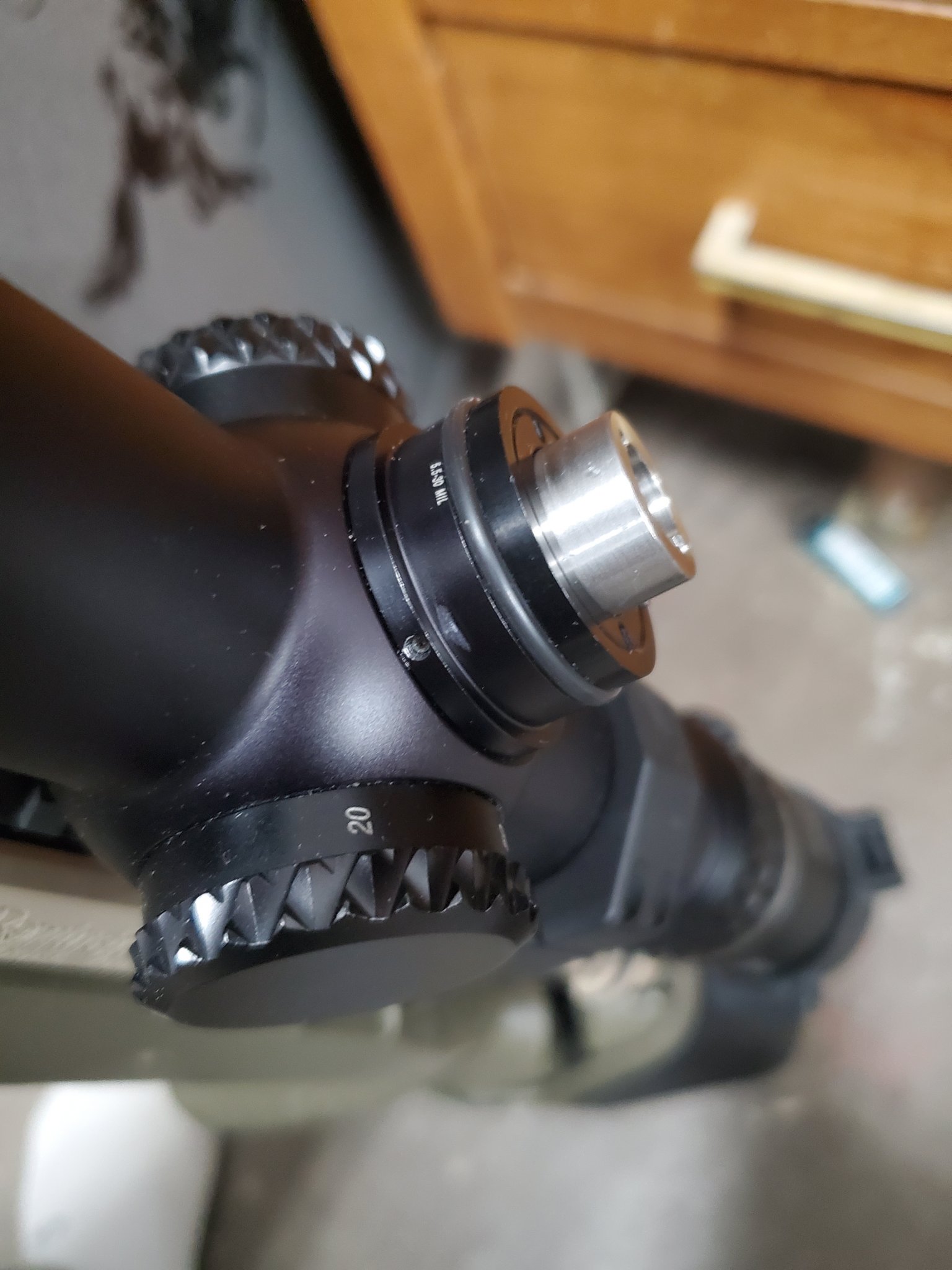

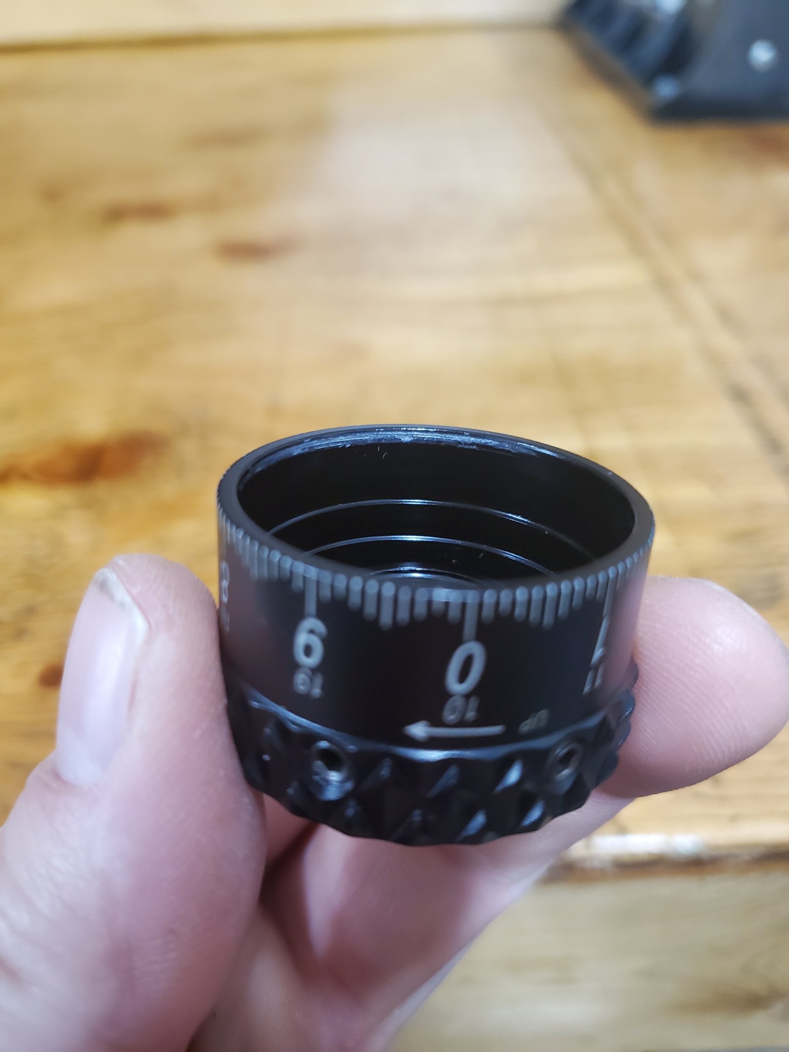

    Would it help to remove just one of the turret set screws before locking the turret down? That should prevent the pressure build up.
    Two will hold it until you reinstall the third one.

    For what I paid I’ll say I’m not disappointed in the optic so far, it has both some good and bad attributes. If I paid normal MAP and this is what showed up I’d be sending it back without a doubt. At that price there are LOW optics that are better built. The point of this is to get an optic that was in the price point I was looking for to put on a 22 trainer and also compare it to some of the optics that it’s constantly compared to and touted as the best thing below $2K by some fanboys.

    My xtr3 3-18 was a refurb. It had the turret play where the whole thing wiggled a tenth.
    BUT when I clamped it down and looked at tracking that wiggle produced no observable shifting in the crosshairs or sight picture. So it’s strictly an tactile feel thing.
    I also didn’t think the image duality was as nice as others had purported and I was lead to believe. Worse than the xrs2, cronus and razorg3(by far).
    BUT at my place I shoot elevated across a creek and when fog rolls it’s basically through a cloud. Couldn’t hardly discern the 500 yard targets with the xrs2, cronus, razorg3 however the Burris gave a pretty phenomenal view through the fog when all the others were struggling. Don’t really get how but it did. Really made me reevaluate what part of image quality is really most important. Seeing the target all of the time being most important and it did that surprisingly well.
    I think for under 1k it’s still maybe the best value going. Not as refined as many make it out to be but perfectly shootable.
    (I do want to grind the knurling down flat though)
    Holy shit, a tenth is A LOT. I guess I should consider myself lucky then with half of that.
    I did reset it so that the play is on both sides of the marking so it’s .025 on each side basically and doesn’t make it as difficult to use. Not ideal to have that much play. It apparently could be worse.

    Mine isnt the space between clicks, its the whole top module is sorta loose or something and the entire assembly shifts a bit. But it doesnt move anything internally that I can tell. You can see that the turret line to the base line stays good. But the base line to my pencil line on the body that rotates 1%

    The shaft is basically just a big ass screw that moves the internals up and down or left and right and then the detent is a secondary mechanism to make the clicks audible and felt. It's probably just not moving it enough to really notice it or its falling back into place. Regardless, it doesn't speak well to good build quality.

    The turret isn’t .05mil off, the turret has .05mil of play in every click. There’s a big difference. Once again the village idiot is clueless.

    I may be revealing myself as a rube with this comment, but lots of people with this scope in the thread.
    I've always had trouble setting zero with this optic. If I have the elevation knob at 0 and need to bring it down say .3 mil I would dial up to .7 then loosen set screws, slip turret to 1.0, then try to dial back down to zero. But almost every time the turret will only dial down anywhere from maybe .2 - .5 mil. To fix this I would loosen the set screws again, re-tighten and get a few more 10ths of a mil, and keep working it down to zero eventually.
    It works, but there has to be a better way right? I think maybe the turret cap it bottoming out on the body of the scope, is that a thing?
    You can pull the turret completely off and put a coin in the top of the shaft and zero it that way and then just reinstall the turret against the zero stop pin. I pulled the turret earlier this morning to see what it looked like in there after a dipshit in another thread was talking about the MK5 being a POS for having the same feature. See pic below for reference.

    Have you removed the elevation turret cover. My xtr3 had a really stiff elevation turret. I removed it and there was some stuff under it that resembled lapping compound or aluminum dust. I cleaned it out and the stiff turret resolved. I just pulled the cap off my other xtr3 yesterday and it had some stuff up in the turret that I could only compare to waxy bubble gum. This went to burris for internal fogging. And came back from warranty service with tool marks on the ring that holds the objective lens in also.
    I also noticed if I push down on the turret when rezeroing the turret cover. It will push on the ring below it attached to the scope body and the turrets are stiff for the first 3 or 5 mils or so.
