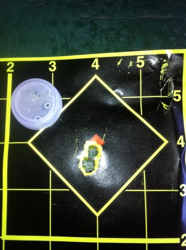

600 rounds through the barrel and I am only seeing .002 of throat wear and..
* the cold bore\clean bore shot is not much different at all from the warm 50 rounds plus through the barrel
* I am shooting primarily 208 AMAX with 47.7 gr of RL17 @ 2700 fps on a 27", 1 in 10 PACNOR barrel
* I shot some 175 SMK today with 44.7 RL15 and this is the result
Very happy so far..

I put 30 rounds through, cleaning after every few rounds.
I also removed all the copper before turning it in..
Also, the .002 wear could've been the bullet as I am seeing as much as .003 variance in ogive from bullet to bullet.
Looking through a borescope I see no heat damage from the throat whatsoever..

Good question. I chrono'd the first 30'rounds out of the batch of 50 I made.
After the melonite I would say I lost about 25 FPS ave. I more than made up for that with more powder, hence 47.7 of RL 17 and still no pressure signs but great accuracy.
