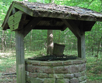

    I am a retired steamfitter / welder. I have worked on many, large scale, water reclamation projects. The technology is all basically the same it's only the size of the project that varies.
    Many years ago, I went to the Estate Sale of a retired "Water Engineer". Spoke with his family in depth. He was an old school Survivalist. On his patio were 4 - 5 PVC barrels, mounted at different elevations. The house gutters were routed to the highest barrel. The lowest barrel had a regular 3/4" hose bibb valve. I should have gotten some photos. I have not seen any system similar to that in many years. Obviously the system would produce potable water.
