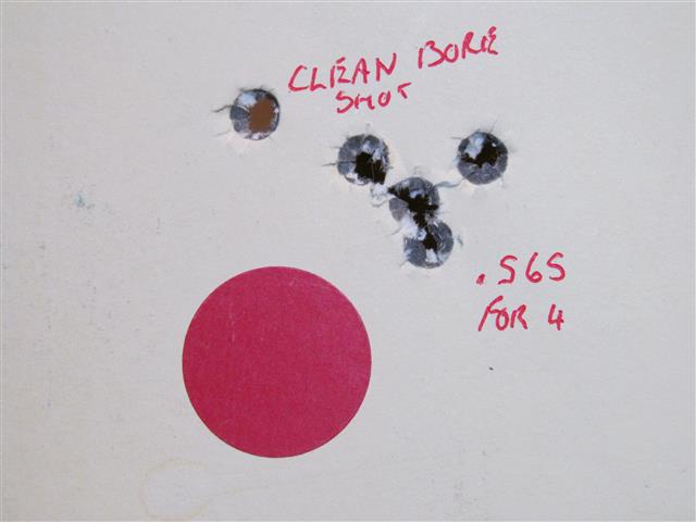

+1 on this i have a sendero 7mm rem mag and shot the 180 VLDH today with 69g of h1000 cci250 and it shot .565 if you discount
the clean bore shot i will be tweaking seating depth to see what i can squeeze out of this rifle.
and i just checked the burger twist calc on the 180vld oal is 1.525 and the Stability factor is good
at 1.43 so 1 in 9.25 should do a 175.
cheers D
