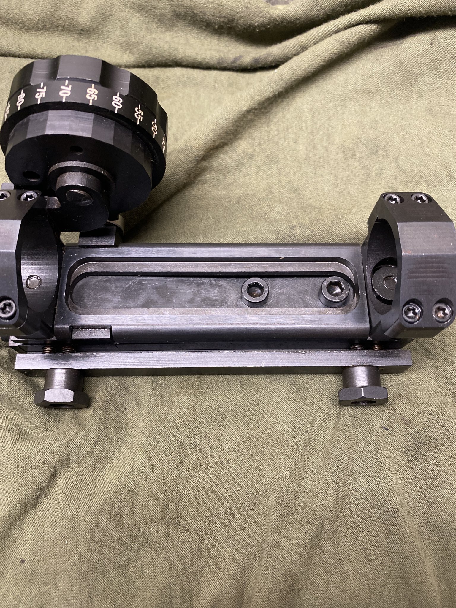

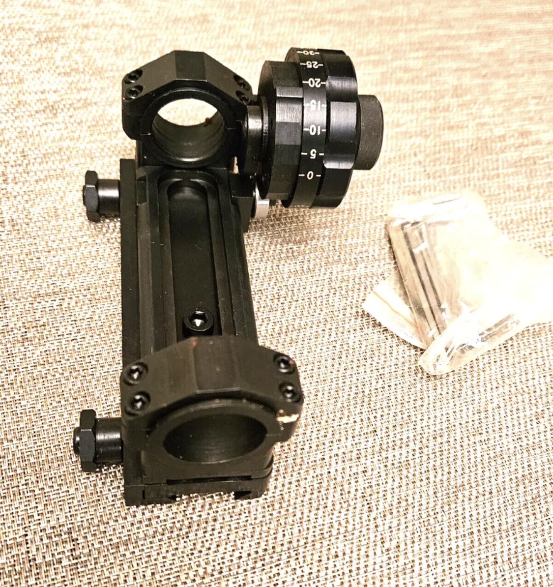

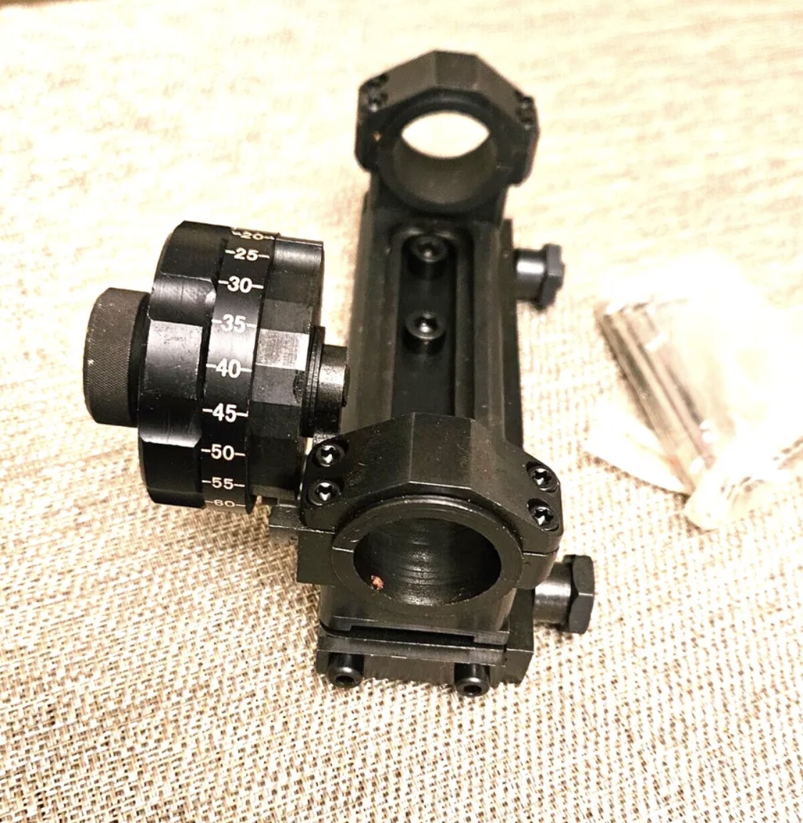

    Figured this is the right place to ask. I *think* this is an ELR mount, likely 30mm with 1” spacers. Ring tops look like smith enterprises/leupold ultra/badger.
    Really just curious if anyone can identify it and tell me who made it. I enjoy moderately obscure things and this fits the bill.
    Still in the mail but here are the seller’s pictures:
    Markings? Brand name?
    Description from seller?
    Looks like it could have a “dial a down” but the big knob has the look of “tacticool” stuff. Most of the adjustable bases are spendy and solid. This looks like it just cams the base up on scallops running around the dial. I see no way to lock it?
    Or could it be something like a Leatherood ART concept for older scopes? Not n ELR base so much as a way to dial a fixed scope! I don’t think so but ???
    If new production, I’ll be interested to know how stable it is and how well it locks and is “registered” in terms of its dial. ELR requires some pretty solid mounting because it requires heavy cartridges. Those bases are expensive and rugged. This doesn’t look like the “name”’unitsmout there. The fact that it cams on one side also is concerning as it might tilt the scope at higher elevations if it is simply bending a spring from one side.
    Or maybe it’s for .22 ELR which is a coming thing. And would allow lighter scopes and have plenty of rigidity. Or for new and powerful hunting airguns or even airsoft (lots of drop there!)
    Be interested in your review when it comes in. Whether it is solid machining or Chinesium novelty. It’s definitely interesting!

    Google image search came back as aluminum alloy. Tineye came back with zero results. OP might want to cruise over to the CMP forums.
    Seller description was less than helpful: “
    Scope Barrel mount with rings and adjustment as seen in the pictures
    no brand or maker.”
    I’ll definitely post more pictures and what I can make of it once I have it in hand.
    Srihr, I think the cam comment is really interesting, I also think there’s a leaf style spring applying pressure to hold at the Cannes position, so not necessarily a heavy caliber setup.
    The ring caps and the reducing inserts look like Badger to me.

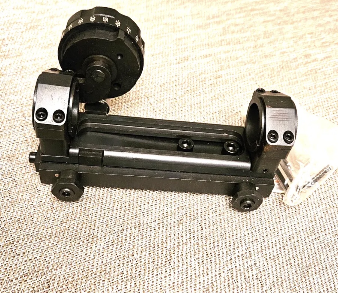

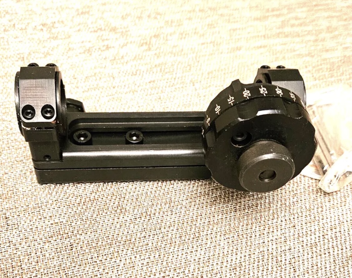

    The knurled knob could be a locking/dial tensioner. Inside the cam there are two washers on the shaft. Sort of like the drag on a casting reel.

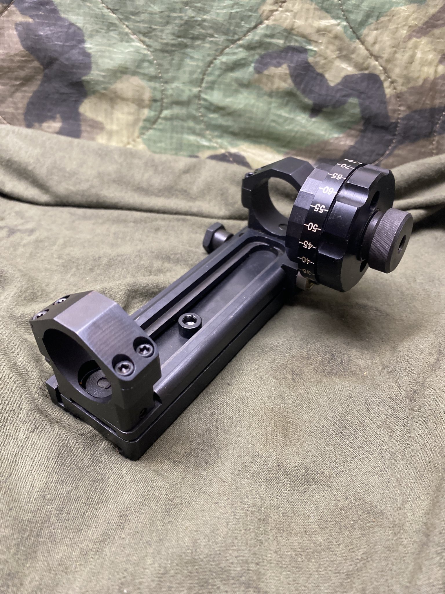

    Well if nothing it’s a heavy chunk of steel. 2lbs, 3.4 oz to be exact.

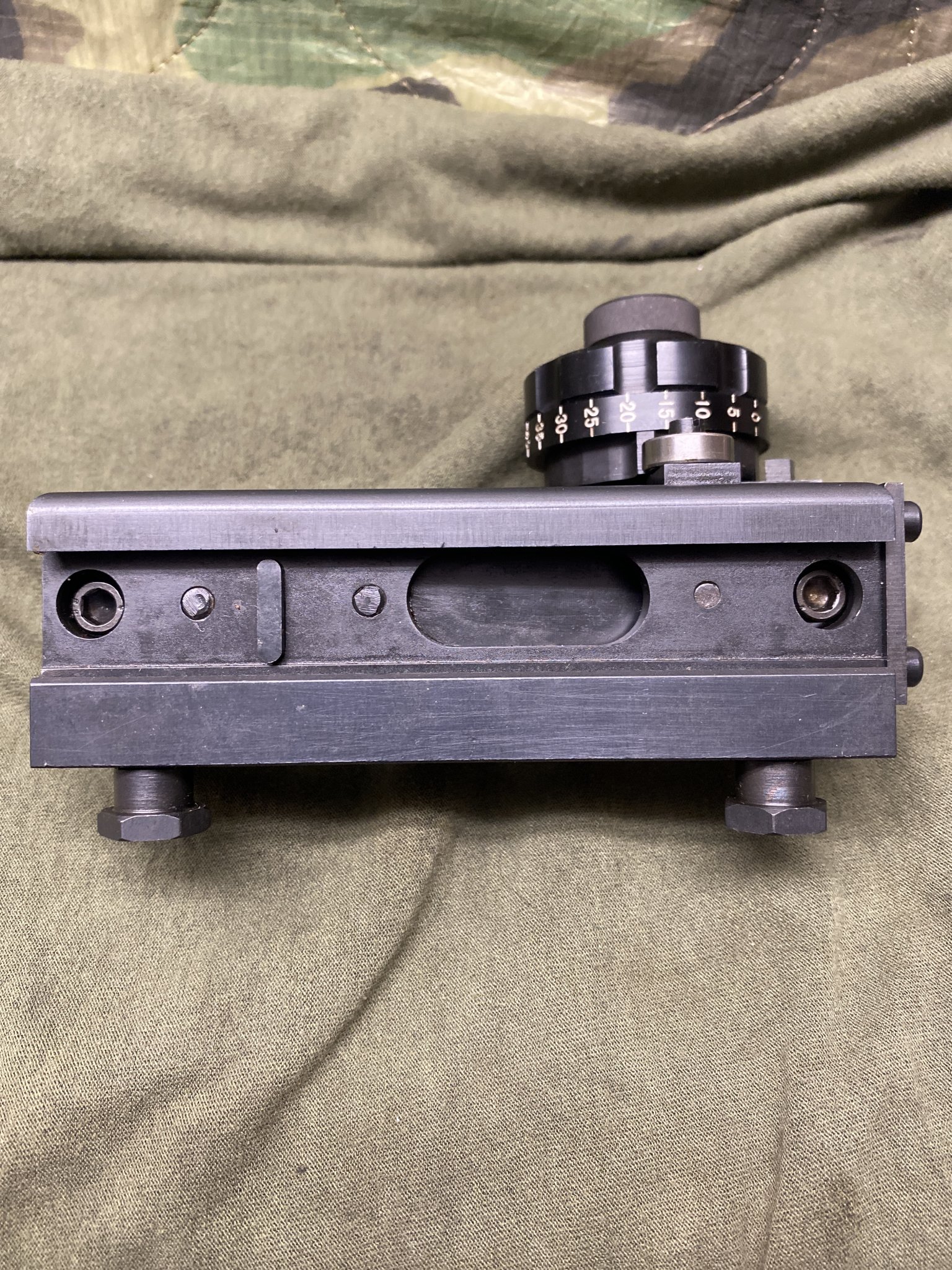

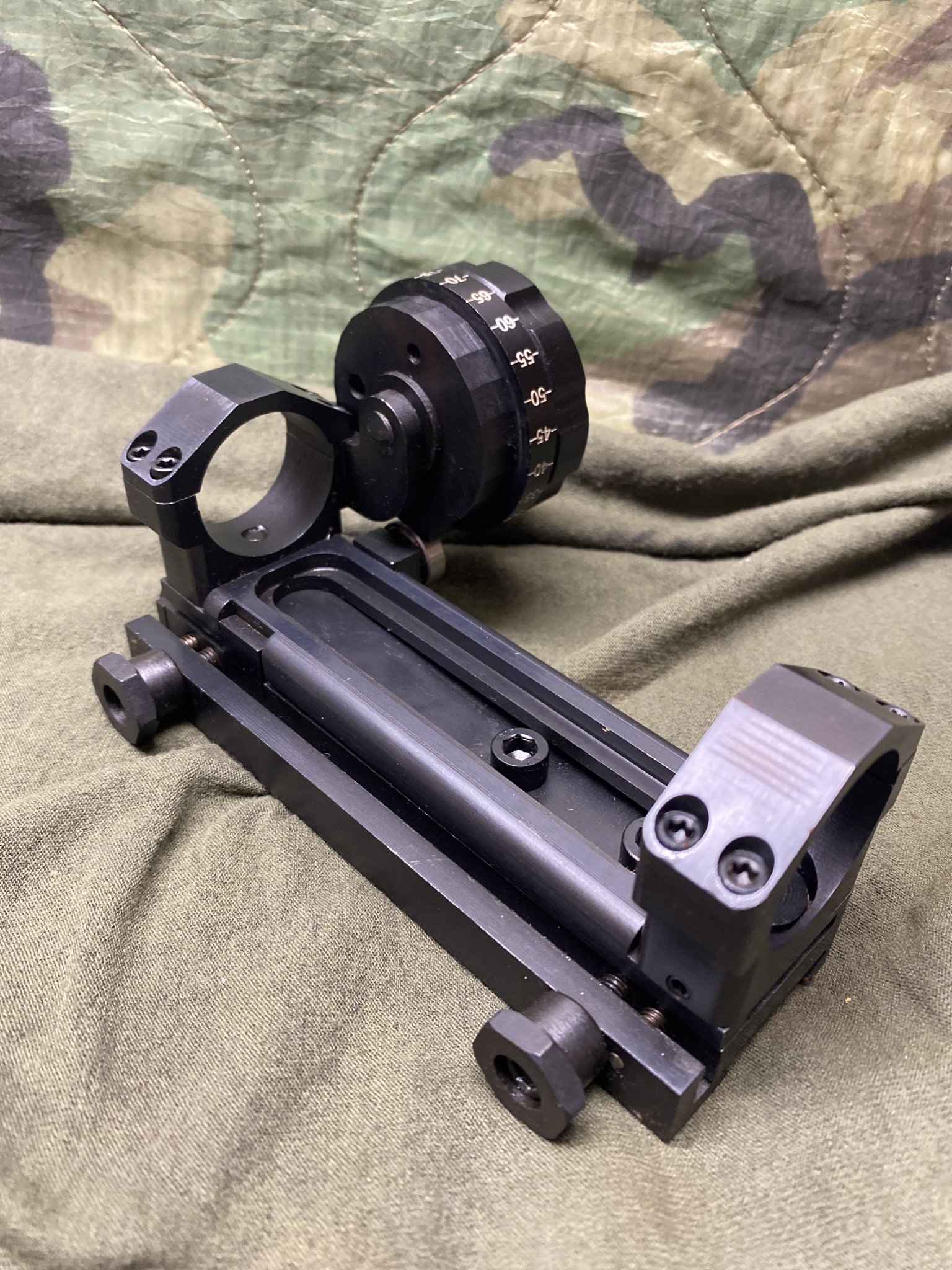

    So, first observation: it’s stout. It is graduated 0-100 MOA elevation. The elevation dial has stepped insets machined to match each number. I haven’t done the trig to truly calculate out the steps, but they appear uniform. Someone mentioned that it was likely not a crossbow or bow mount because they didn’t increase in spacing as the wheel turned; this is machined so the numbers could stay the same distance apart but the amount of material removed from the cam/wheel interface could change. All that said, it’s 2+ lbs, I doubt anyone wanted to lug it around on a bow or crossbow.

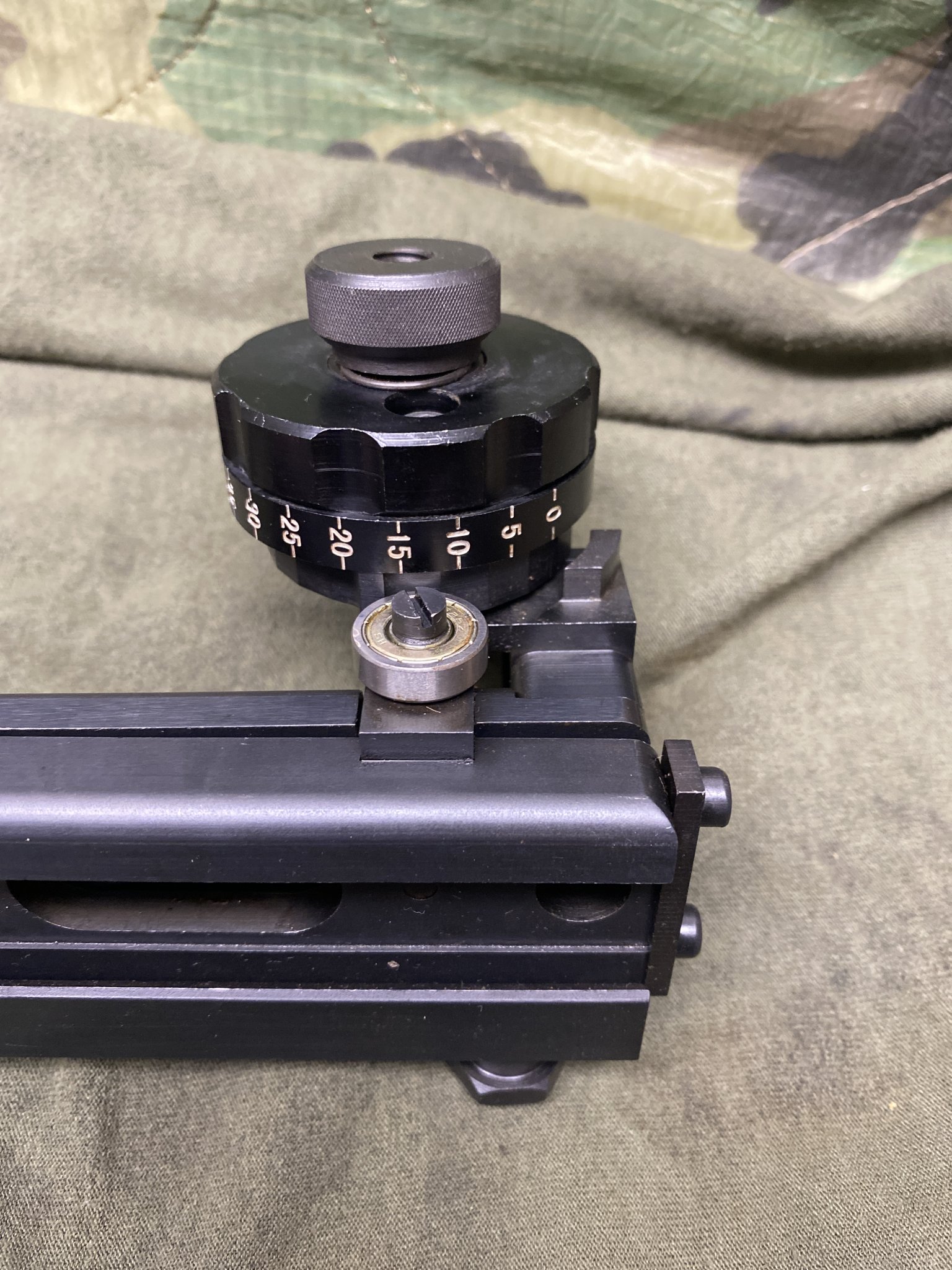

    A good view of the graduated face the roller sits on from the side, showing the difference in inset from “0” to “100”. Cam is at the bottom.

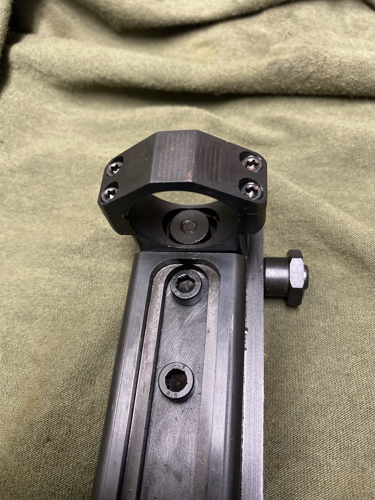

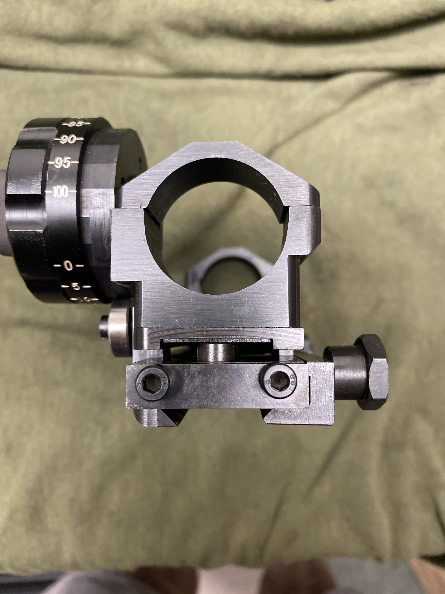

    The front ring is windage adjustable as needed though I can’t see a clear way the back ring could swivel to account for it. Either way, it can drift.
    The two bolts seen above hold a spring in place, the spring pushes up against the bottom of the mount forcing it up as elevation is dialed in. It also sits in a channel on the underside of the elevated portion of the mount, and with 2 screws would prevent side to side drift. But it’s not needed, since the rear scope ring sits on an inset pillar that holds the mount from any side to side movement.
    The underside has a recoils lug, and you can see the two screws for the rings (the front for side to side adjustment as needed, the back simply to hold the pillar as it moves up/down.
    The bar clamp has springs in it to push the clamp off the rail interestingly enough. I don’t know it was needed but certainly makes it seem well thought out. It also explains the bolt heads; they keep the nuts captive since the clamp bar is under spring pressure.

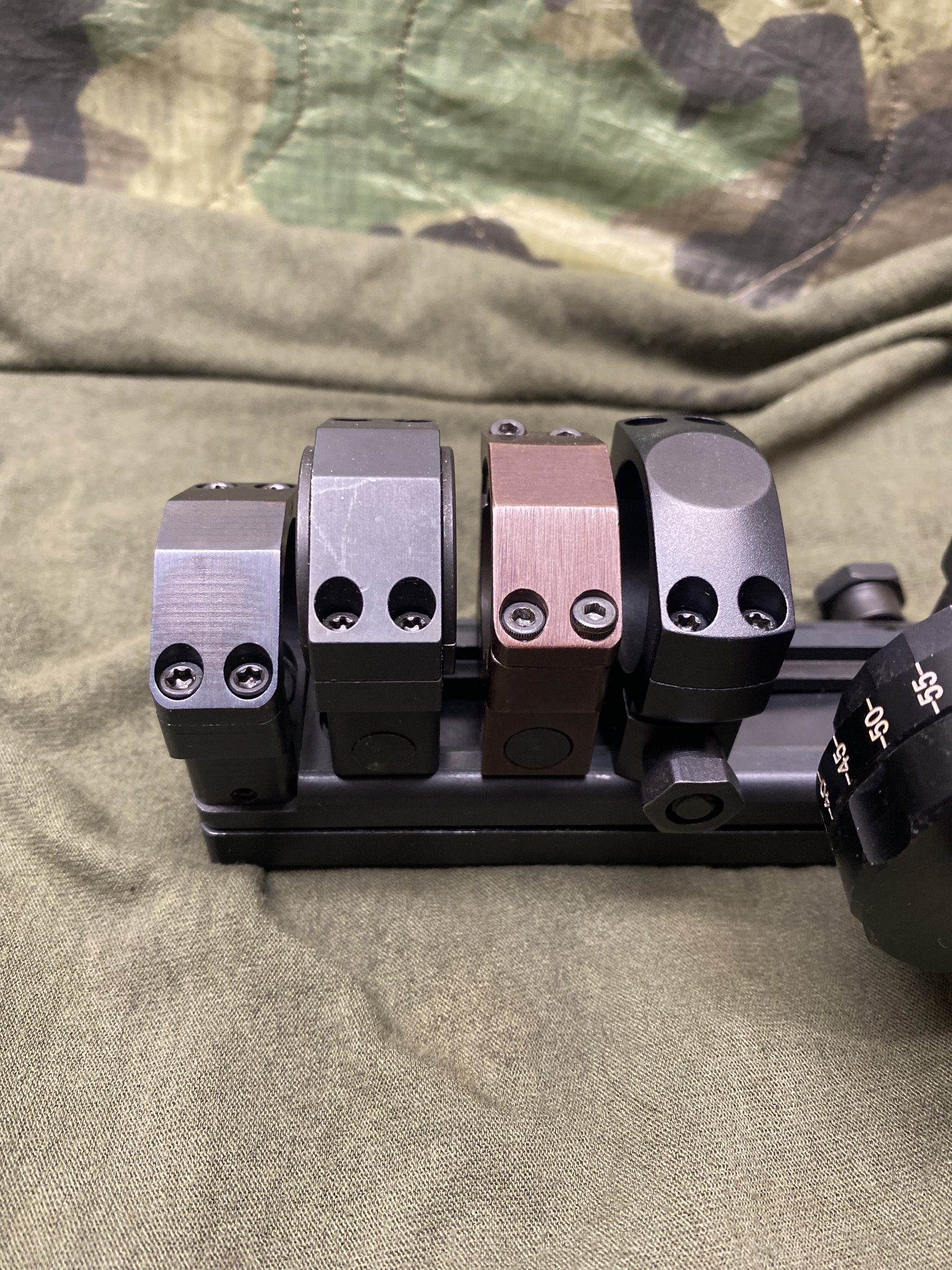

    All around, feels well built. I don’t see any manufacturers marks anywhere, and agree it’s not badger (though the ring profile is similar. I’d honestly guess smith enterprises or the like, but the rings don’t have the usual grooves inside that early smith rings tend to.
    All in all sturdy and well built. Pictured with some other early rings.
