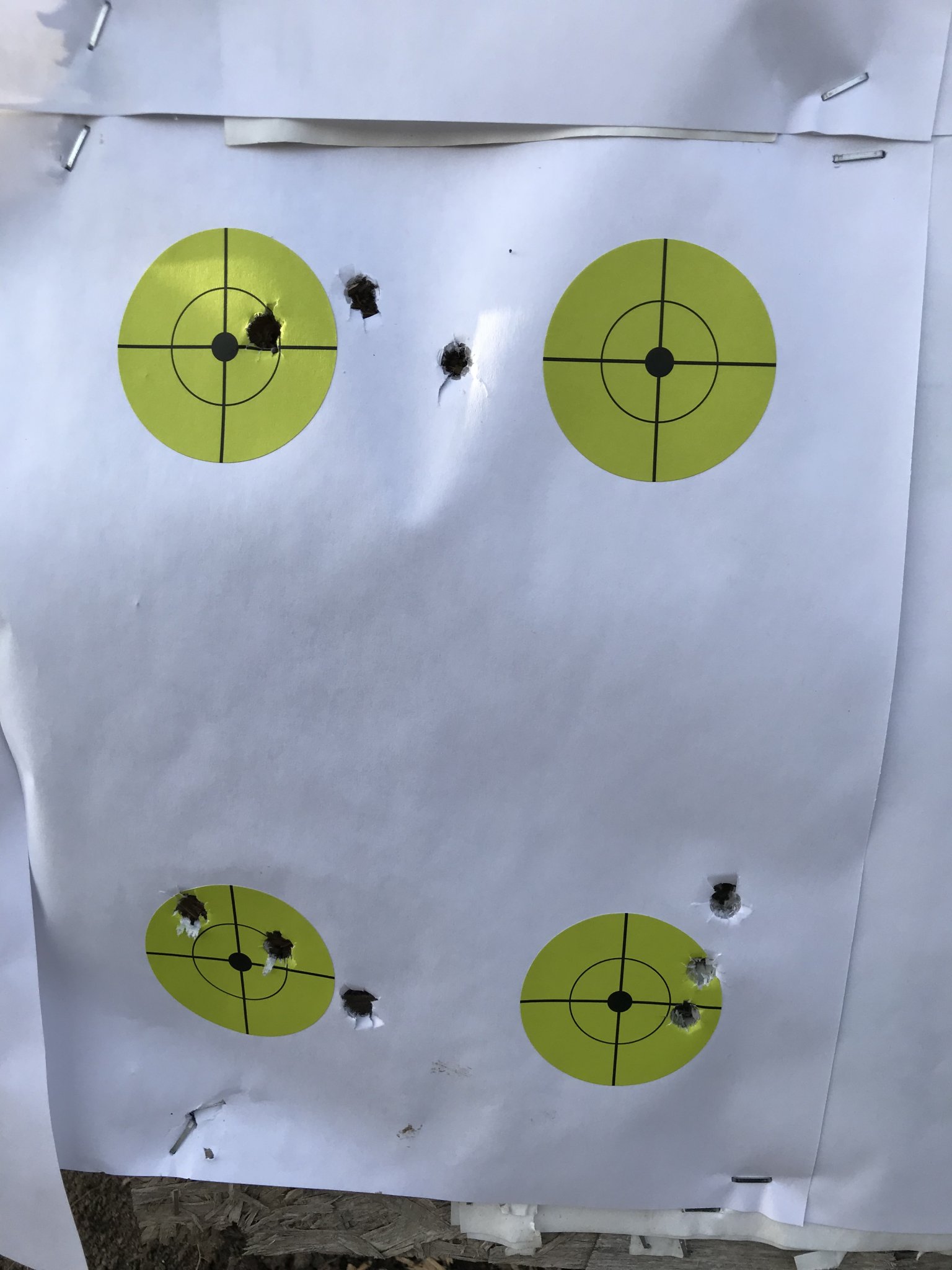

    Hodgdon showed 40.0 min and 42.7 max on H4895. I started at 41.0 and did 3 shots of the following:
    - 41.0gr
    - 41.3gr
    - 41.6gr
    - 41.9gr
    - 42.2gr

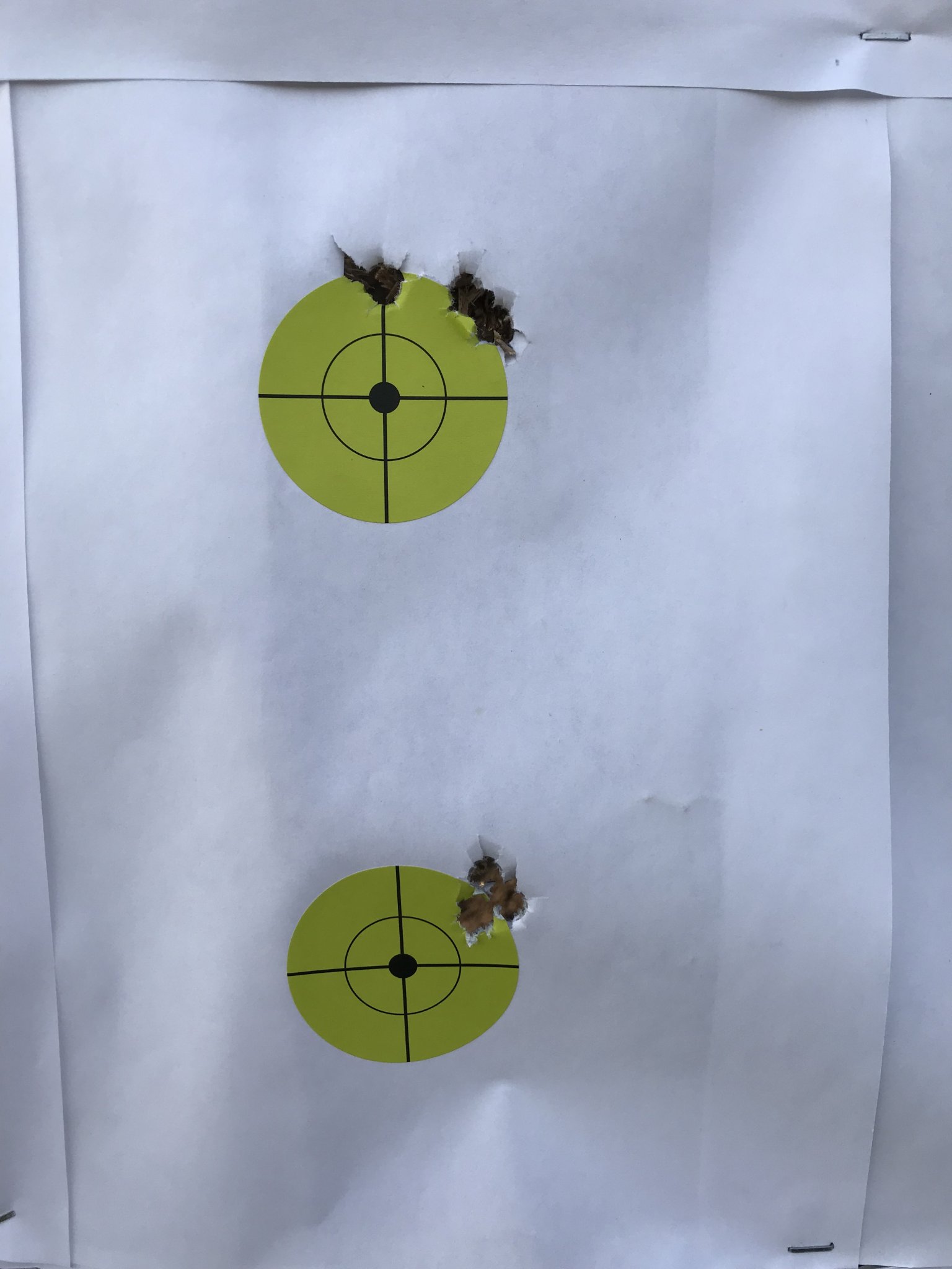

    By the 42.2 the bolt got stiff and got some swipes so definitely not going back that high. Here are the results:
    Bottom group is my min (41.0gr), top group is my max (42.gr).
    Top left is 41.3, bottom left is 41.6, bottom right is 41.9.
    What I am worried about is how great the variance is in accuracy between the 41.0 and 41.3gr. If I get any pressure or velocity spike because of a hot day, I would assume my accuracy goes to shit.
    Do I load a little lighter at 40.7 and try it out, switch to a slower powder, switch seating depth, or get a different weight bullet? Looking for some input on what you think is best.
    Little update:
    Shot 40.7 to see what would happen. Kind of same story as the other middle loads. 1” groups at best.
    Every factory Remington 308 I have had, a 178 a max will fall out of the case before it touches the lands. I don't see anything that makes me think node there. The test size is too small. If you think you have a node, I would run a length test on it. You might be surprised how much it can tighten up your groups.
    My best accuracy came from 178 Amax loaded LONG at 2.88" in my Rem 700 5R. 4064 was my go to buy H4895 was very accurate as well just slower.
    You do know an OCW has nothing to do with looking for accuracy. Your looking for consistent POI. You adjust seating depth after to shrink your group size.

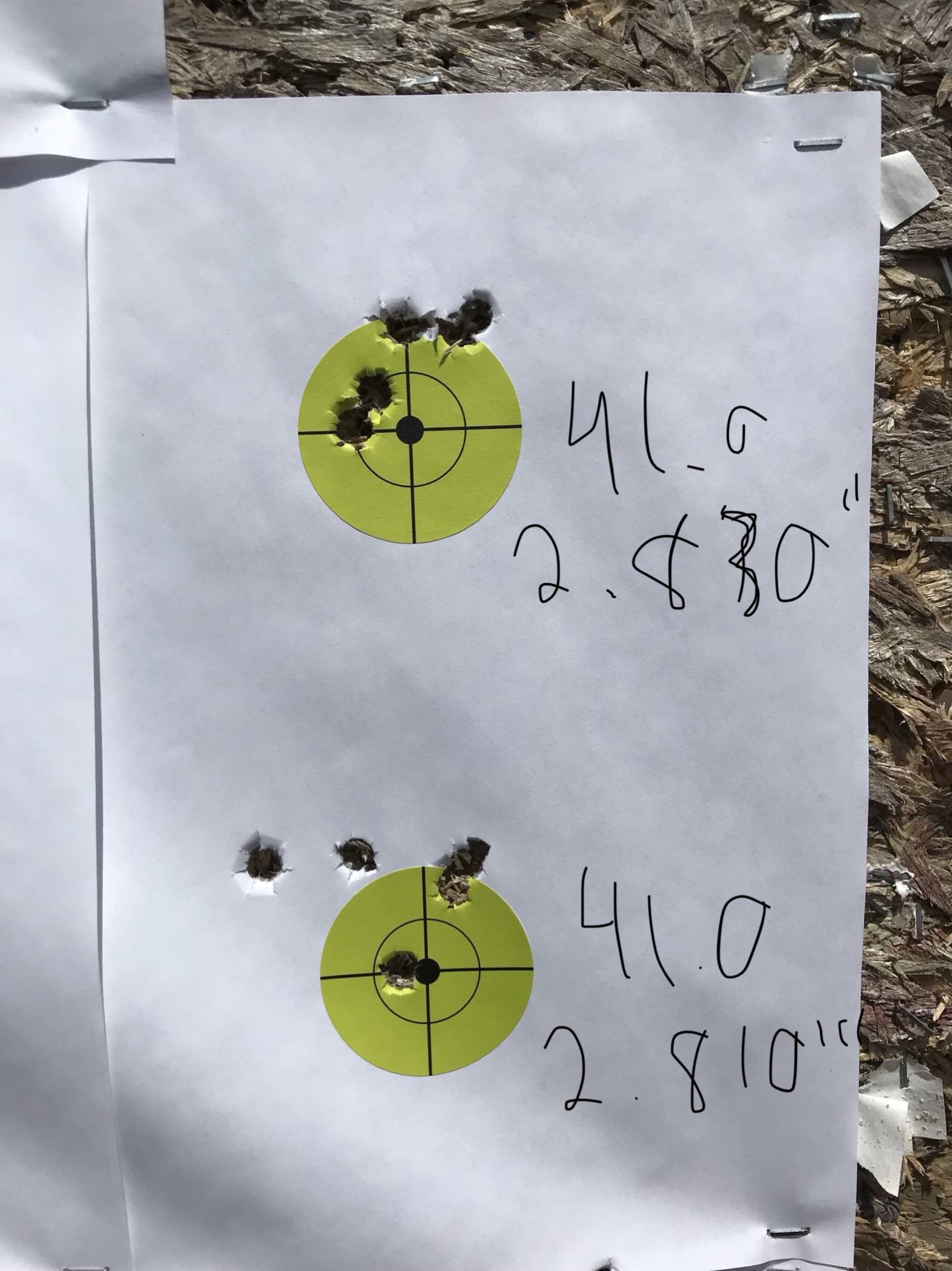

    Shot the 41.0gr again and the same 2.810” and 2.830” OAL today.
    The 2.810” that was all touching yesterday was like 1.5” today.
    The 2.830” tightened it up a little bit but still nothing to write home about. Fighting mirage a bit, but not enough to do a 1.5” group.
    Was the one yesterday a fluke? I was hoping I had some 168s around but not seeing any. Might run up to cabelas just to get something else to try.

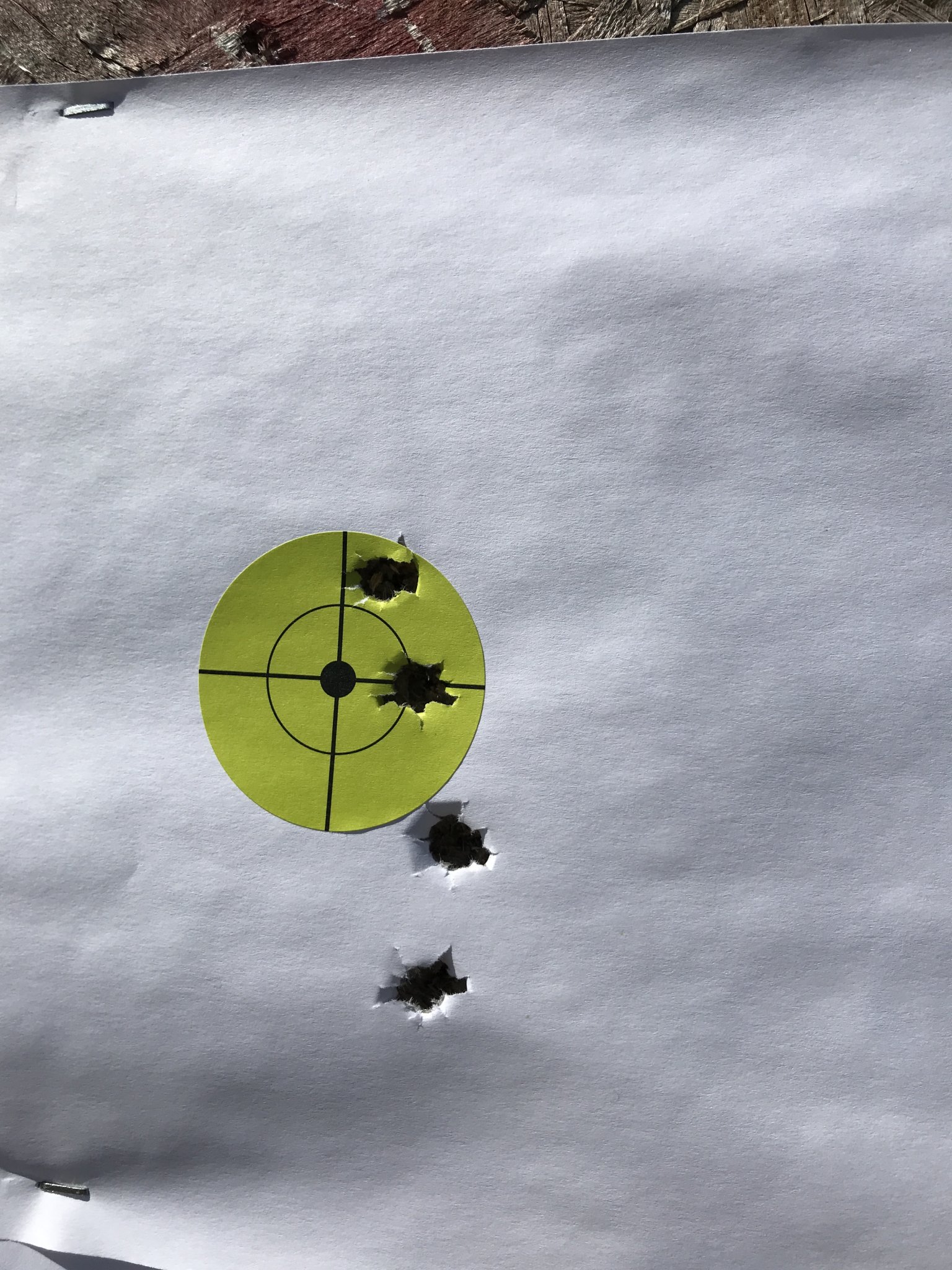

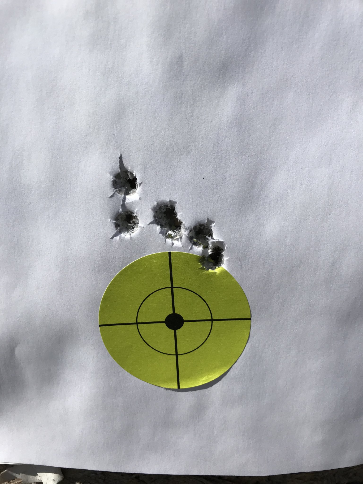

    The reason I’m starting to think it’s a gun/barrel issue and not load issue is because of the groups I just shot. I picked up some factory Hornady 155 BLACK and Shot two groups.
    Bottom picture is the first 6 shots (upper left most shot was a pull on my part). First picture is the next 4 shots. Pure garbage, which makes me wonder if it’s the factory barrel or the stock.
    If it’s the barrel then I’ve got a replacement blank sitting at Spinners Fit & Chamber ready to go on. Just didn’t want to pay the smithing fees and all just to find out the chassis or my trigger is crap.
    Checked everything to make sure it’s torqued to spec and tight. We are good there. I’m also running all this with my suppressor on. Would that affect groups negatively or no?

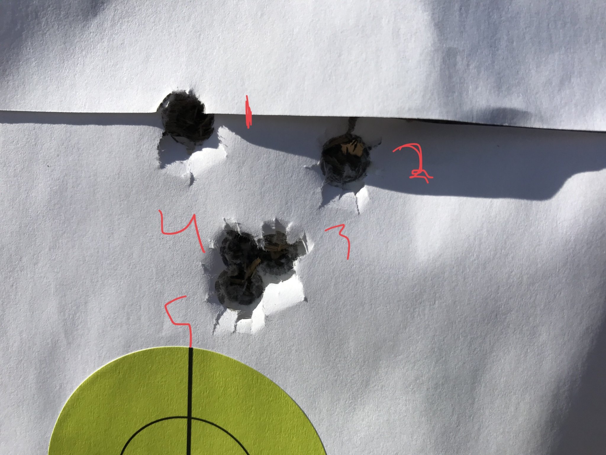

    Loosened the back screw and the tang stayed put.
    I shot two 5 round groups and labeled the order. Let me know if that gives you any indicators.
    How many rounds down it? I have had to JB paste a rough factory barrel when new, or do the same thing to remove a tight spot in the bore after a bunch of rounds. IT keeps looking better and better.
    I've got a Mossberg .308 that I sent back to have a new barrel put on. Couldn't get that gun to shoot after breaking in and JB pasting it. New barrel and 60 rounds have settled in in.
    I guess a consistent 3/4 or at least 1” with custom hand loads would be normally. But my 3/4 load goes to 1.5” randomly the second time I Shoot it.
