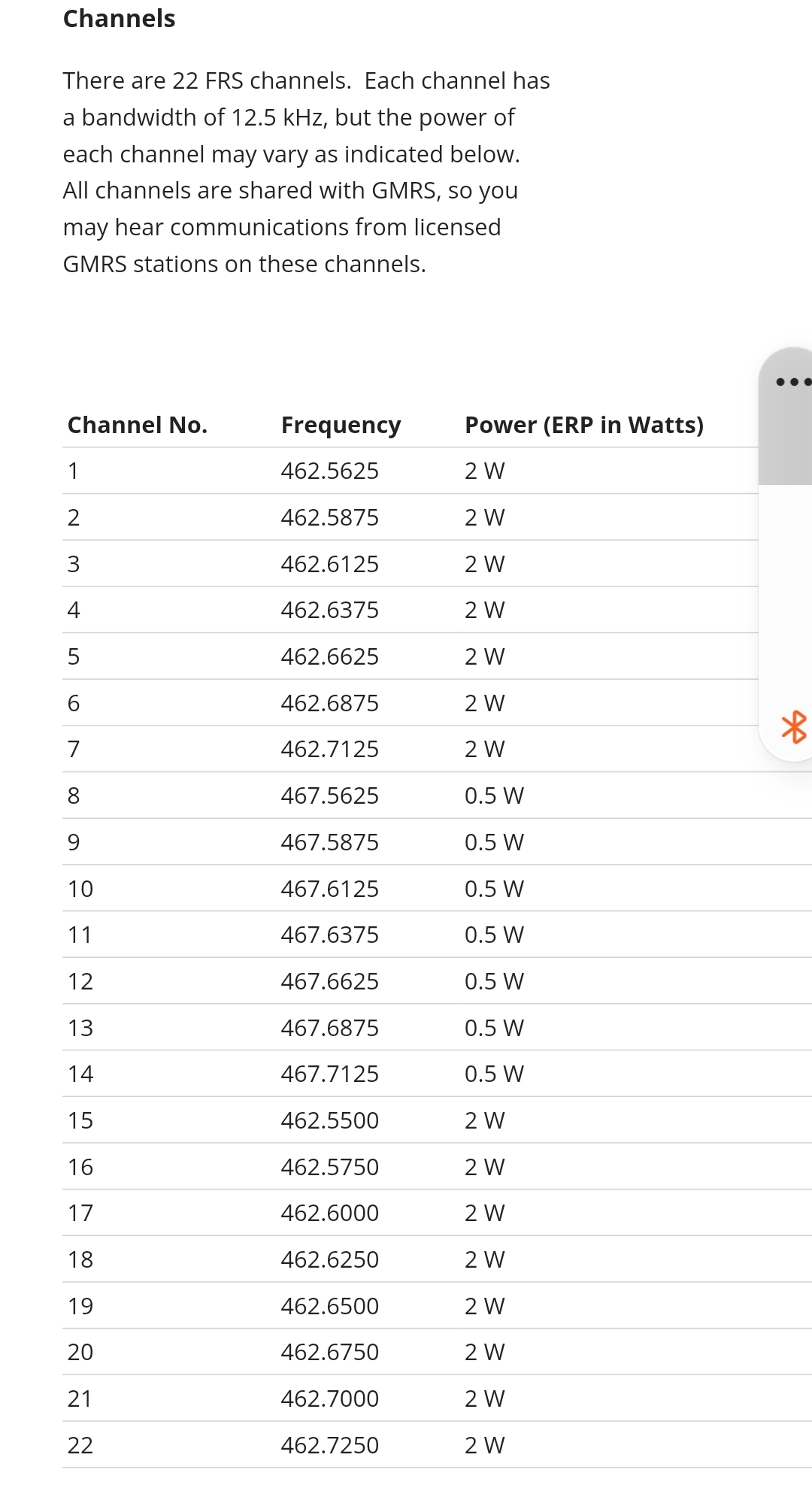

    i got a few cheap handheld units and better antennas, installed chirp and got them functioning, but then there was a long discussion here and some members explained better what i should do or get or study.
    and i haven't done shit. ☹️

    fuck, go onto a HAM forum, and ask about using a baofeng on FRS/GMRS channels.....they will be frothing at the mouth quoting FCC guidelines, and threaten you with fines and jail time for doing so....as if it were their fucking job.

    There are frequencies you can transmit on without a HAM license (FRS); however Baofengs' output exceeds the allowed wattage, so it's technically not legal to use a Baofeng on those frequencies. ...Maybe if you dial down the wattage, can't remember if that's kosher.
    These are the frequencies used by walkie-talkie type radios. Without getting some elevation max range is 6 miles before the curvature of the earth gets in the way.
    https://www.fcc.gov/wireless/bureau-divisions/mobility-division/family-radio-service-frs
