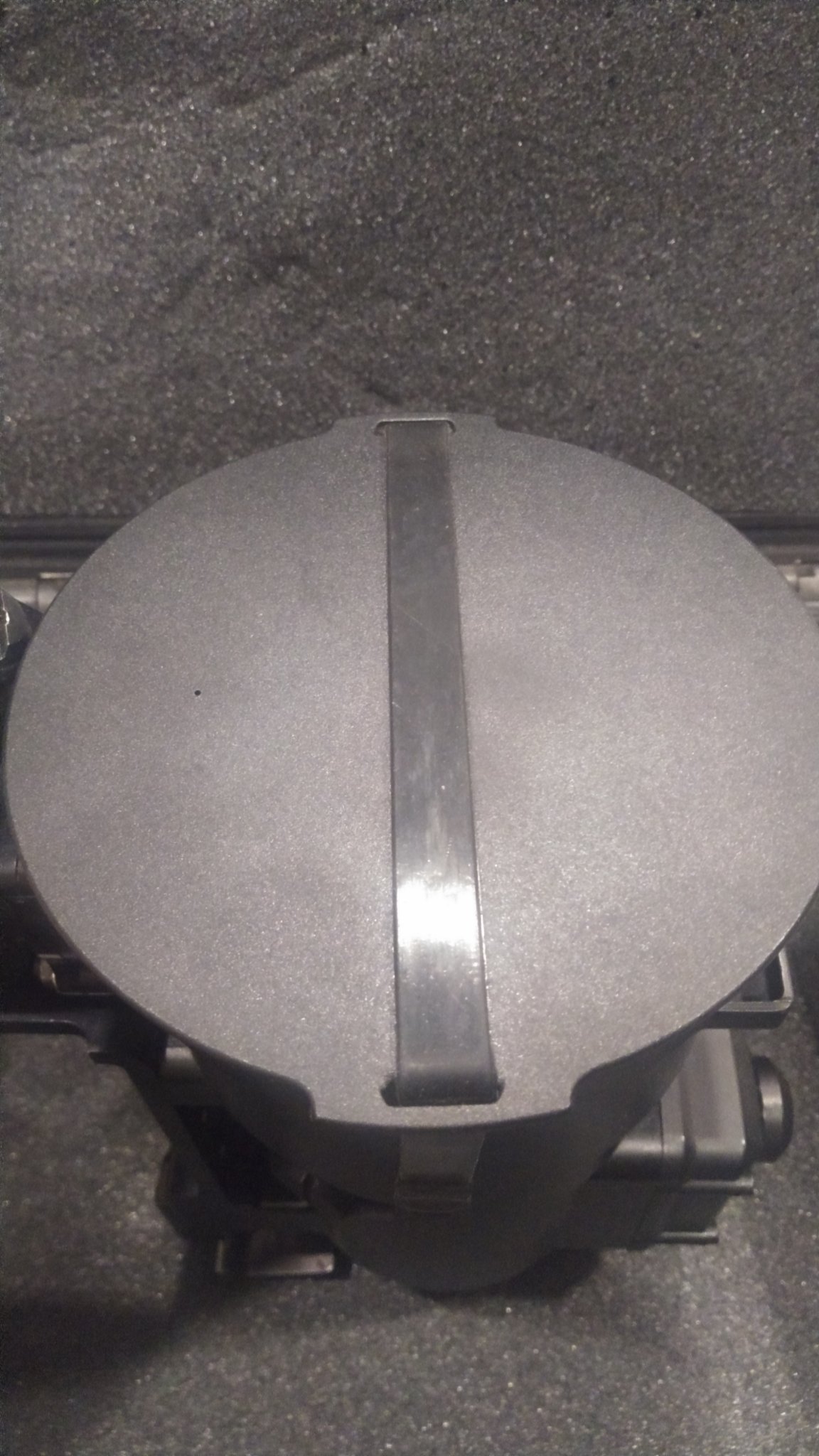

It is my first nv. I've had it for a few years but I've only used it a few times so far. Yeah, It works with the damn cover on. I would never have figured the tiny offset hole would work. Nevermind, stupid thread, carry on. :ROFLMAO: Thanks for the replies.

Not stupid thread.. it actually motivated me to grab the pvs9 and gear and run out to some AG acreage for few hours, after my last post . I forgot what a great image this thing has, can make a good clear focus image to 16x power in last nights ambient light conditions .
Next time, when you look threw the unit in daylight or just a lite room with it mounted on the rifle . Slightly 'circular rotate' the Obj. cover Left and Right .
In the past, i have noticed that there is a sweet spot for the pin hole in cover to be positioned . You can rotate the Cap/pin hole position to get a Good full filled projected image. Or you can rotate to a position for a funky hour glass shape image .
