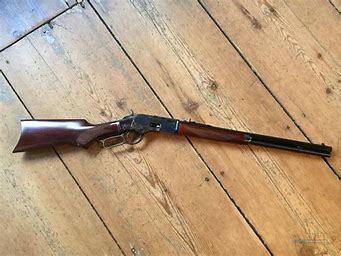

Not the first time I’ve seen that vid, your wife is definitely faster than I would be. Italian over Jap ‘73?
I like the '73 no matter who makes them. Simple design, minimal moving parts, nearly impossible to jam. The Uberti/Taylors/Cimarron 1873 Short Rifle is my preference and I have owned several, and slicked up dozens for Cowboy Action Shooting. My wife and I have used them to win multiple World Campionships in Cowboy Action Shooting.
