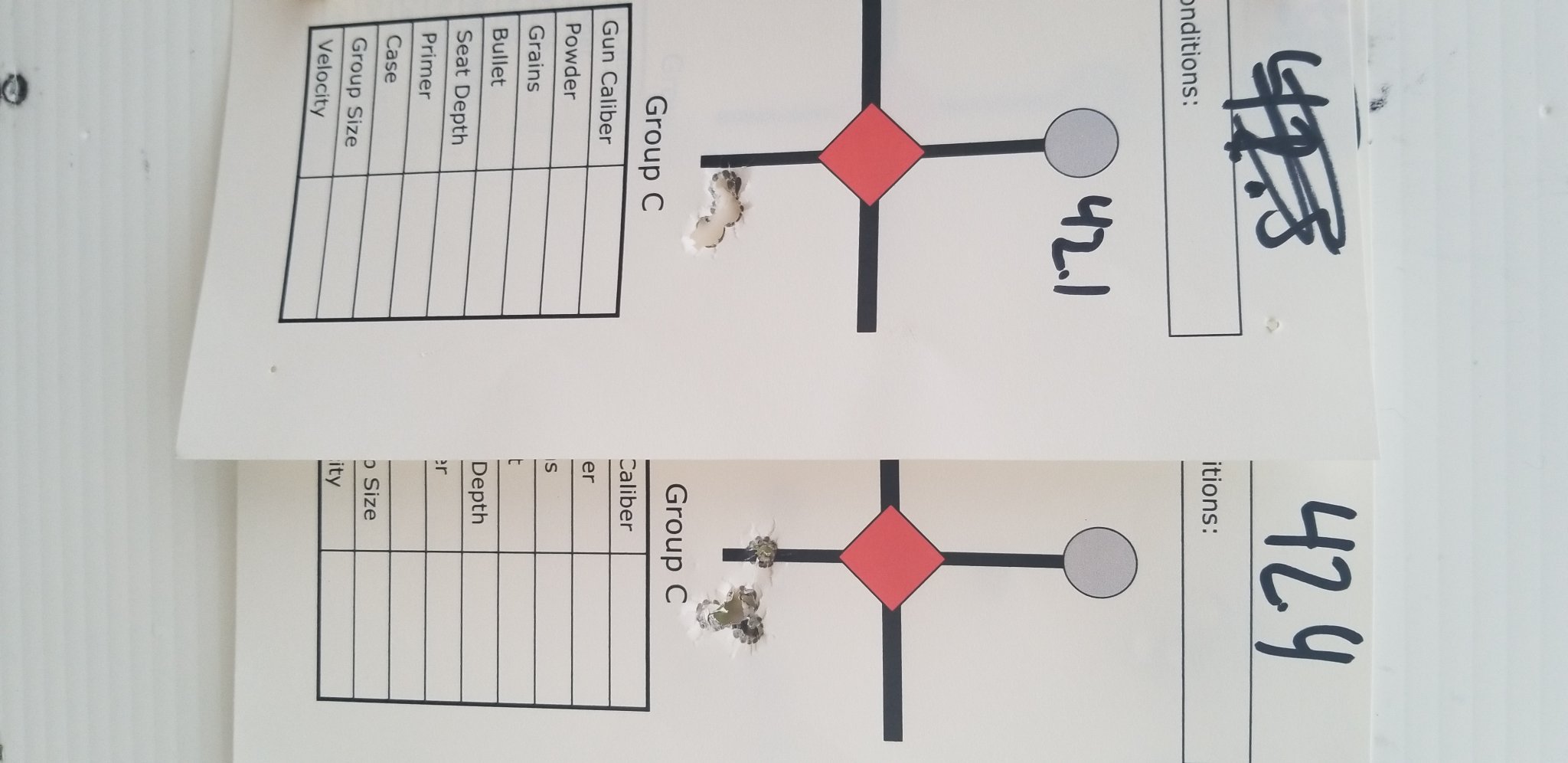

    Fast forward to a few weeks ago. Barrel is toast on the Nucleus so I started load development on the Solid Accuracy barrel.
    Loads are 1x Prime brass, 142 SMKs, FGMM210M primers, and H4350. Four rounds each at 41.2, 41.5, 41.8, 42.1 and 42.4. CBTO is 2.220 and about 20 thousandths off the lands.
    Hit the range last night. 59 degrees. Very windy, but the range is somewhat secluded with a large stand of Norways on the north side, which did pretty well blocking the winds, cutting them down to about 2-4 mph.
    41.2g and 41.5g weren't anything special. At 41.8 things started tightening up and 42.1 and 42.4 were ALMOST one hole groups as you can see in the pictures below.
    Velocities for 42.1 and 42.4 were 2816 and 2812, respectively. I'll split the difference as much as possible on the Chargemaster and roll with it.
    I only have some pics of the target, none of the rifle, but will post some up this weekend.
    Headed to a place tomorrow where we can reach 800 yards so we'll see how it does.
    Not sure why the picture posted sidways, but you get the gist.
