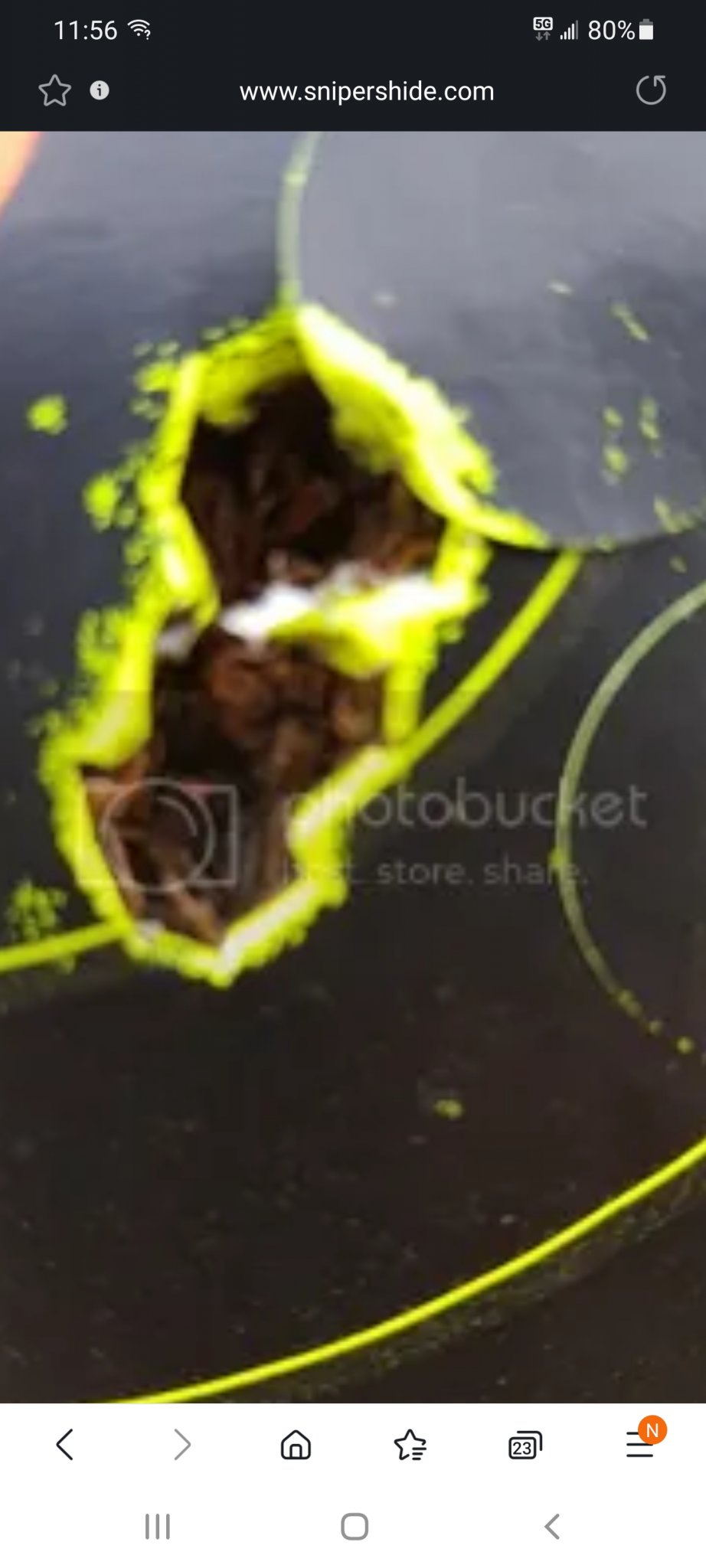

Here's 3 at 300yrds with Warner flatlines
Won a few local matches with them

I've been able to get the 256 flatlines into one hole .
Not sure of what a group looks at 1k, once I get the load and ES i go straight to 2000yrds

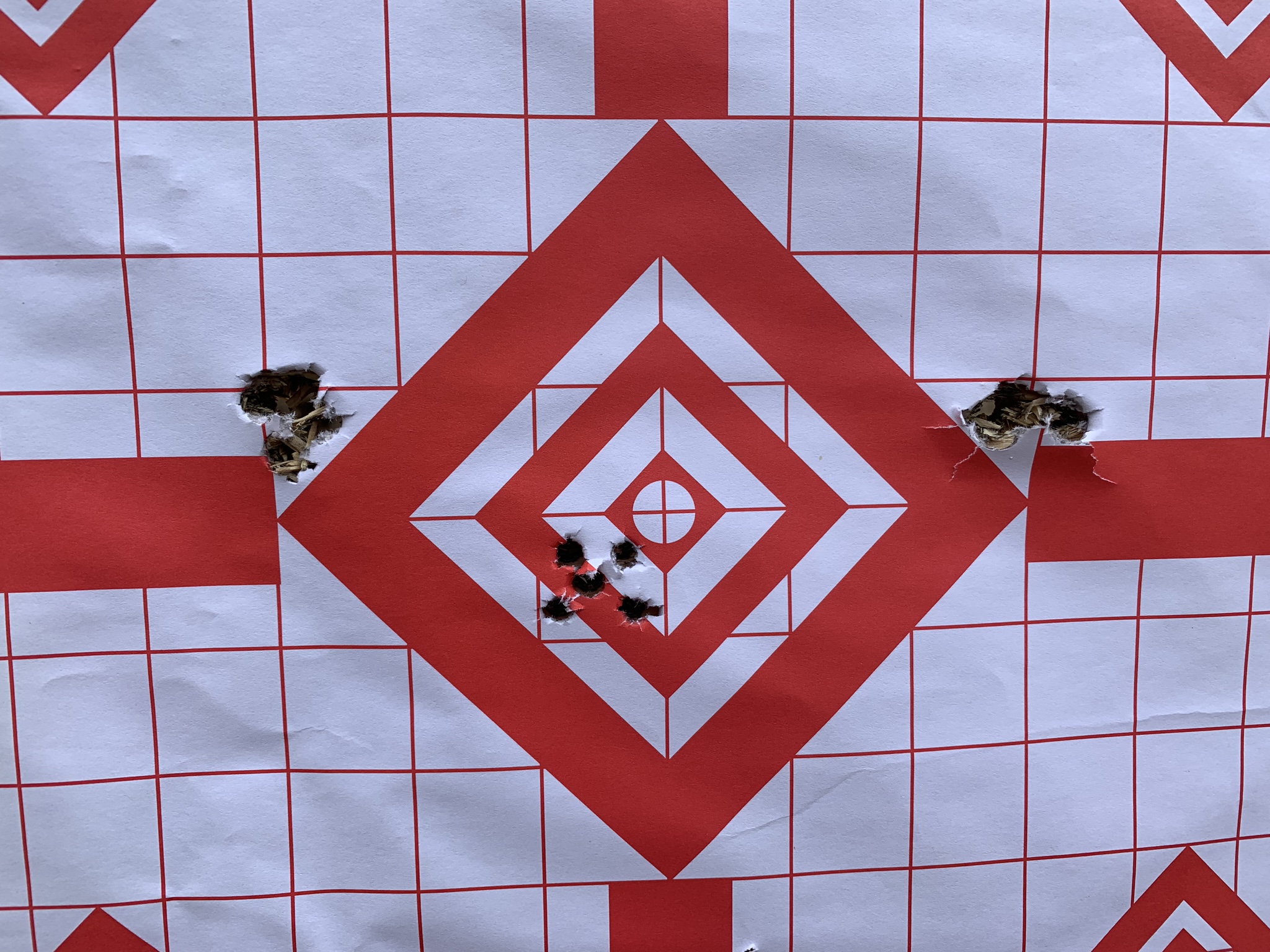

My 338 consistently is in the 1/3moa range at 1000 with 285 and 265 badlands. I ran the 285s at 3340fps with a 1.04g1 to line up with my impacts.
To say they can’t shoot small because they aren’t used in br is false.
I was running 350gr badlands in my 375 that my wife now shoots and have shot plenty of 10” groups at a mile with that one. I printed 3 shots into 8” at 2900 in competition with it. It was running 3172fps. .940g1 on that one.
these are 2 5 shot groups at 500 yards during load dev. Don’t have any other pictures I can find. Don’t mind the little holes. That was my son shooting
