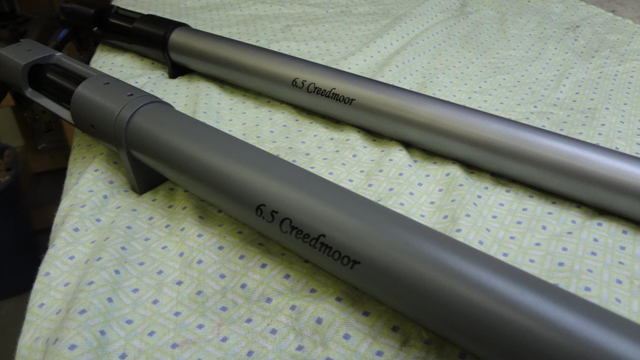

Soltis Rifles is teaming up with Rock Creek Barrels to offer Hide members quality barreled actions for their envisioned future build. The actions are new-in-the-box Rem 700SA, Right-Handed,-Chrome-Moly from Brownells, barreled with Rock Creek 5R Stainless, Cut-Rifled tubes. Soltis Rifles does all the gunsmithing, these are very precise and tediously put-together barreled actions, and guaranteed to shoot 1/2 MOA with quality match ammo. Also, anybody who knows me can tell you, I do not assembly-line anything, these are built one at a time to exacting standards. The calibers will vary and availability will depend on how often Rock Creek can get me barrels and availability of actions from Brownells. The first two are pictured below, I did them in 6.5 Creedmoor, and their specs and what went into their building is listed. For these two, I'm showing/listing them here, but in the future they will be listed on the Soltis Rifles website (www.soltisrifles.com) and I'll just post an announcement that they're available.
Standard on both barreled actions:
*Complete blueprint, action lug seats/face/threads re-cut/trued (single point the threads, use Gre-Tan fixture for all cuts). Bolt lugs front/rear re-cut/trued, along with face, nose, and then finish lap lugs to 100%. Open up recoil lug, Mill out bottom/rear of action to accept magazines, barrel, chamber, and cut crown. Thread bolt handle for oversized knob.
*Polish Action/Bolt for smooth operation, break all the hard edges (these new-in-box 700's have knife edges everywhere), deburr scope base holes and clean up/re-tap 6-48 threads, Refinish barreled action, Parkerize/DuraCoat, stamp and stencil barrel with caliber. Test fire, check cases, checking bolt manipulation/extraction for proper headspace/chamber polishing, etc.
1) New Rem700SA,RH,CM with Rock Creek SS 5R 1:8twist, M24 Contour, 24" bolt face to crown, 6.5 Creedmoor, Badger Ordnance Oversized Recoil Lug, Surgeon Bolt knob, Barreled Action Parkerized/DuraCoated in Tactical Foilage Green (Magpul Green, more of a gray/green), Bolt Parkerized/DuraCoated in Combat Black SL, Action milled for Magazines, includes factory X-Mark trigger---$1400.00 plus tax/shipping to your FFL
2) New Rem700SA,RH,CM with Rock Creek SS 5R 1:8.5 twist, M24 Contour, 24" bolt face to crown, 6.5 Creedmoor, factory recoil lug, aluminum bolt knob, Action/Bolt Parkerized/DuraCoated Combat Black SL, barrel glass blasted matte, Action milled for Magazines, includes factory X-Mark trigger---$1300.00 plus tax/shipping to your FFL
Shoot me a PM if you want one or have any questions. Sold as-is, if you want modifications, you'll need to buy it first and then we or your own smith can do them. Sold as shown, you just need a stock/mounted scope/bottom metal and you're ready to rock 'n' roll. I should be doing a couple more next month between projects, maybe in .260Rem, thanks!

Here are attached pictures...let me know if they don't work. Thanks!
