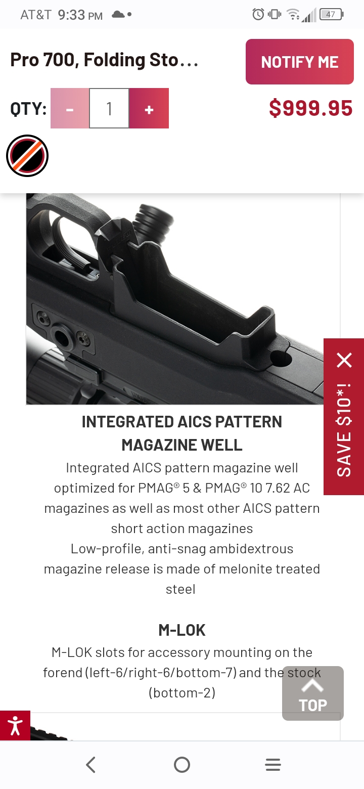

Im really looking for more comparisons of this vs the Magpul 700 pro, based on the pricepoint, I'd probably recommend looking at both if you're pricepoint shopping as well.
I will agree with that and the magpul is a folder, but it lacks 2 things that makes me choose the aero
1. no integrated arca rail
2. not compatible with AW mags
I'm getting the ARC CDG action and have 3 AW mags for that

How is the Magpul not compatible with AW mags?
AW and AICS mags use the same magazine well or bottom metal pattern.
The differences will be in whether or not the action is cut to accept AW mags (they have to sit higher in relation to the bolt and so require a relief cut on the bottom of a 700 footprint action, something unrelated to the chassis), and sometimes in whether or not the chassis/dbm mag catch allows the magazine to be placed high enough. This is why some manufacturers now offer extended or adjustable mag catches.
If that magazine well will accept an AICS 5rd, it will absolutely take an AW mag. I could see how the mag catch might not position an AW mag high enough to work with some actions, but I can’t see how a guy would know unless he or someone else had actually tried it with a specific action.

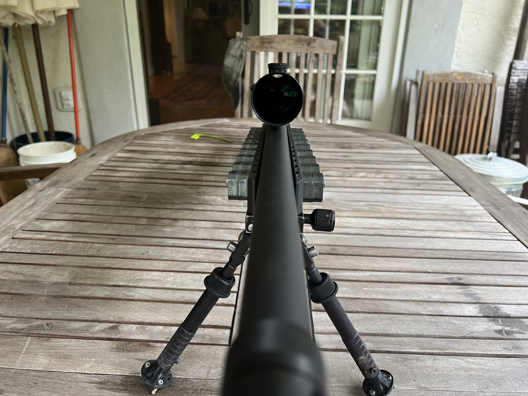

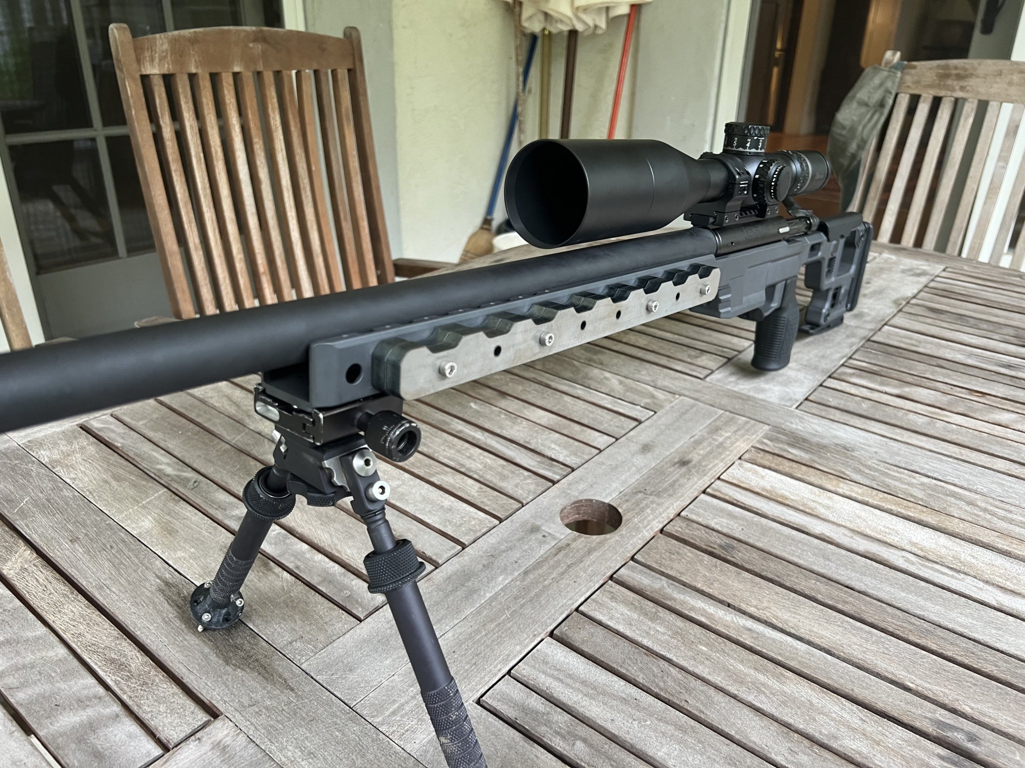

Has anyone found an external weight that doesn't interfere with sliding a CKYEPOD or other ARCA bipod around?
