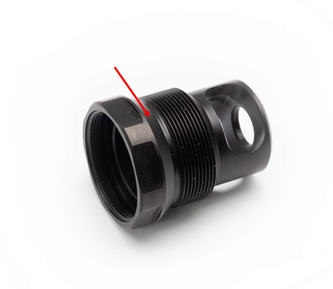

    Hello my friend - so first, let's agreer on terminology. The bit that screws on the end of the barrel is the Area 419 universal ADAPTER. The bit that screws into the back of your TBAC Ultra 9 CB suppressor is Hellfire Suppressor Mount.
    If I remember correctly, you had a small bead of thread locker (and yes, I'm sorry to say you def have a thread locker abuse problem but we are planning for an intervention soon! haha) that got seemed to be on the tapered bit below the threads...and I generally understand that this taper is intended to align things up properly...or did I make that up? In any case, thread locker was kind of here, right?
    This left us with the impression that the thread locker interfered with getting the suppressor screwed on straight down to the sort of "shoulder", if you will, of adapter where the suppressor rests. Right so far?

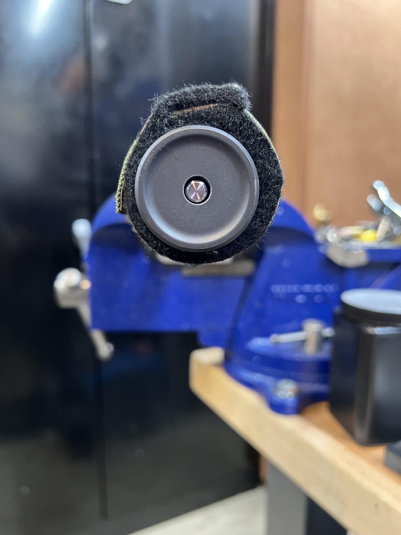

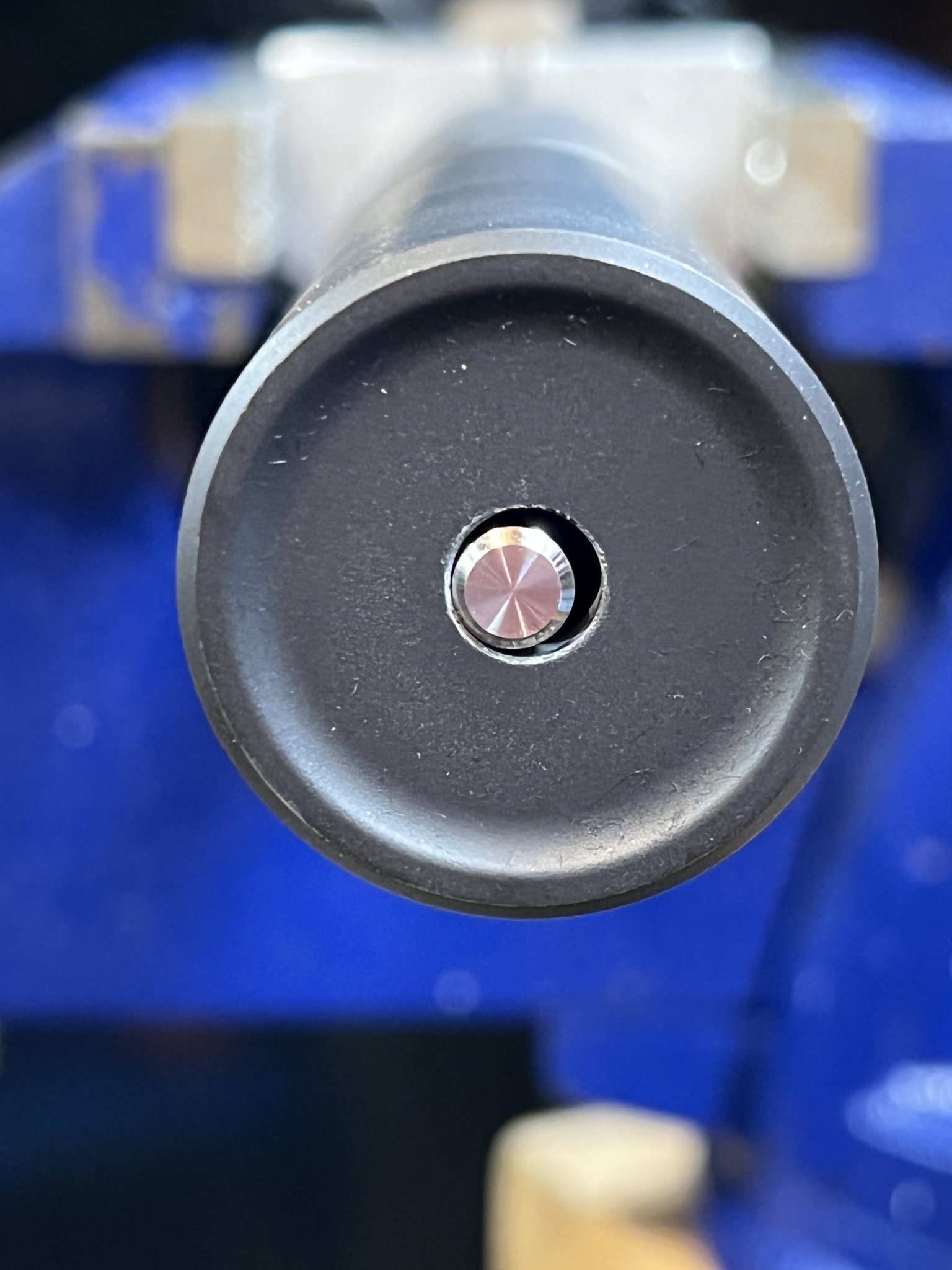

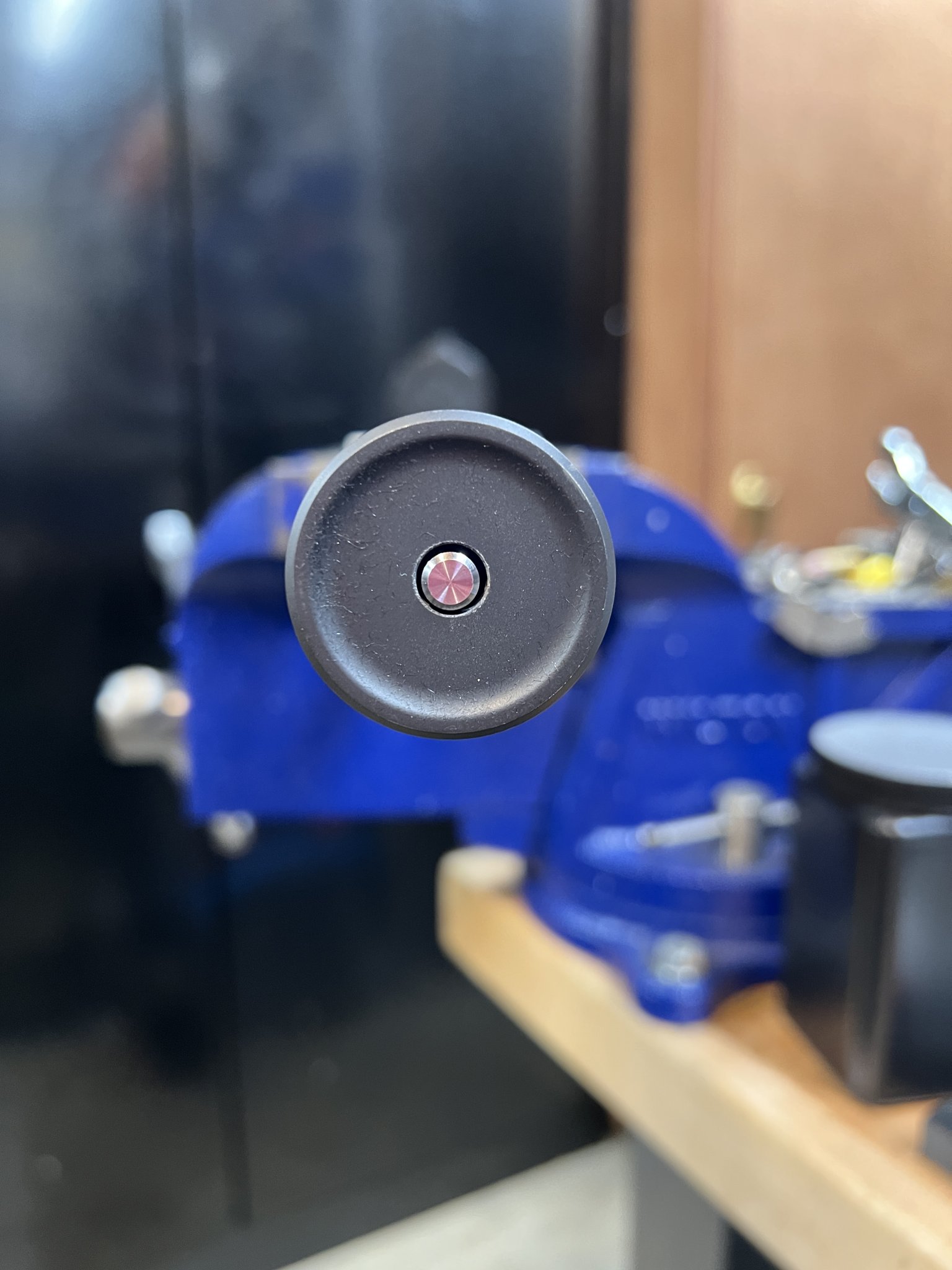

    So the mystery continues…
    Pictures!
    TBAC adapter w/ washers:
    TBAC WITHOUT WASHERS:
    Area 419 adapter:
    Area 419 Mount / Ultra9:
    TBAC CB Brake Installed:
    There’s a little bit of flex or play in the rod when it’s at length… But it’s not that significant.
    I can’t tell if the meeting surface for the barrel threads is an off a little bit… But it is no issue when I use no washers with the TBAC CB Brake; its dead center.
    When I use washers to time the TBAC Brake, you get what I see in the first picture.
    The Area 419 adapter is dead center, but with the mount and the suppressor installed, I get the rod barely touching right side of the end cap.

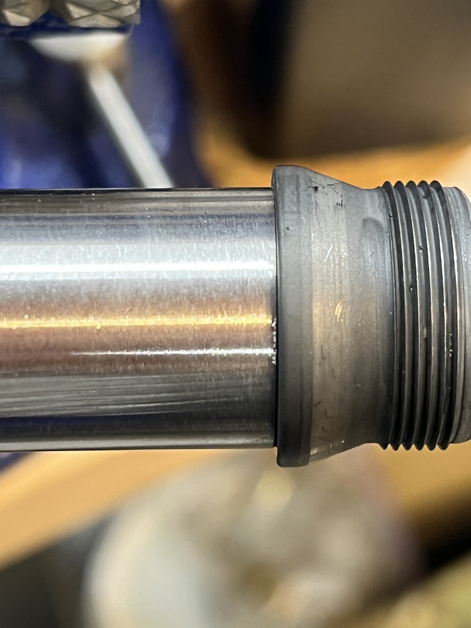

    The picture of the CB Brake shows that its installed directly to the barrel, and there sees to be a hair gap on the left side.
    SO! If I had to guess, PVA somehow didn’t cut the crown straight?

    Wow, yeah...that one side on pic of the CB adapter showing a bit of a gap is startling.

    There appears to be a ding mark at the shoulder in one of those photos which concerns me.

    FWIW: The ding is actually rash on the outside of the barrel and does not carry over to the matting surface at all.
    The was one of the first things I checked. You can't even feel that "rash" with your finger nail...
    What IS interesting is that the tread protector made at the same time appears to mate perfectly. That leads me to believe that the two were cut at the same time... using the same equipment.
    I believe regardless of machinery that the shoulder and the threads of the barrel would have been cut in the same operation on a machine, which means they must be perpendicular to each other when they came off the machine. Is it possible that when you installed one of the muzzle devices that there could have been something underneath the device that wasn’t level, that as you torqued the device down it bent the threaded portion relative to the shoulder? Or was the barrel dropped at some point with or without the thread protector or a muzzle device? This doesn’t look like something that would happen during machining to me.
