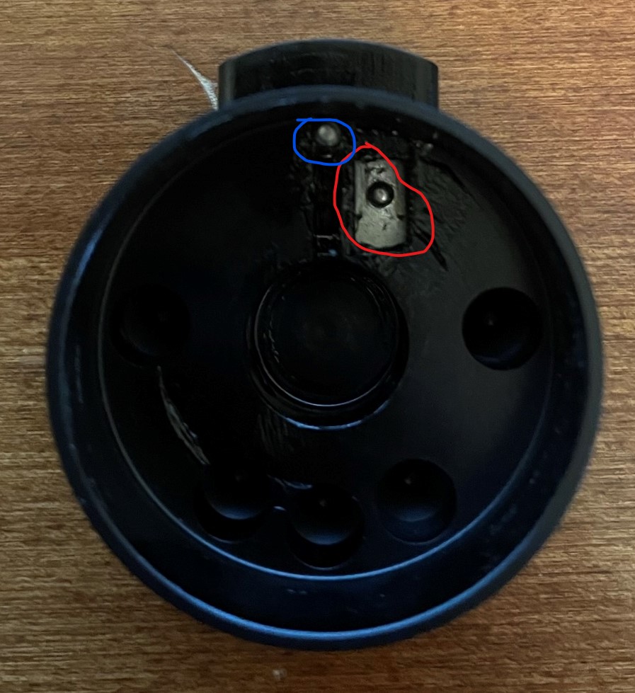

Since my new turret was coming in, I decided to start playing with the current turret that stopped dead at 20 mils.
Issue is pretty simple. The pin circled in blue travels around the spiral on the inside of the turret.
As it reaches the third revolution, the large black turret button passes over the silver button circled in red. That silver button is part of the third rev indicator.
What happened on mine is the metal rectangular piece that button is part of was frozen in the down position, which prevented the blue pin from continuing any further in the spiral.
That was remedied by pushing up on that red circled plate carefully but firmly with a punch. It still sticks a little, but I can access the third rev now. I bet with some regular use it will free up completely.
