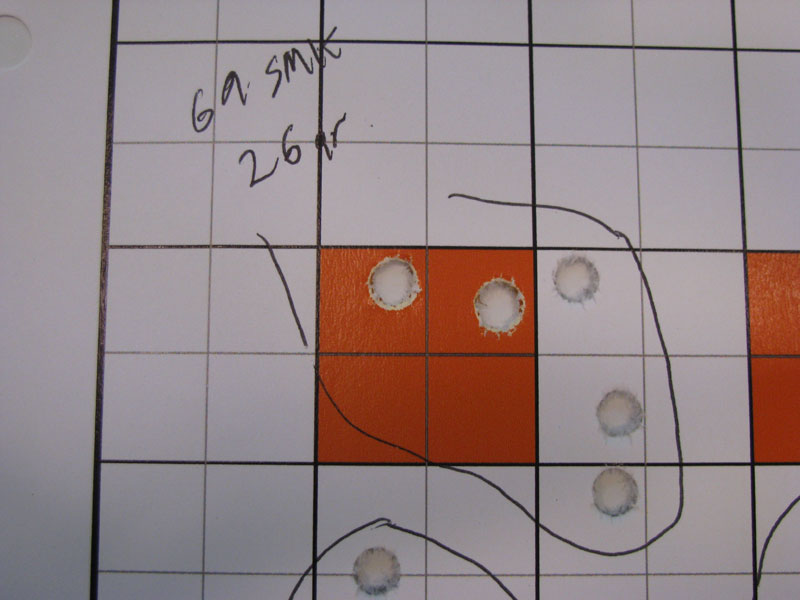

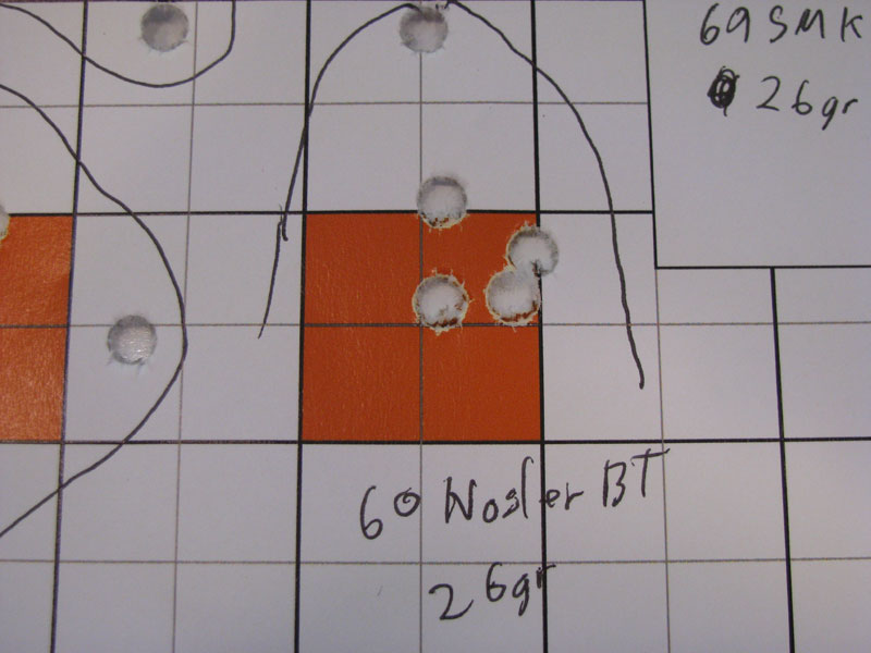

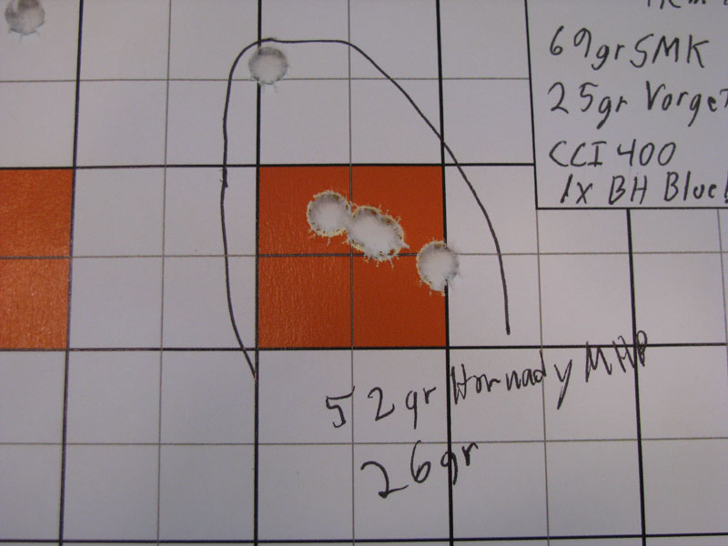

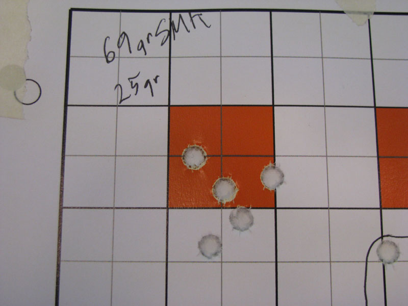

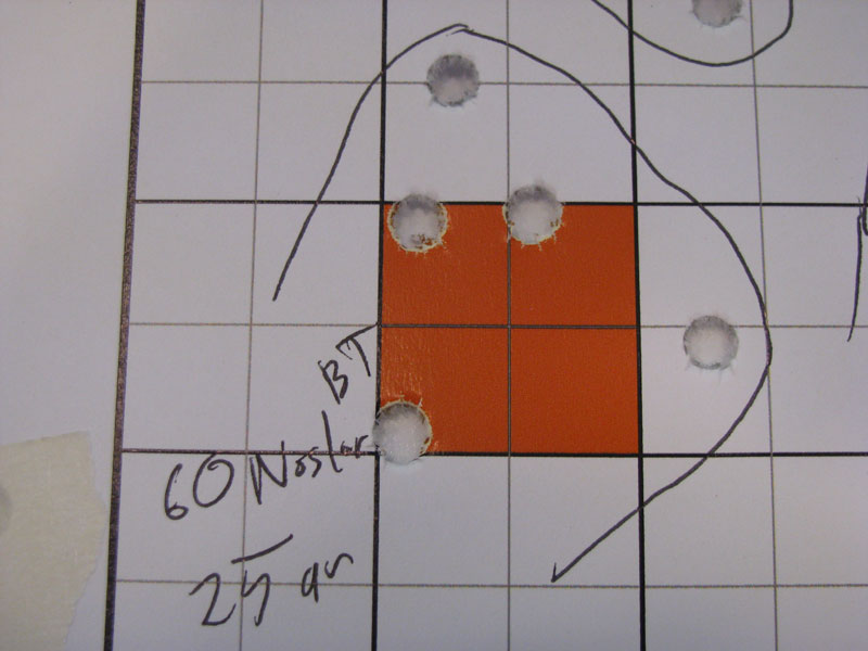

    I wont even bother listing the chrono data for the .223... since I can't get enough varget into these little cases to get things going fast enough. Here are some groups for the hell of it.
    group 1
    group 2
    group 3
    group 4
    group 5

    Well I went back to the range with the chrono again today.
    Shot 8 more five shot groups. I tried setting the 168's out farther with a 2.250 to ogive instead of 2.190. They reacted badly.
    Out of all the groups, there is no doubt that 42gr shoots better than anything else I've found thus far with both 175SMK and 168SMK. The only down side is that I'm averaging 2480fps with the 42gr varget load. Its what the gun likes apparently. Veeeeery slow. I was really hoping to be above 2600... and even closer to 2700 if possible. Doesn't look like I'm going to get the job done with this setup. I'll probably be around 2450fps with the suppressor on.
    Quite the learning experience.
