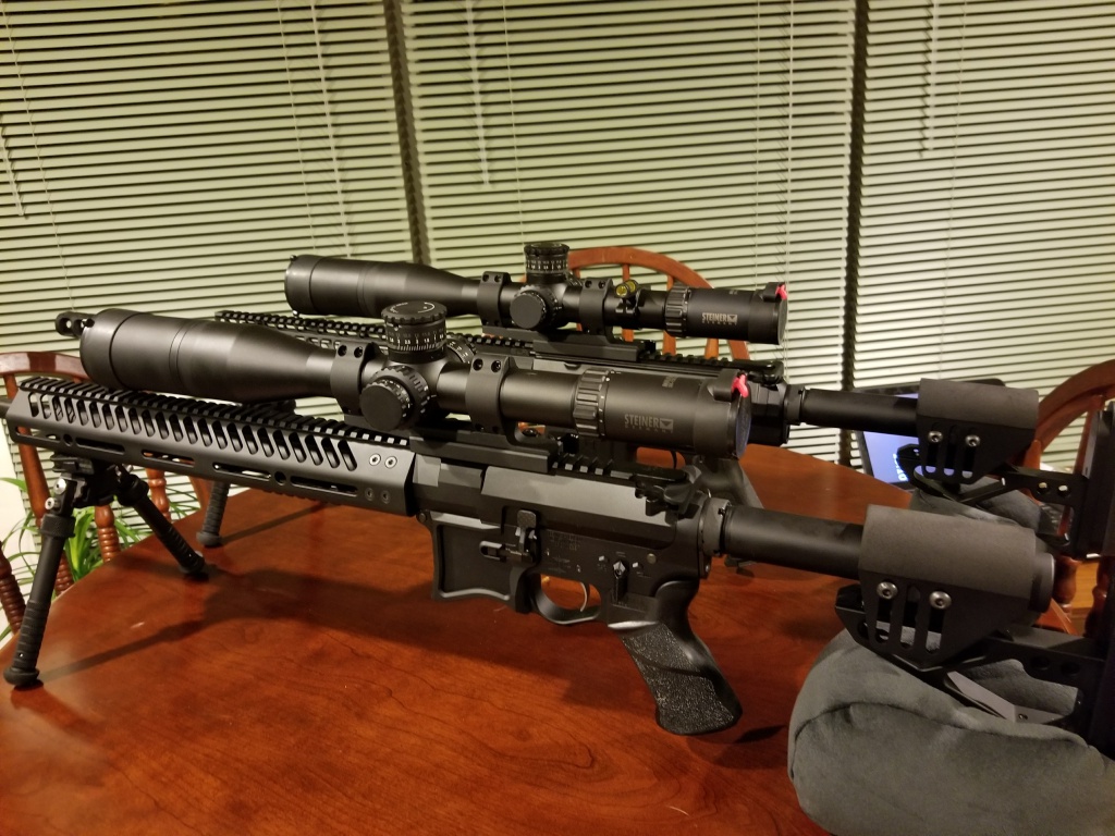

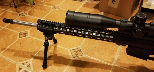

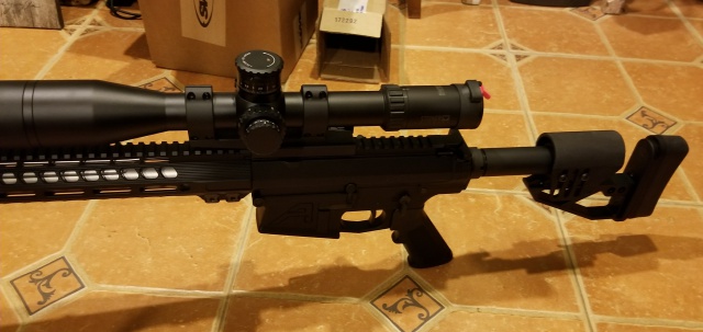

    Here it is assembled. The grip will change as will the trigger. The A-Peg is decent and I planned on trying one on this, but the A-Peg for AR10's does not fit on Aero receivers. I used an MBT trigger I had laying around. I didn't like them in these types of rifles. I'll probably go with another AR Gold or Triggertech. I just figured I'd do some more research and maybe try something different. I like the info on the Wilson triggers and may go with one of them.
    It joins my others. You can see what I mean by they are all almost the same. I'm boring and try to stay consistent.

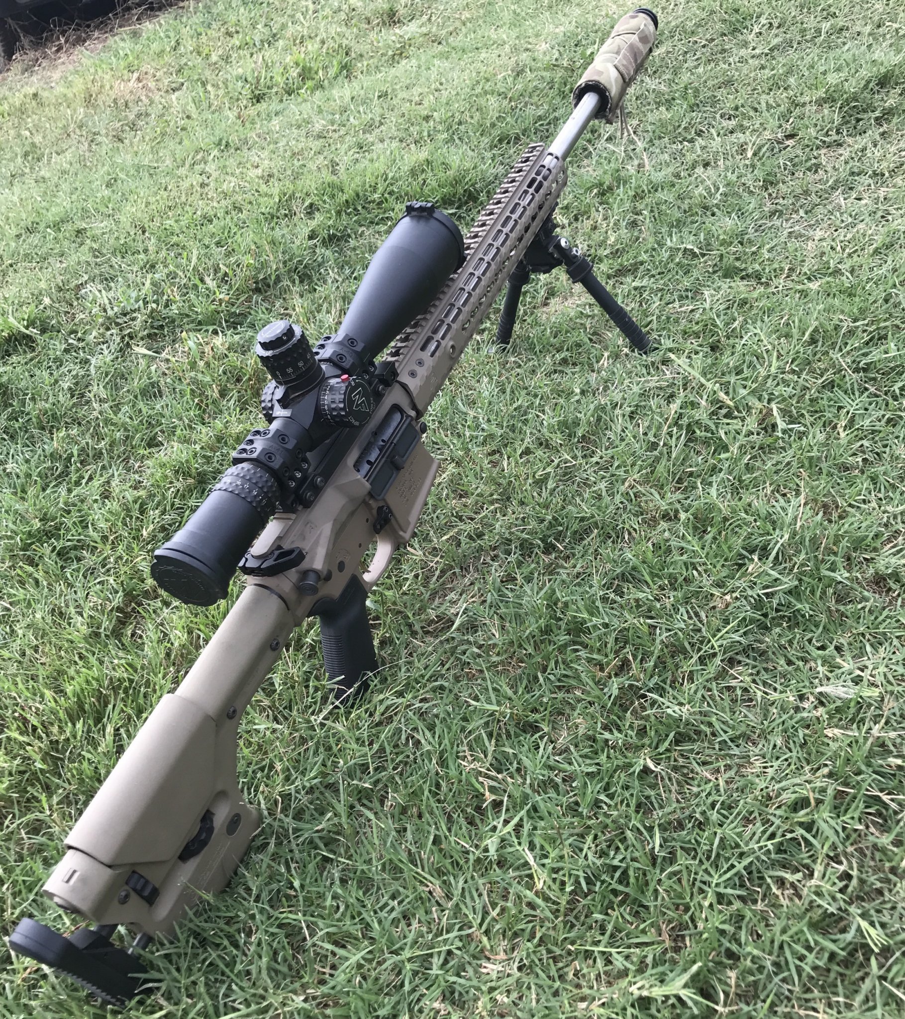

    I’m running a 22” jp 6 creedmoor in a aero Precision set with jp vmos bcg and how silent captured spring setup thing is a hammer love it.
    Nice setup you have there. Very nice. I originally had PRS stocks on all mine. They worked good. I then bought one XLR for this new build. I made a mistake and installed it on my 6.5 Creedmoor. I was hooked. In tuning my 6.5 I switched to the silent capture spring and really liked it.
