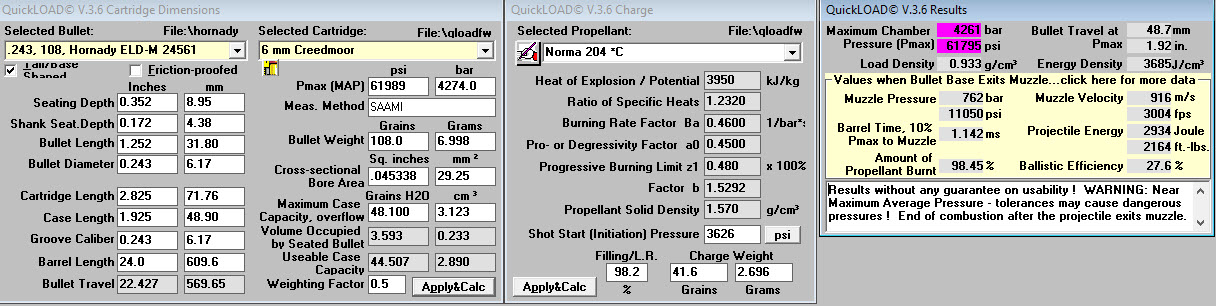

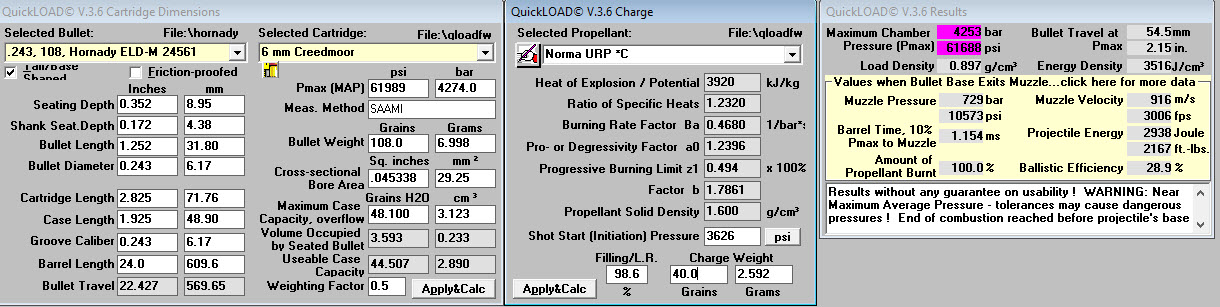

Hello could someone with quick load please run this for me? I would greatly apricate it.
6mm creedmoor
Nosler brass 48.1 grains H20 capacity
108 Hornady ELD M bullet
Fed 210m primer
the powders I would like to see numbers on are norma 204 and Norma URP
the COAL is 2.825
Thanks for any help on this . I want to see some rough load numbers and velocity and pressure before I purchase 204 I have some URP on hand to try.
You didn't mention barrel length so I ran it with a 24" barrel. Those powder charges are MAX.

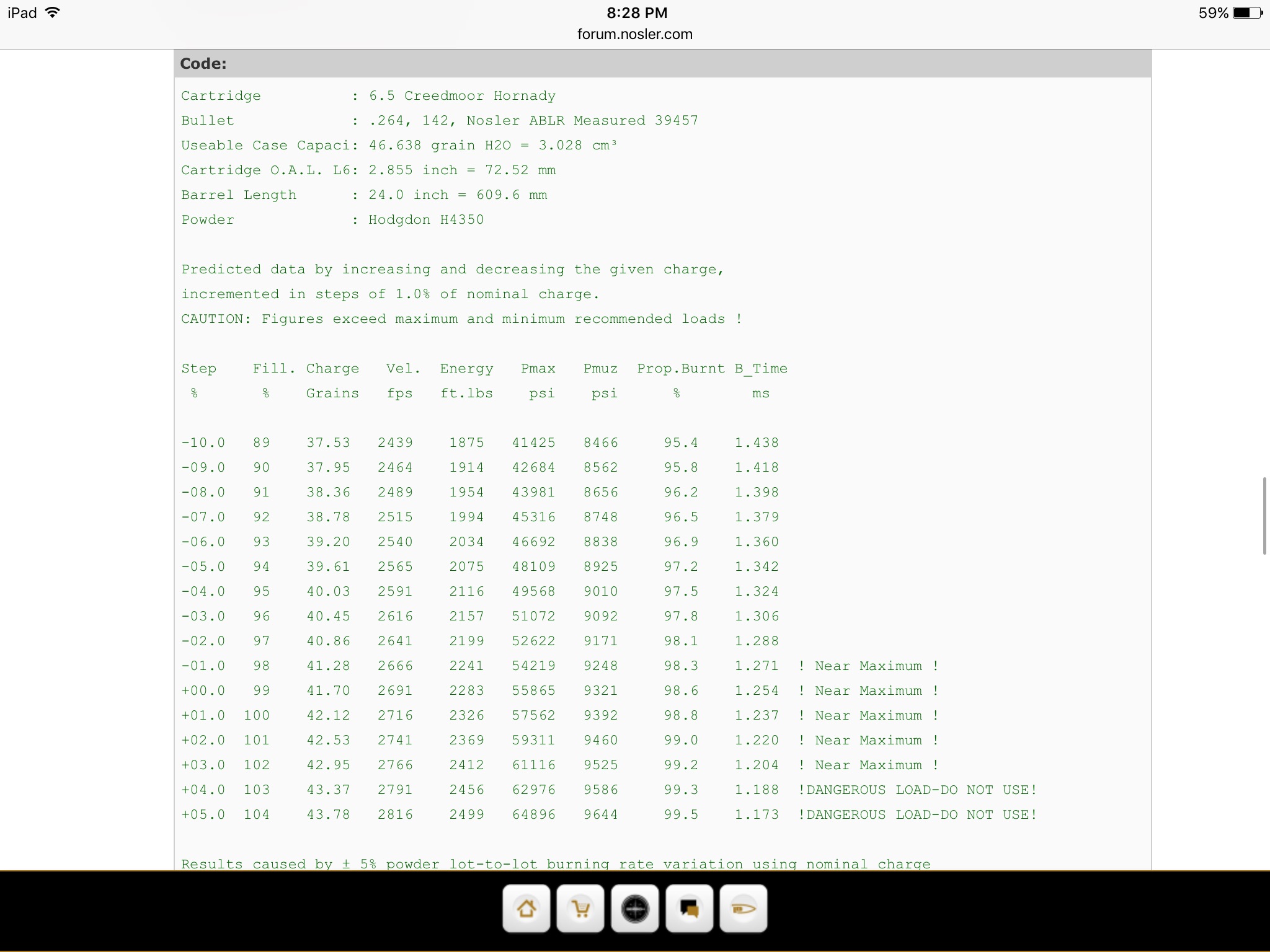

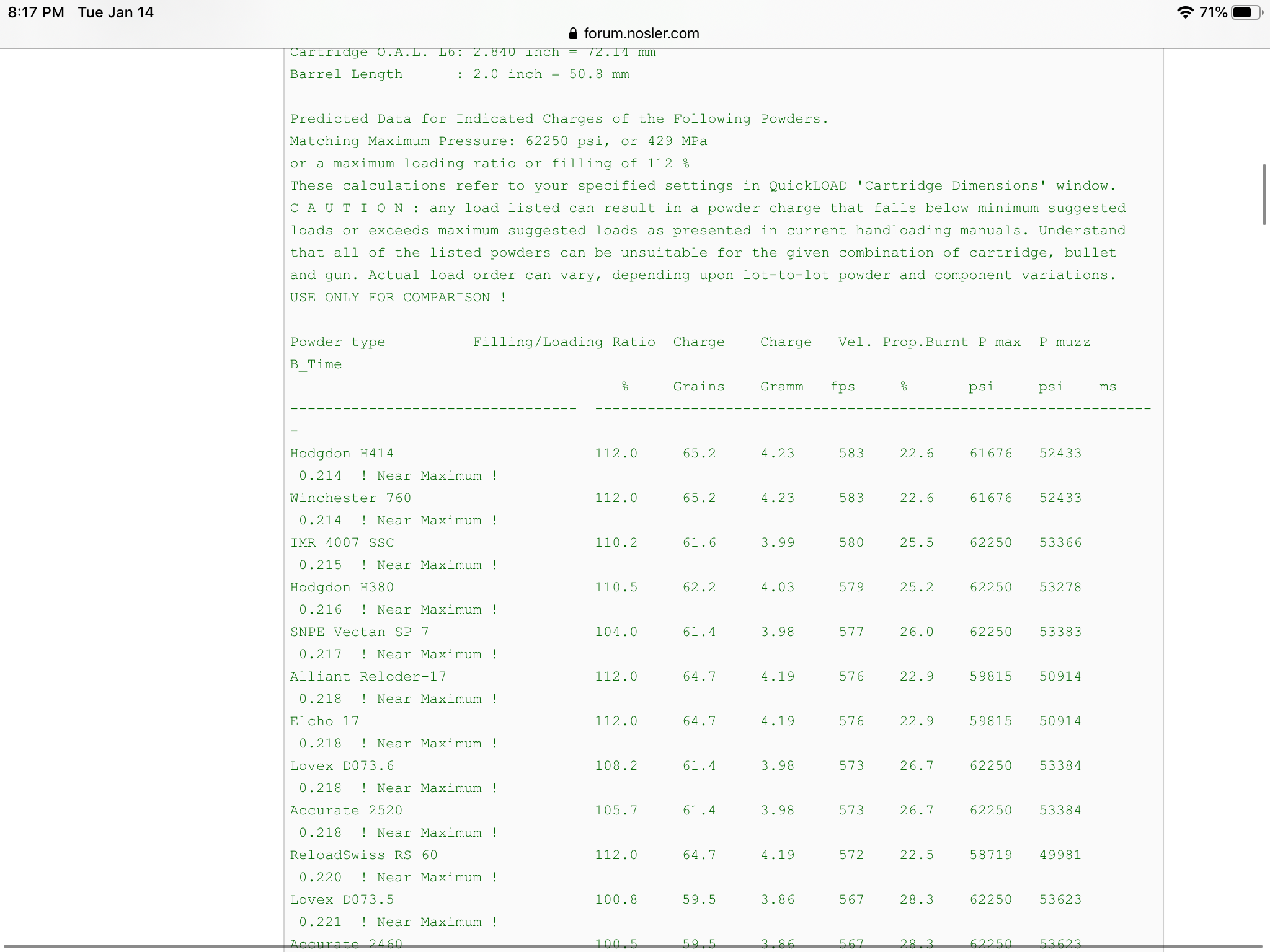

Is there anyone that can translate the Quick load data I asked for in this format for me? Thanks once again.
this format is super helpful .
That would be great if you could use the data I posted and get this data lay out for me! Thank you!
i do not need loaded ammo, I can do the loading just looking for the table layout like above just a nice and handy way of comparing and in many instances very close with my chronograph as the table lays it all out. Thank you.
