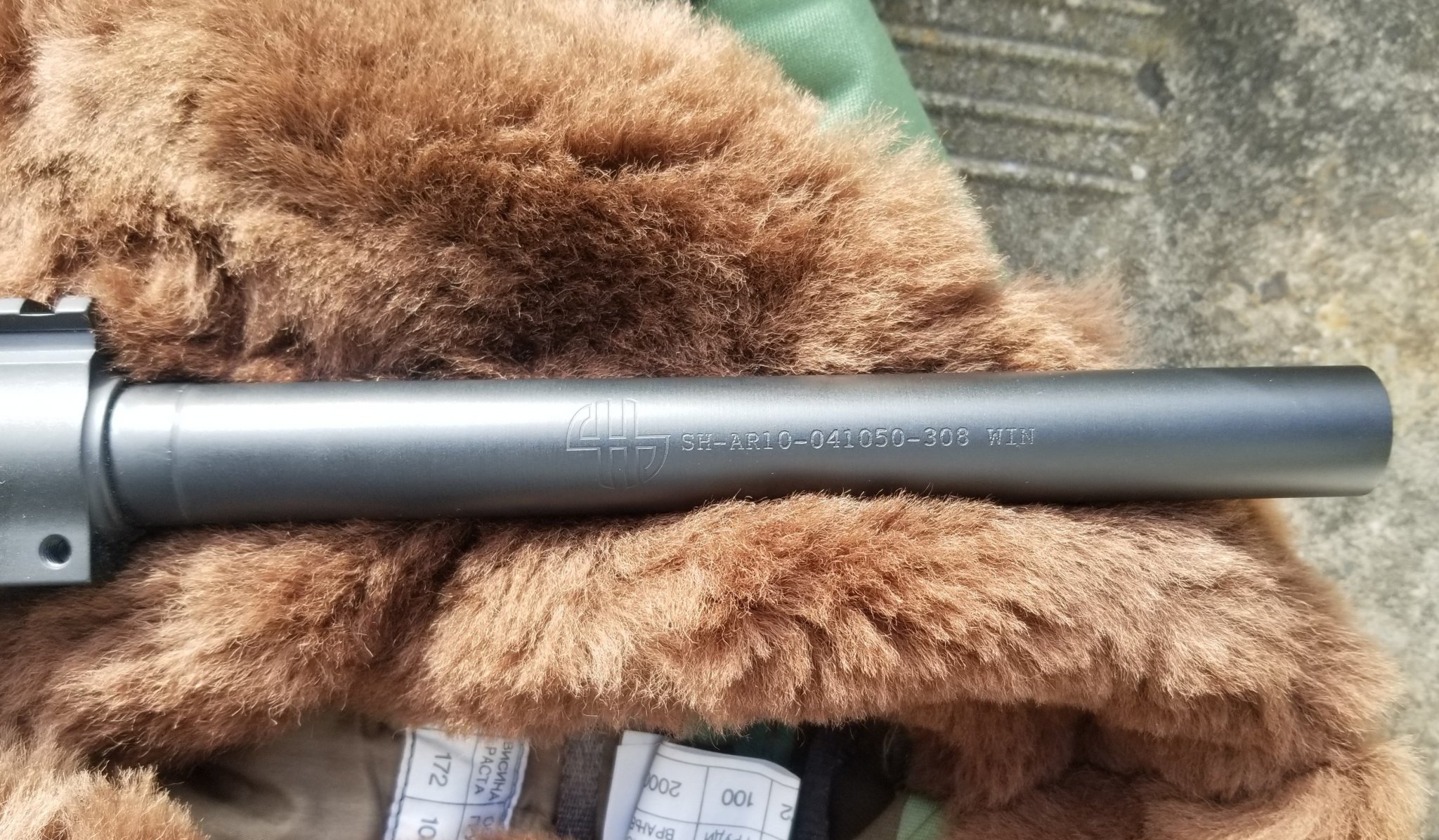

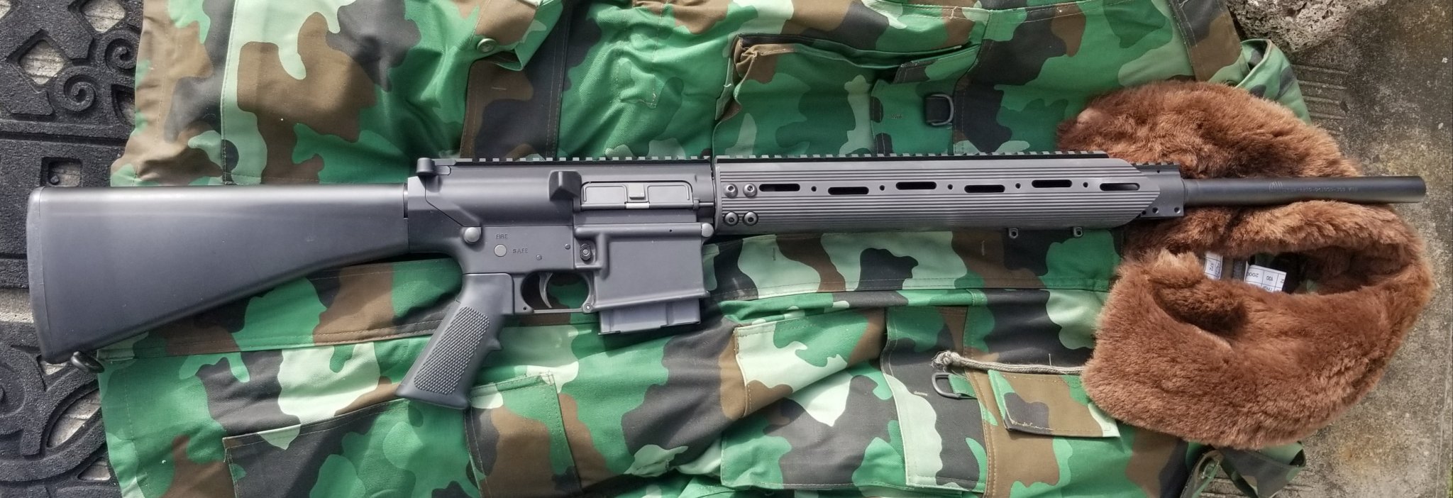

So my brother drops off a few rifles for me to help him sell, take pics, list etc. Well one was this AR10 I ordered new from GAP on a SH group buy back in day. Life happened and I needed some quick cash and my brother gladly stepped in and took this off my hands before I even had a chance to mount a scope on it. I tought he said years ago that he had sold it so I never asked about. Well needless to say its not for sale now. This will be a great rifle to have out on the ranch in Idaho where there is no shortage of places to do some serious long range shooting.
I've searched for old threads on these but they kind of blend together with GAP's in house AR10. Any of you guys who have one of these old Armalite versions have any recommendations for ammo, mags, scope and rings? Might eventually look into replacing the rear stock so any suggestions on that will be appreciated as well. So psyched to have this beauty back in the stable. Thanks guys, Bill

I’ve got a Luth AR MBA3 on my Valkyrie and my large frame. I absolutely love that stock. It’s literally the most comfortable stock I have ever used. Took a little time to get it where I want it and I ended up adding 3” to the LOP but I’ve got a long neck and long arms. Either way when I don’t shoot one of those guns for a while i forget how nice it is and it always feels like home when I get back on it.

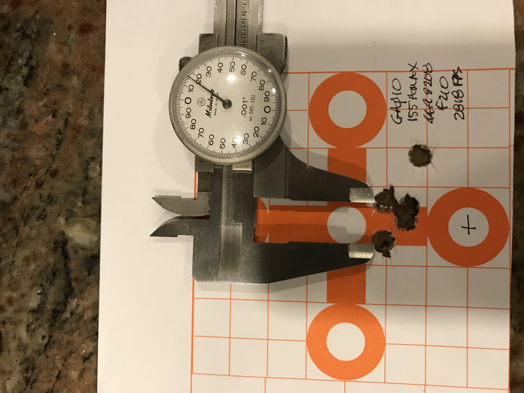

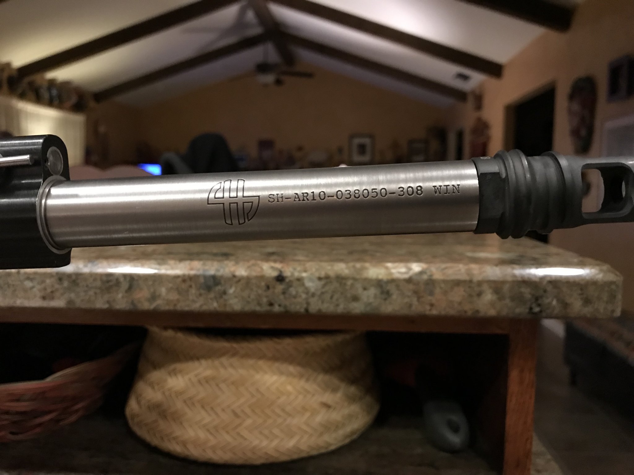

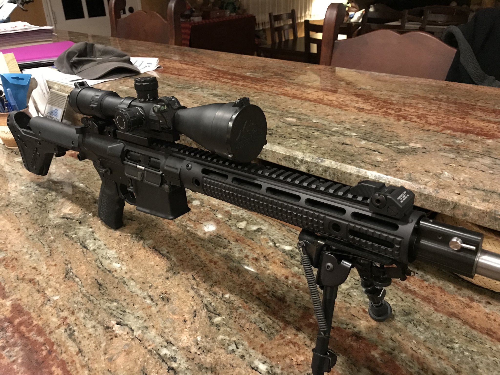

Picked this one up 4-5 years ago from another member here, and forever grateful I did. Group shown first five shot a couple week’s ago-after ‘resting’ in the safe for a year or so. Cold bore on right-last 4 a bit over a 1/2”. Does this with regularity with almost all 155gr from Lapua, Sierra or Hornady over 8208. 2818fps last clocked.
The original hand guard was sold for its current configuration. UBR with Slash Heavy Buffer, original switch block, Geissele NM trigger, Bobro mount for Weaver 3-15 EMDR. Doesn’t get shot as often as it should, but is, as you would expect from an Eric Reid build and a Schneider 11.25 twist barrel, exceptionally reliable and accurate. Shot most often with a 7” Mack Bros suppressor. A keeper, for certain.496F3488-6F06-4EB2-A0E2-F9DDA3C7DA61.jpegE232664E-B78E-413C-85A5-209C765AE7E4.jpeg1CAF81BA-3EE4-4C11-B041-198DE2446758.jpegB697AA68-2581-4BDA-A4F0-6B6760CECB09.jpeg
